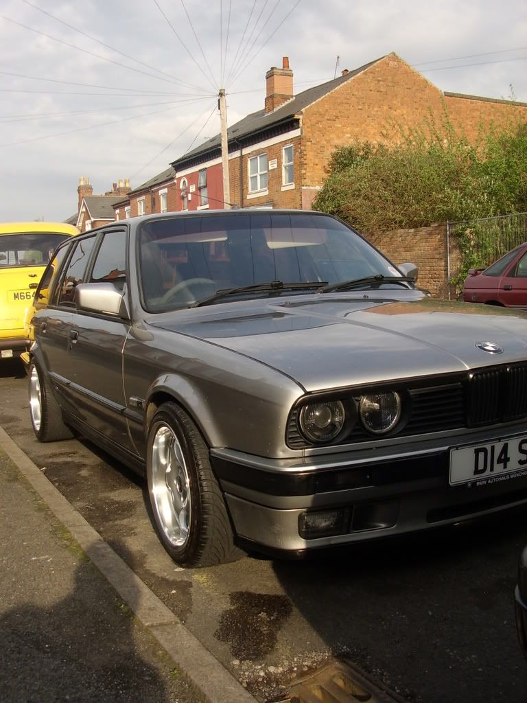

Jhonno wrote:
aceraf wrote:215/40/R16 on my 9J Borbets :thumb:
any pics of how stretched they are at all? :)
Only one's i could find that may show it...
Not too much of a stretch.
Breaking 325i Touring
papercutout
Posts: 404
Joined: Fri Oct 12, 2007 11:00 pm
Location: Near Oxford, UK.
Mon Jun 02, 2008 1:53 am
I'd say you'll be fine with 215's, not much stretch at all, going by the photo's above and general knowledge. Biggest stretch i can recall seeing is 185 on a 10J. Now that is stretch! I'd drop down to a 205 on 9J before I started worrying, and while you might not care for my opinion, see above photo's for lack of silly stretch and general opinion.
