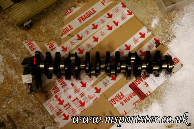

- I don't understand how to identify the M52 crank by measuring from one main bearing center line to another (or something). I'm aware that I'm looking for 84mm. Jazzman, I know you told me to do this but I'm unsure of where to measure from and to exactly.

Evening all... any ideas on that measurement that I asked about at the beginning of this thread on the crank? I'm pretty sure what I have is an M52 b28, but I just wanna be sure.

This how you do it:

JazzMan, thanks for that. Of course that makes sense as its the throw you are measuring, hence the measurment should be longer than the M20 crank blah blah.... cheers mate. Lesson learnt!

Or just look for 84 (stroke) cast into one of the crank webs. Those look like early 9.75:1 CR pistons with the longer skirts - they will probably need machining down 12mm.
