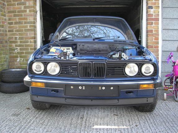

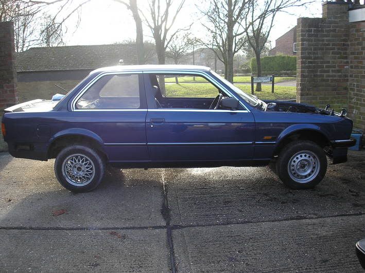

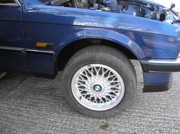

some new wheels

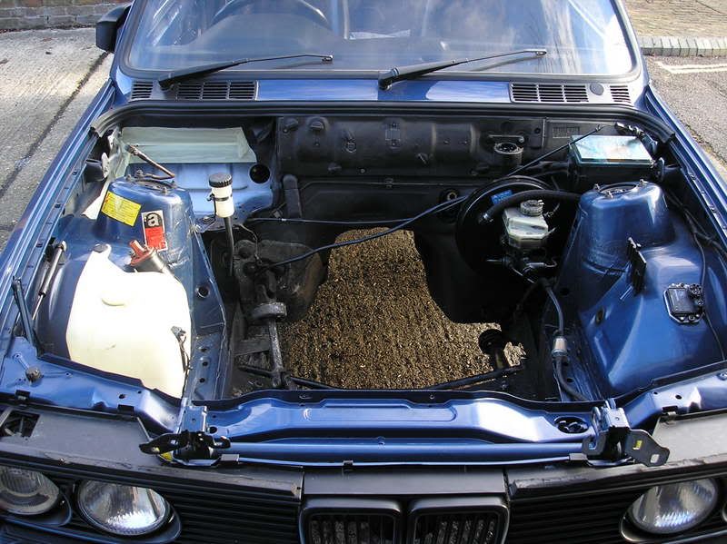

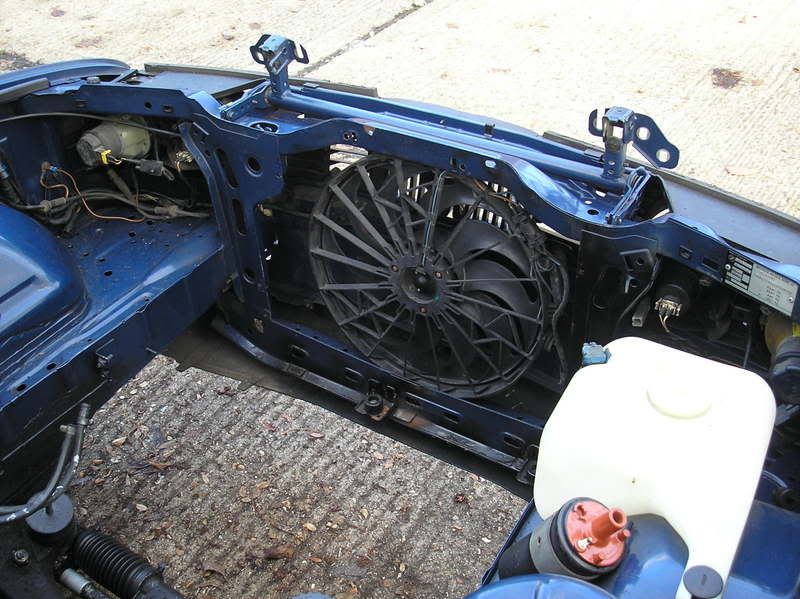

front end painted,chrome sorted and smilies fitted

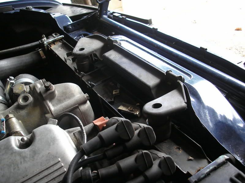

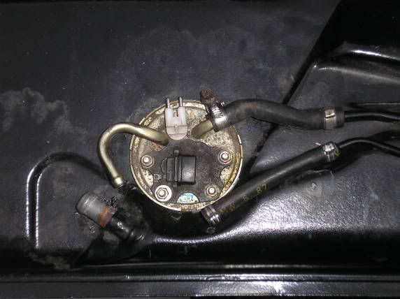

fuel pump fitted and extra pipe plumbed in ( car was a 316 carb so no electric pump)

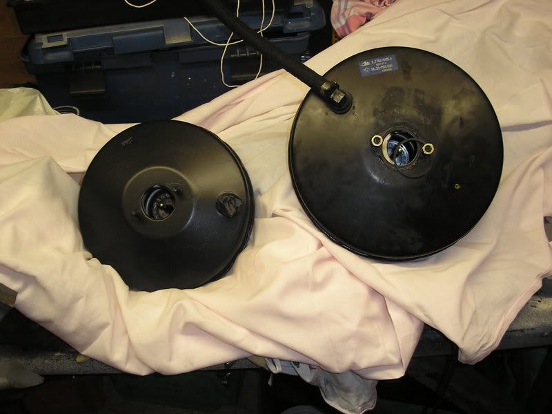

golf servo

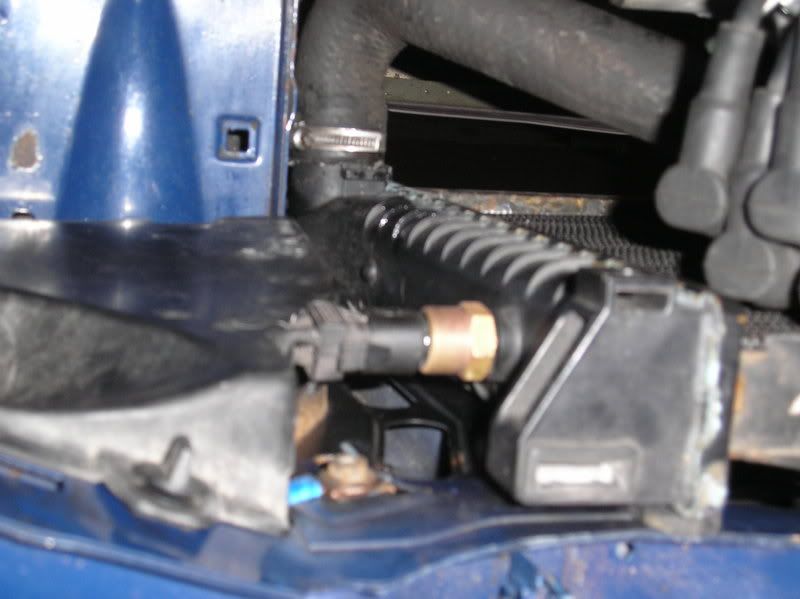

E32 aircon fan

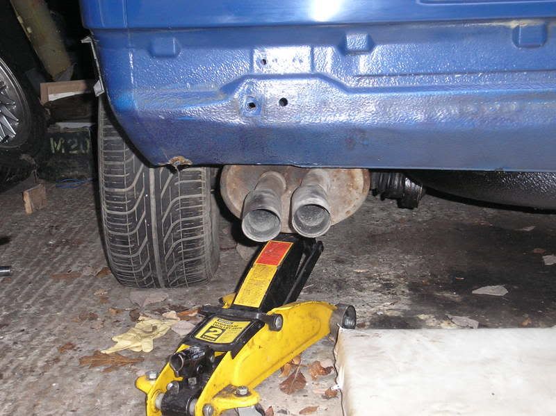

Audi A6 2.8 back box

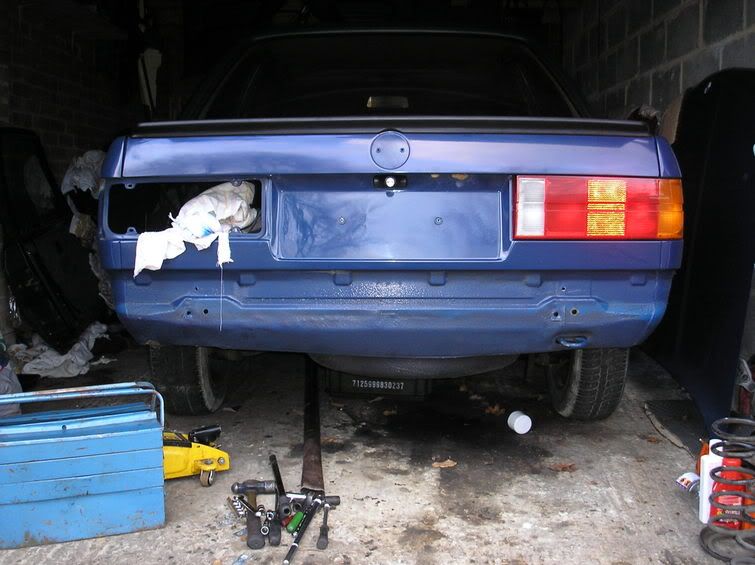

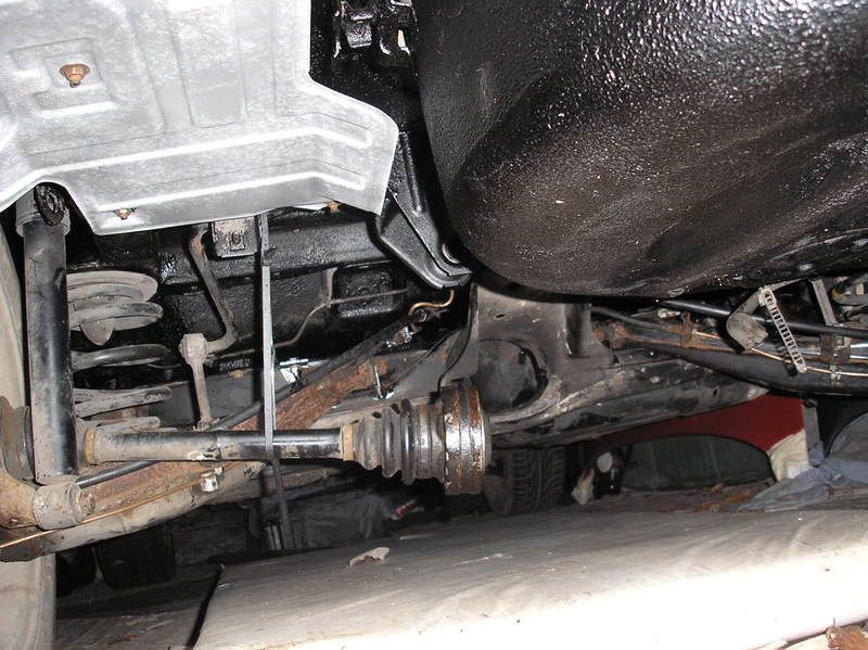

rear disc conversion, rear arb and some underseal sorts out the back underneath, oh yeah and new brake lines

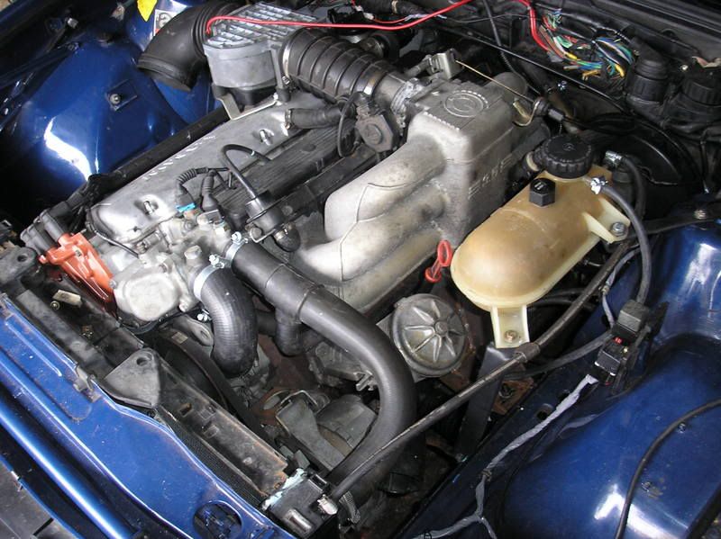

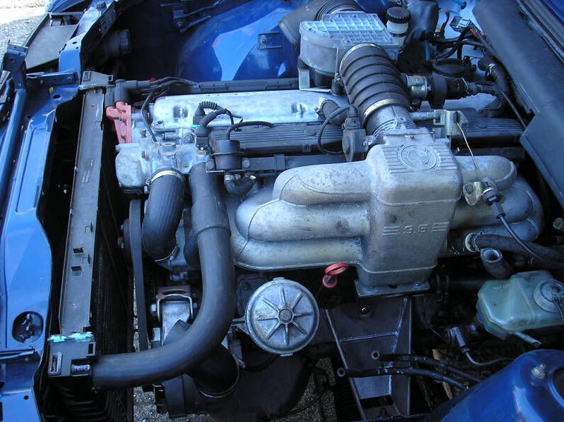

Patiently waiting for its lump
engine and rad finally in and the end is in sight

front end on larger diameter struts mtech springs and thicker ARB,rear end still on standard shocks and springs, for the moment.
