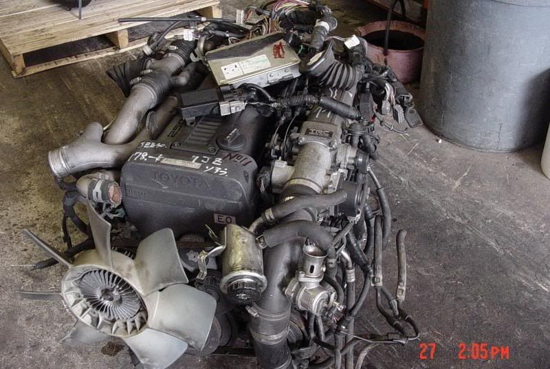

supra into e30
dazleeds
old skool raver
old skool raver
Posts: 12883
Location: Empire Building @
Post Mon Nov 27, 2006 6:29 pm
yeah ya heard me winkeye
so has anyone ever seen it done??
i know the aussie lads love these and chuck em in anything with wheels :twisted:
so looking for any info/links/help what ya got for me???
also alternatives will be considered but i really like the look of the 7mgte turbo lump from the mk3 supras
plus they are very cheap to pick up a donor
cheers all

Post Tue Nov 28, 2006 9:15 pm
this is the engine from the supra wedge turd yes?
if so then isnt this an unreliable shitter of an engine, and doesnt give much power. hence the reason mk3 supras are worth about £3.50. oh and they also look terrible, and naff...hence the reason they are worth £3.50.
the mk4 was classed as a cheap supercar in its day. the engine is also much more tunable. 400bhp+ is easy i guess. and obviously you can get 1000bhp+ bhp with enough £Â£Ã‚£.
sounds like alot of work daz. steer clear dude.
get an m30 in there or something.
Post Tue Nov 28, 2006 9:30 pm
Jon, they get the heavy shitter supra to 60 in the 6 sec bracket and that is in standard trim with 2 cats strangling it.
They have a reputation for headgaskets but once done and torqued down properly, they are strong.

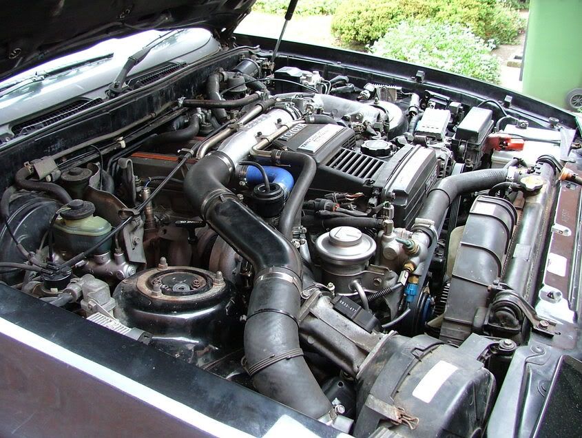

But Daz if you realy want to go for something to kick a 3.5 or 2.7 up the ass, then drop one of these in the engine bay. I would give you 2 days and you would be :banned: :snigger:
hhmm.
ok, what about the wiring, custom propshaft, engine mounts, gearbox mounts, custom rad, etc etc....
sounds like alot of fun. and i dont think it could be done on a weekend.

The 7M-GTE engine from the UK MK3 Surpa Turbo is the weapon of choice due to availability and they cost buttons. Personally I would look to retain the engine & box, but as JonB said, you are still gonna be messing with the prop. 3.91 diff is the correct ratio, so E30 one perhaps to be retained, but would be interesting to see if the supra one would fit as it is evidently stronger and is LSD as standard.
The 1jz engine mentioned is the 2.5 twin-turbo unit, as per the pic posted by Vinni. These are only found in TT Soarers and also the Jap import MK3 Supra, so they are nowhere near as common, so cost more. A bare engine with no tubs or loom would cost you £375. These are 280bhp out of the box and the right side of 300 once you junk the cats.
The 2jz out of the MK4 supra costs megabucks to buy.
The skyline lumps are OK, but cost much more to get the power gains from compared to the toyota lumps and are not as reliable.
