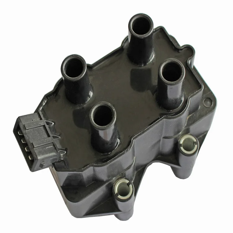

Also went wasted spark as per Gunnis post in another thread with this coil pack
http://cgi.ebay.co.uk/Vauxhall-ASTRA-OM ... ms=65%3A12
Correct me if I'm wrong, top 2 banks closest to the plug are cylinders 1 + 3 and bottom banks are 2 + 4
