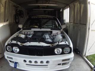

well looking at mine even though iv moved it back to the max, i recon you could fit a MK1 golf booster in there maybe with some shoe horning?
doesn't seem right on the ok for the engine conversions but not upgrading the brakes though?

1 sec i dig you out a picture of mine

Hmm, I can`t see brake servo on your photos?
I`m driving E30, 1989, 325i, 4 door. Restoring 1990, 4 door.
Driftben
- E30 Zone Camper
- Posts: 1144
- Location: Westgate on Sea
because i don't have one me lad, iv gone for the mans setup
its shows the space you have though

Damn, there is no space for servoDriftben wrote:because i don't have one me lad, iv gone for the mans setup![]()
