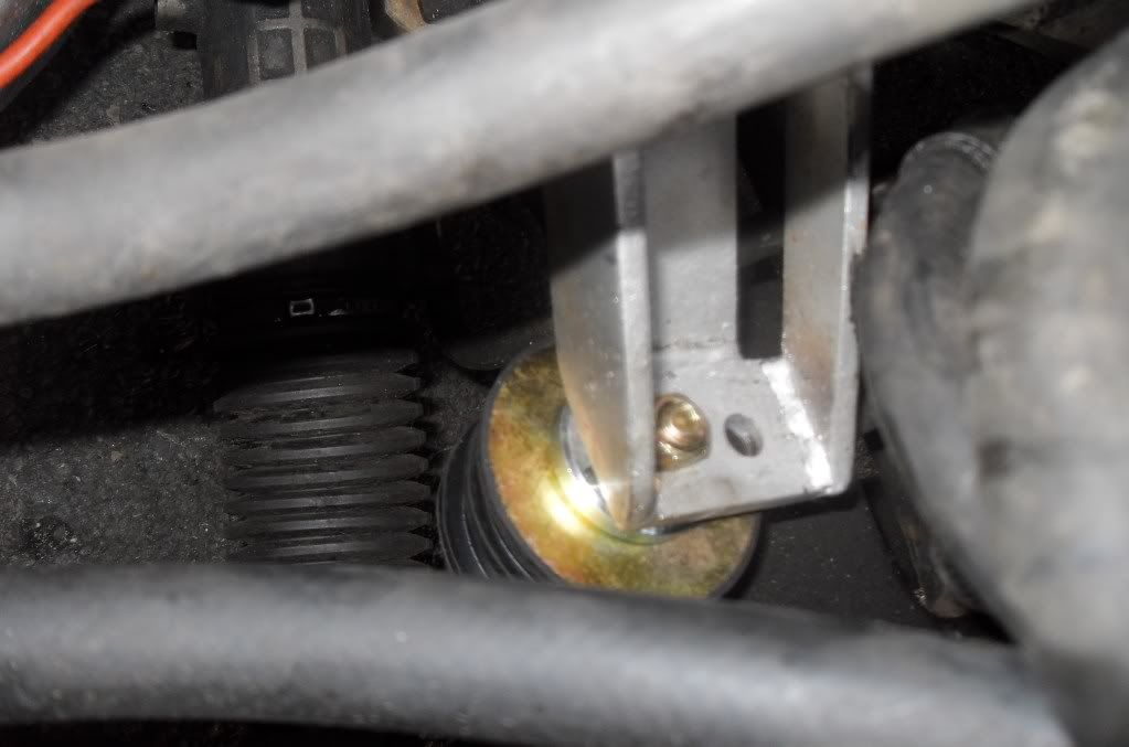

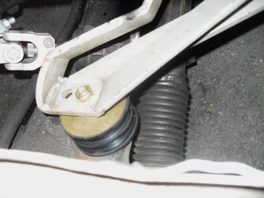

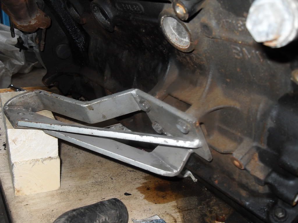

Custom mounts.
.de mounts can be used at roughly £140, & let you bolt the engine straight in. or you can get virtually the same item from me at £100 delivered.
You can have a go at making your own but you must get the engine perfect in the bay, the M30 is a big engine!
First of all it needs to be dead centre in the bay, then get it sitting at the right angle, then get it at the right height so it doesnt hit the crossmember but then you also need to make sure you can shut the bonnet, then you need to get it pushed back.
Custom mounts.
Fitted
You can use standard M20 rubber mounts with them or anything 50mm thick.
Im using Landrover V8 mounts with a spacer to get them up to 50mm, they are good and strong (cheap too) other alternatives are the uprated M20 ones from Burton motorsport.
Link?
There are 2 positions on the mounts.
I'd recommend using those that place the engine furthest back (position 3). You may have clearance issues with the bulkhead in postion 3 (some dont) if you do you can massage the bulkhead with a mallet just where the head sits,dont bash too much as the brake linkage sits behind it.
If you use the furthest forward position, you'll have virtually no room for a radiator, as well as worse weight distribution.
This is position 3

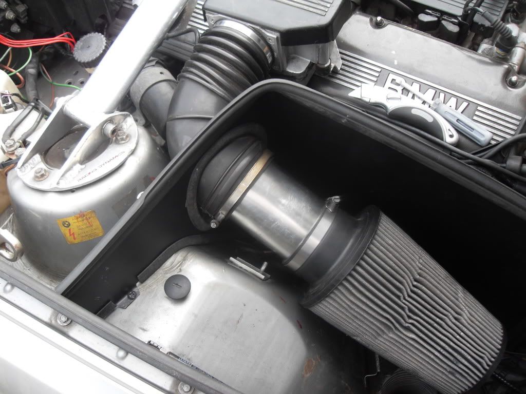

Airbox
The E32/E34 airbox fits just fine in the E30 bay. It's got a built in heat shield too - a distinct bonus as it sits above the exhaust manifold... Aftermarket options are out there and if you go down that route make sure its shielded from the heat.
To fit the standard airbox you will need to move the washer bottle. An alternative bottle can be fitted to the E30 airbox mount or the standard location - an E34 non-intensive bottle is a nice fit also a 324td washer bottle (p/n 6166 1385 280) is ideal.
Standard M30 airbox with E34 wash bottle.
After market filter with air tight heat shield and E36 washer bottle.

There are two options for a individual throttle body system. The first is to attempt to retrofit the M5 intake system. This requires at a minimum fabricating adapters from the head to the M5 intake runners. It also requires investigating the choice of fuel rail, as the M88 or S38 rail and FPR will not clear the t-stat housing on the M30. Similarly, the TPS switch will have to clear the t-stat housing. To do this the adapters have to be angled so as to point the intake runners above/below the t-stat housing and rad hose. The other option is to get the Weber DCOE adapter brackets from Redline Weber (Redline Weber part # 99004 094). The castings aren’t that great, so porting and polishing them is a must. However, 40mm or 45mm Weber fuel injection ITBs can then be bolted onto these. Again, one of the flanges near the t-stat housing has to be shaved a bit to clear, and I have not verified if the TPS switch will clear the t-stat housing and rad hose, but this looks to be more a ”˜bolt-in’ solution. Additionally you’ll need a custom intake plenum. http://www.jameng.com and http://www.twminduction.com are both good sources for the ITB components, as well as Top End Performance can order anything from Redline Weber.
Fuel system and engine management: Use either custom engine management (Megasquirt, etc.) or Motronic 1.3 out of the late '88 and '89 E24, along with the engine harness. Update the ECU to #179 (#150 is Motronic 1.1). This is because the Motronic unit will then mount in the same place as the one currently in the car, and Motronic 1.3 is adaptive enough to run this motor well. It is necessary to retard the timing a bit as the 1.3 was set by BMW with 9:1 compression, although this seems to be an issue (pinging that is) at lower rpm, high load conditions, for engines with ~9.8:1 compression or higher. I would then suggest a dyno day and a custom burnt chip. As for fuel system, I suggest running Mustang 24 lbs/hr injectors at minimum at 3.0 bar, but depending on your fuel requirements you may need to up that to 27 or 30 lb/hr. The Bosch Motronic 1.3 in limp-home (open loop) mode with the 179 ECU and 24 lb-hr injectors runs my (Chris’s) engine around 11.8-13.0:1 AFR, or very rich. Idle is right around 14-14.5:1, and off-idle there is no hesitation. And the 3000 - 3500 rpm range is butter smooth. Cam seems to ”˜come on’ around 3700 rpm, although after 100 miles of break in I’ve not yet gotten past 4000 rpm, nor gotten past a throttle.
I would also suggest using a big bore throttle body because you will need as much air as possible. On this note, a Mass Air Flow Sensor conversion is in order as it will give the engine management more precise readings and also will be less of a restriction, in theory. There are and have been a number of options for MAF conversions for Motronic systems. However, it is important to note that a MAF will not in and of itself improve outright power, given similar flow conditions at wide open throttle vs an AFM. That isn't to say a well operating AFM isn't good as is - one has to remember that BMW used a AFM on the euro M5/M6 to great effect to get 286bhp. The E34 M5 3.6 increased power to 310 bhp, but included improvements to the head, increased displacement, a more complex intake resonance system, and better engine management system with O2 sensor feedback, all on top of going to a MAF. And the improvement was only 24 bhp. Alpina also got 260 bhp (DIN I believe, at the crank) out of their B10 3.5 liters using an AFM. The conclusion is that, in theory, a well operating MAF will provide better on/off throttle smoothness, and part throttle improvements. If you have a well operating AFM, unless one goes to standalone fuel injection system, it is not necessary to get a MAF. But in theory, a well operating MAF can provide some improvements over a AFM.
With regards to cone filters, their maintenance IS A MUST. Never leave a K&N or similar filter un-oiled. However, a stock air filter system works just as fine as well. Lots of work can be done here to 'dress up the engine bay' since a cone filter in and of itself will not do you much good in terms of power. Additionally, an oiled filter fitted too close to a MAF will ruin it in short order.
