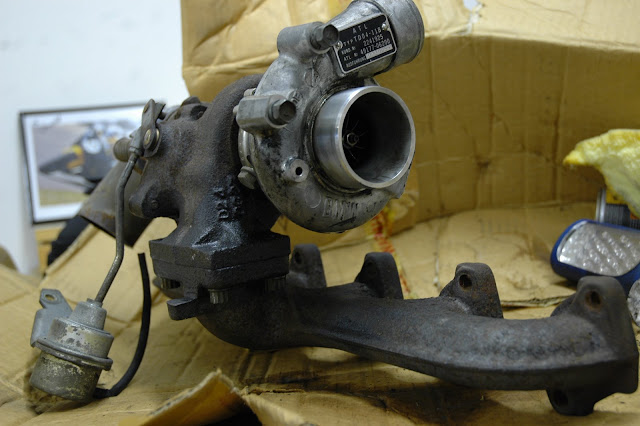

Hey chaps, I've done a bit of an intro in the new members section.. But I'll ainly be camping here.. I'm building a low power (aiming for 250ish hp, but response and torque are more important than power for me for now)
Anyhoo, I've managed to source a 324td turbo and manifold.. which arrived yesterday, and I'm looking at the turbo wondering what it'll be like. I can't find sweet FA on it, but if anyone knows different, I'd be grateful! (I know it's a mitsi/IHI TD04-011) TBH, I was expecting a small spec T3. Mani is a split t3 outlet, so I'll go HX35 eventually.

This is to small, it´s designed to flow for a 130hp diesel. You´ll strangle your B25 engine with this.

Don´t do it.
It´s BAD BAD BAD BAD.
There is nothing fun about reverse flowing extremely hot gases back into the engine cause the turbo is blocking the flow.. It´s hello Detville and Knock City.

In full agreement with Gunni on this. That really is a tiny turbine you have there Ti22, it's designed for flowing a lot less gas than your petrol engine will try and put through it. There's nothing fun about welding your exhaust pipe almost closed, and attaching such a dreadful restriction to your exhaust manifold isn't much different. Sorry to p!ss on your battery, but better to start looking for a better turbo from the get-go to go with your new manifold. Should save you money in the long term as well since you won't risk the damage to your engine that Gunni mentioned.
