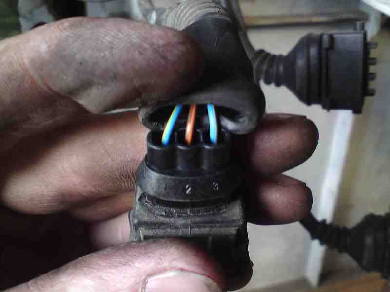

It will indeed, Blue/White to pin 2 and Blue/Yellow to pin 10 of the C101 and wire the earth
Ive actually got a pic of the plug

Dan did this little mod on the loom he supplied me with,works fineDanThe wrote:It will indeed, Blue/White to pin 2 and Blue/Yellow to pin 10 of the C101 and wire the earth
Ive actually got a pic of the plug![]()
