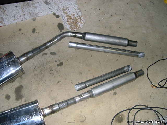

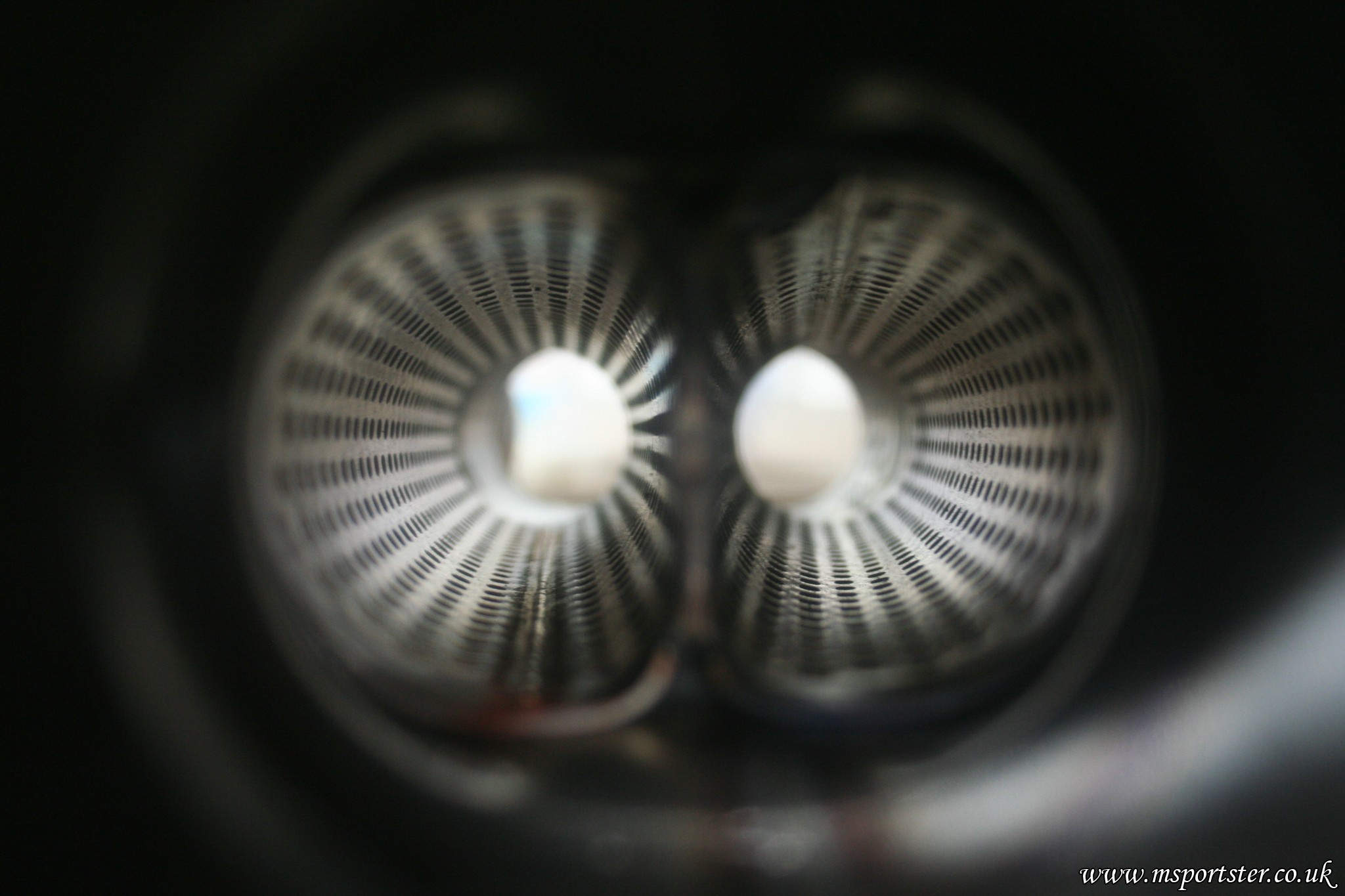

The magnaflow boxes have 1 input and 2 outputs and look like this through the middle:
I've not got a picture of the inside of the jetex but its basically a perforated pipe like yours with a very thin layer of fill round the outside, I only got these to bring the db's down to a level where it would pass SVA!:

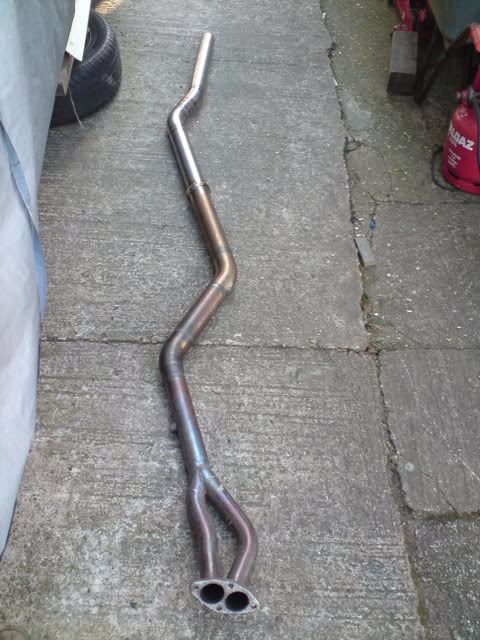

Got everything for the primary exhaust tacked together now!
Really chuffed with the way it's come together!
Started out by making a little hanger for the rear this morning:
Bunged another bend in it to point the last bit of pipe at the left hand tail pipe....ish:
Decided it might be an idea to make the silencer detachable this time so added a V-band (gotta remember to get another one!) and did the final swan-neck into the silencer:

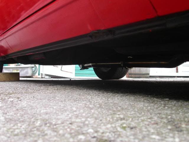

Looks like ground clearance should be fairly reasonable with the pipe being probably 1.5" lower than the lowest point on the car:
And here it all is :D

JazzMan wrote:My straight through boxes from Magnaflow and Jetex look like that on the inside :)
Mine too :cool:
You could fit a skinny arm through and out the other side of mine.

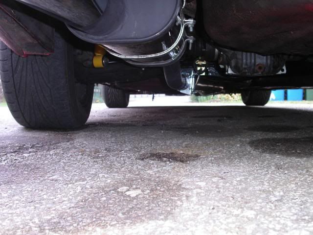

Heres a pic of mine, looks pritty simular to me!, heres afew pics with it on the car on a -40mm drop, mines does sit slightly low, but ive only cought it on the speed bumps you get at private companys and they've made them there self, and about 3mile high :x
:cool: :cool:

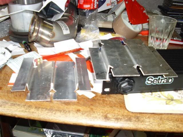

Have made some progress on the new charge cooler today (and then run out of materials :lol: )

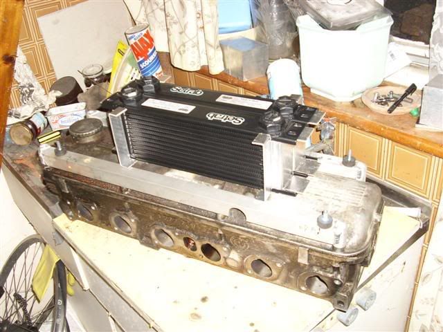

Here's the new cores and the little brackets I've made up to hold them together:
And here's where they'll go in the end:
Just gotta bracket them back to the little rubber bobbins tomorrow using whatever material I can find and then I can start on the foam cores for the shell parts :D

Have managed to finish them off today, and that's about it! Will go and do some more work on the mould for the boot lid in a minute though.....honest!
So here's the final resting place of the cores, unfortunately didn't have any polystyrene so starting on the CF shells will have to wait :(
