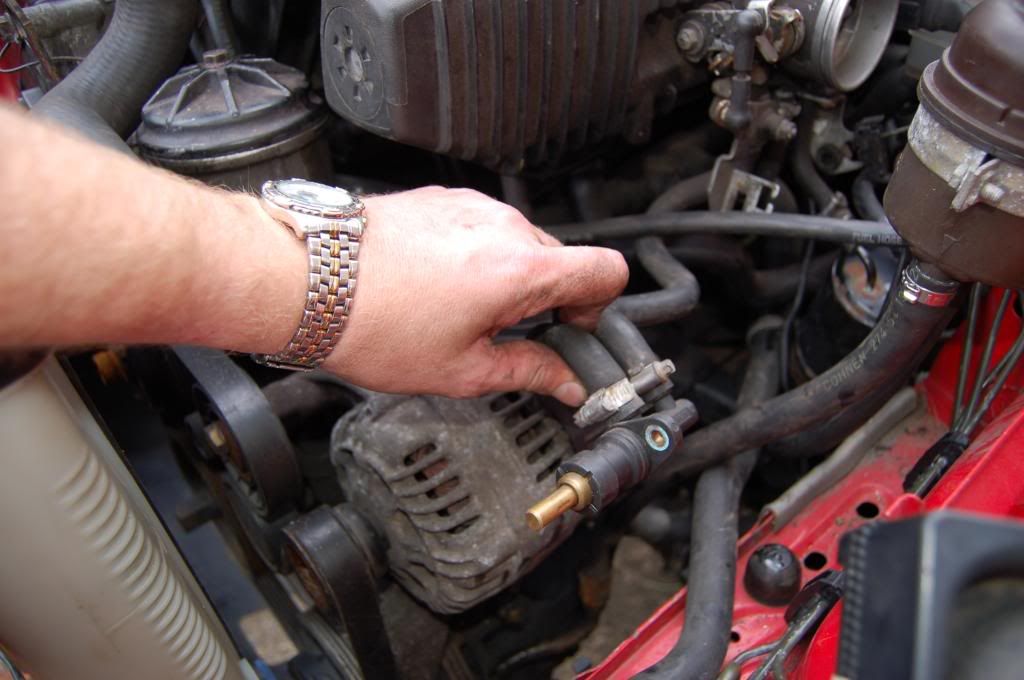

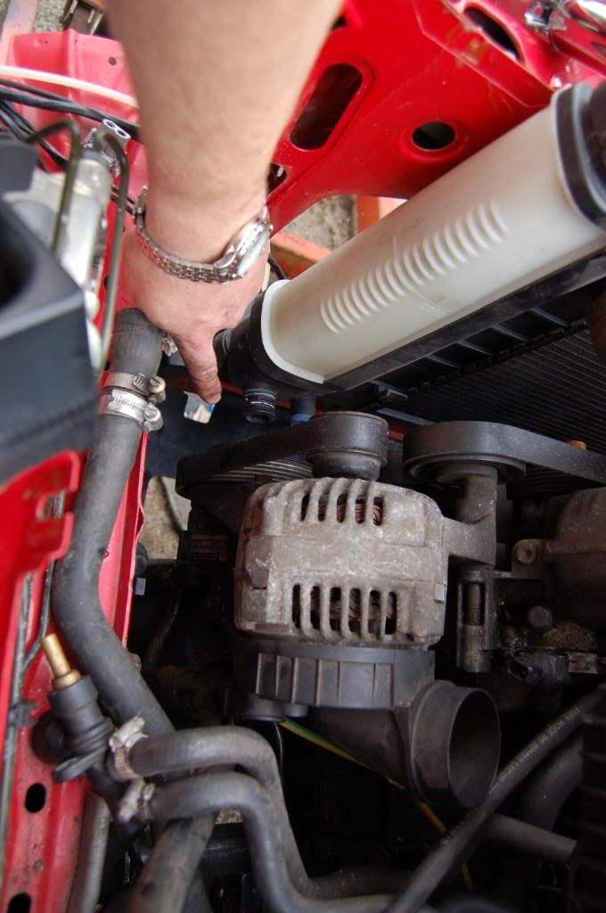

I have a problem using the standard M40 rad by the looks of it, has anyone got round this problem or do I just stop messing about and buy an E35 M50 rad?
What is this for and where does it attach? One hose goes to the side of the head under the inlet and one goes to the bottom of the throttle body.
Does this hose which i'm pointing at and has had a bolt stuck in the end connect to the carbon canister?

That loom is a right mess, looks like the diagnostic plug has been cut out.

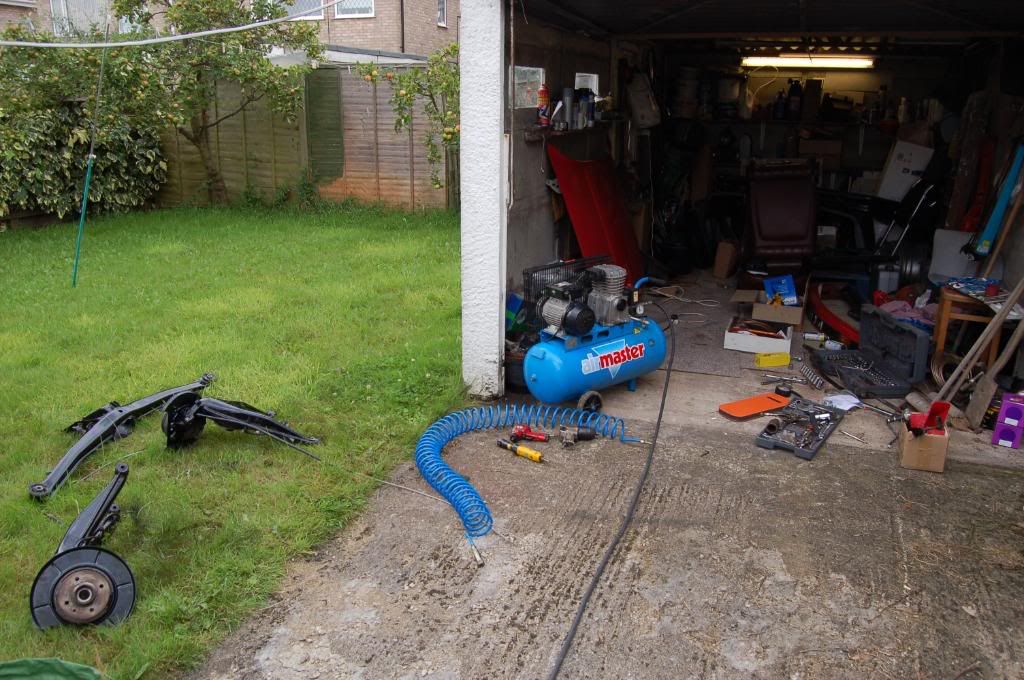

As things have reached a bit of a halt at the engine bay end of things, I used today to get the rear end ready for re-fitting.
Bolted up the trailing arms to the subframe, should have used new bolts etc as these are a bit rusty but what the hell. Made up some brake pipes, fitted new handbrake shoe compression springs, new rear discs and other assortments.
Here it is in a sort of mock up with the diff roughly in situ.
What a scrap yard
What a scrap yard

Rad wise I used an m20 one it seems to fit fine and dan said they work fine too

If you use an M20 radiator you will also need the expansion tank...M42 is this engine's nearest relation in E30 use,what do they use?Bob_S wrote:i had mine in and running within a day nearly ready to roll now, just need to secure my airbox and finish the exhausts.

i used a 635csi rad a got viscous fan in for good measure

M42 rad has the expansion tank integrated to the side of the rad I believ, got an M42 rad sorted for this weekend (milkbar meet)
