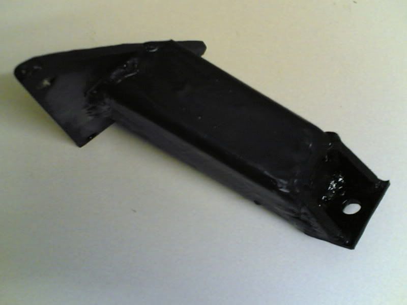

hopefully will be fitted at the weekend and i'll get the engine mounts knocked up as well.
then i can start the manifolds.

you can get V8 motor mounts for the M60/2 conversion into an E30 from AKG motorsport
bigdek
- E30 Zone Camper
- Posts: 1115
- Joined: Thu Feb 10, 2005 11:00 pm
- Location: Fife Scotland
i dont like that method of mounting.
prefer to have the engine sitting on the mount on the crossmember

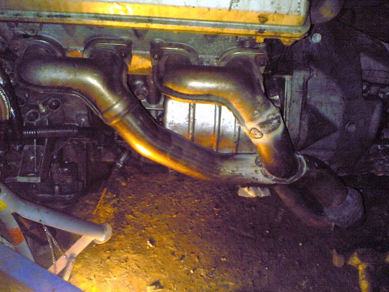

Finally found some time to do a little bit .
Managed to mod the existing manifolds for the nearside today.
Offside is a different ball game but i've got a plan and hopefully will be done on Sunday.
Will be making new tubular ones next year but these will do for now as i'm skint.
Hope to get the engine in and running in the next 10 days ( weather permitting)

good work derek.
offside manifolds are no laughing matter though mate! plus you've got the added bonus of missing the steering column.

Finished the offside manifold just now. Not pretty but it'll do for now and i'll use it to make a jig when i make my tube ones later this year.
Should get the engine and box popped in again tomorrow and hopefully get my engine mounts finished.
Then i'm doin the fuel lines and going see if it'll run.

Any chance of seeing some pics of the engine mounts you are making, when they are done?

Moment of sadness today.
Engine and box back in but someone cant measure properly and the manifold is touching the steering.
Just need to do it again
i'm goin to finish the mounts first then get it fired up.
Then i'll sort the exhaust problem.
On a plus side a m8 is giving me all the exhaust tubing i need and a pair of cheery bomb type silencers for 50 notes .
It'll be loud

If i decat this what do i do with the sensors that are currently on the cats

finally got a bit of reasonable weather this afternoon.
Engine mounts now fiinished
will be the weekend before i can fit them as i have lost a couple of imporant seals that go behind the original nearside mount which will be left on due to bmw's ingenious design.
Both oil lines from the remote filter actually pass through the nearside engine mount . very bizarre
nearside mount
Offsidemount
nearside mount
Offsidemount
