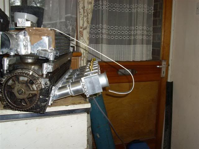

Not done an awful lot this weekend except bought some more pipe bends and found that they're MILES too big to go under the bonnet
So then the head scratching started as to how I might get air from the charge cooler to the throttles.
The answer is in a strip of metal which I bent up to see what the under bonnet clearance was actually like....and this is the result:
It looks really weird at that angle but with the head on the engine, the long straight bit of the strip is horizontal.
There's about 2" of clearance between the flat and the throttle so the linkage is gonna have to be underslung now, but that shouldn't affect the injector positioning.
So all I'll have now is a shiny sheet of metal and then six little rubber connectors from the air box to the throttles.
It's not gonna be ideal having the air make such a sharp turn, but the flow area is still massive so air can still enter each cylinder from the side too.

Actually thinking about it, with a plenum as I've shown it there, I should have about the same volume on the inlet side of the throttles as something like one of the M5x engines, just with a vast inlet to that plenum.

doesn't the overall length of inlet tract determine torque characteristics not the shape of the trumpet flange?

hi this is a great thread i've become really interested in your project I have a couple of questions whihc made sound stupid but I can't quite grasp whats going on
I'm assuming thats a watercooled charge cooler?
and I'm also assuming that the large pipe in is the inlet from the turbo?
so you are going to fabricate a box with 6 outlets coming off it to go on the other side of the cooler and the outlets willsweep 180 down onto the ITBs?
any reason you didn't go for a Air to air jobby mounted somewhere in the airflow at the front of the car? are you going to use a seperate water system for the chargecooler?
I expect you have already been through all this and I havent read the thread carefully enough

The tuned length of the inlet will influence the torque characteristics of the engine, but in the case of this engine boost should be available everywhere in the rev range so pulse tuning of the inlet and exhaust becomes much less important.
The Charge cooler is indeed going to be water cooled with something like a motorbike rad at the front of the car to lose the heat. The large pipe comes from an air divertor assembly which determines whether the boosted air from the small turbo or the large one sees the engine.
The air box will have six outlets but they'll point directly at the throttles and have about a 50mm silicone joiner to connect them to some inlet stubs. The bent up strip of metal shows the outer shape of the air-box-to-be. whilst the inner line of the box will go from the bottom of the charge cooler core to the top of the throttles with a slight radius in it where it bends.
I went for the charge cooler as they have potential to be very efficient and also it gives the charge air about the shortest path to travel into the throttles. The air does have a very large volume to fill, but I believe that having massive flow areas is intrinsic to producing lots of power per psi of boost.

Crikey, wouldn't say I'm any real kind of authority on turbocharging M20s, just have a reasonable grasp of the basics
I guess the cost depends on how much else you could do yourself. If you can TIG weld, wield a hacksaw and some files then you can make a manifold for a couple of hundred quid out of stainless steel, would get a nice great big turbo like my H1C or one of the more modern Holsets which is another couple of hundred.
You'd need some kind of wastegate and I understand that the generic non-branded ones last just as well as the Tials etc so that's about another £70 or so.
Then there's just the charge / intercooling, piping for the air, an exhaust system, oil feed and drain and the all important engine management.
The engine management would need a MAP sensor (guess it just looks at throttle angle at the moment) you should have a manifold pressure compensation map in the ECU software somewhere.....I hope!
My twin turbo system which I built last time around came to about £4500 and was based on a standard spec early engine (with 9.7:1 compression) which made 270bhp from 7psi.
You would need to look at your compression ratio if you plan on running 13psi, you would make an awful lot more than 240bhp with that too!
I believe I got 270bhp from just 7psi because everything in my system was so overspecced in terms of flow areas with the exhaust being a twin straight through 2", all the inlet piping being twin 2" and it having throttle bodies.
Restrictions are the enemy of power!

The length of the runners was dictated by the thermostat housing which gets right in the way of everything!
Could probably have relocated the thermostat housing but thought it'd just be one more thing to go wrong
