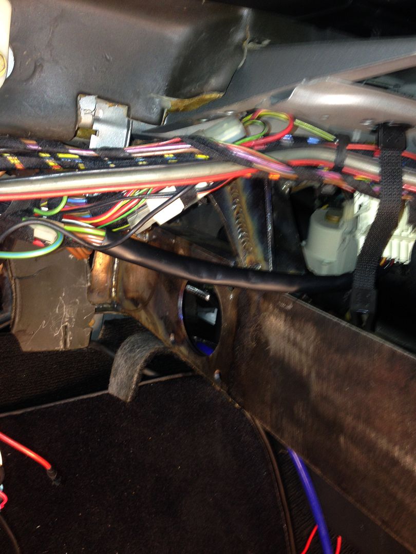

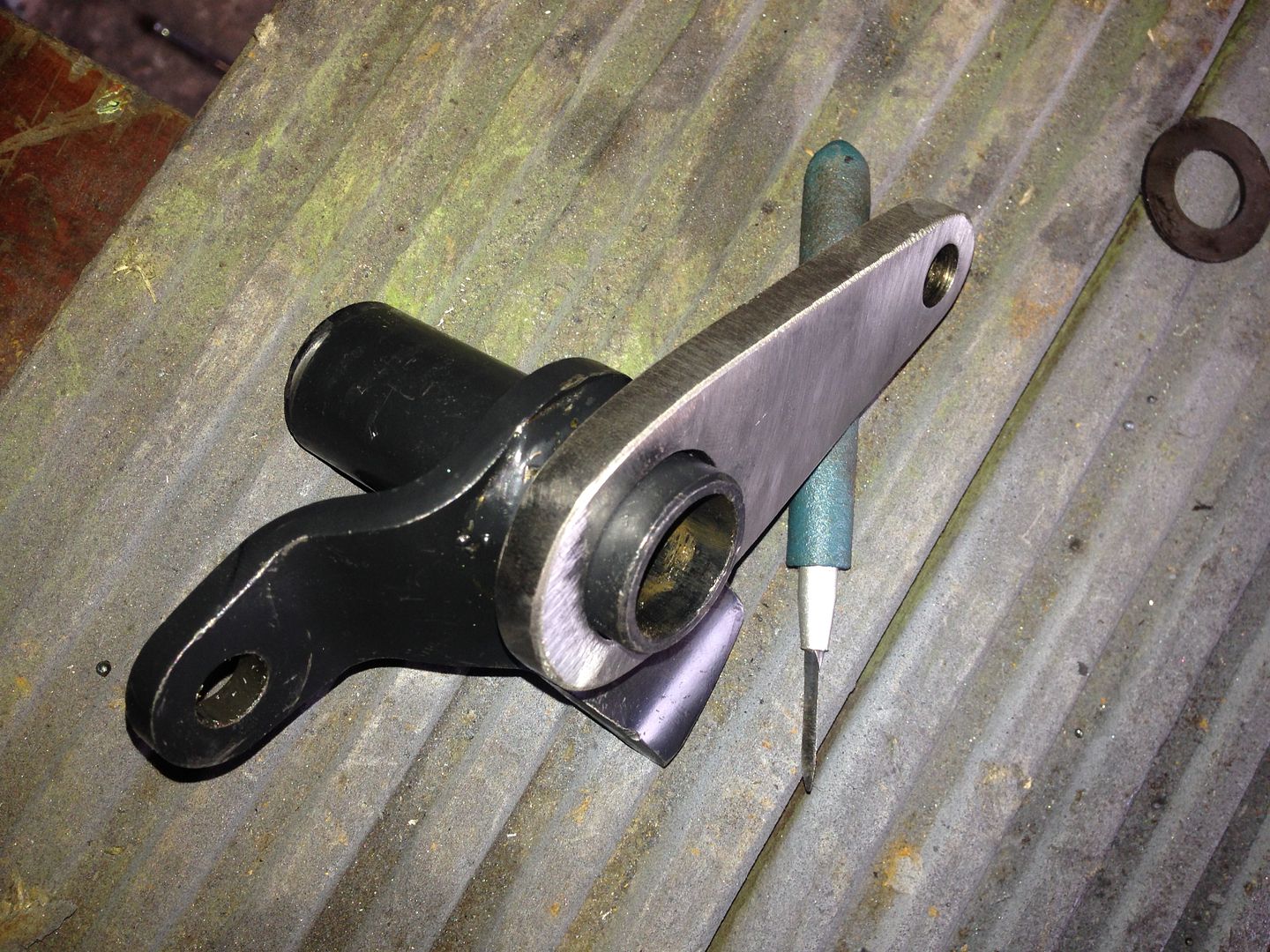

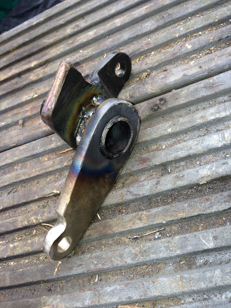

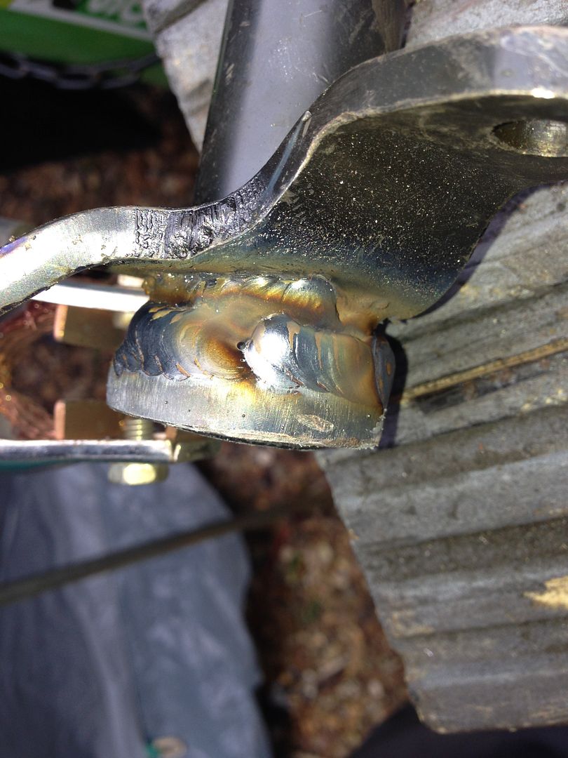

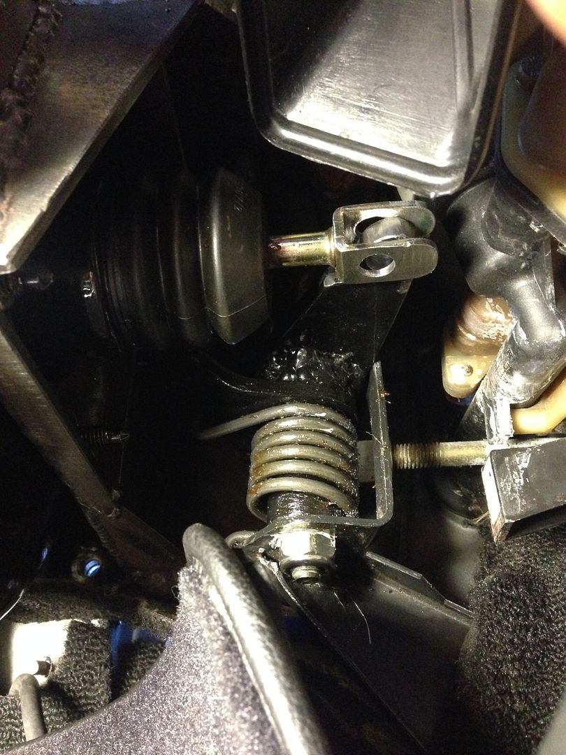

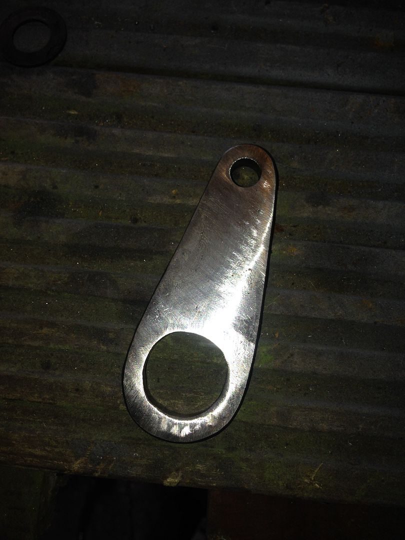

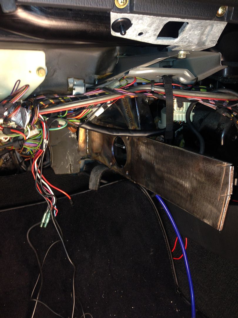

done alittle more made the pivot arm for the servo today
lined it up
and welded it
plenty of weld on there don't want that comin lose
mock testing it in the car

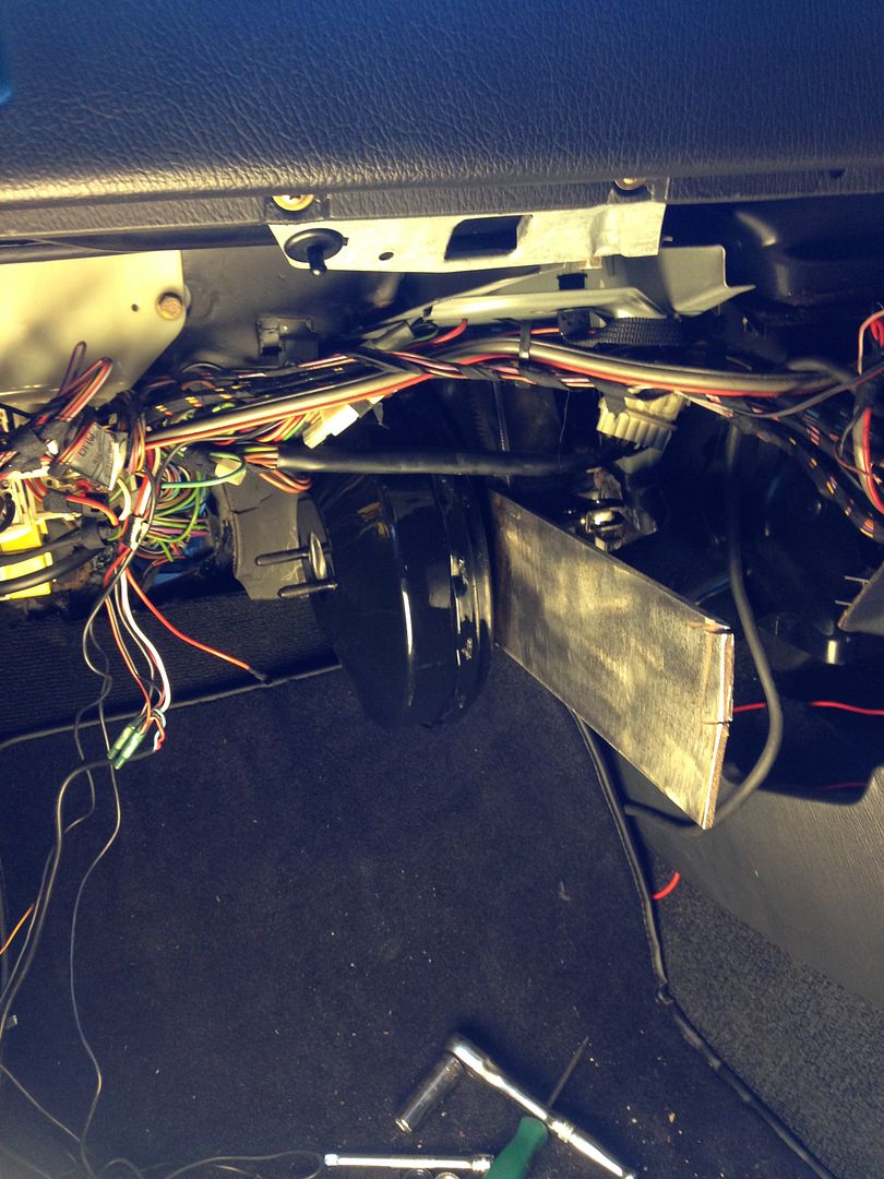

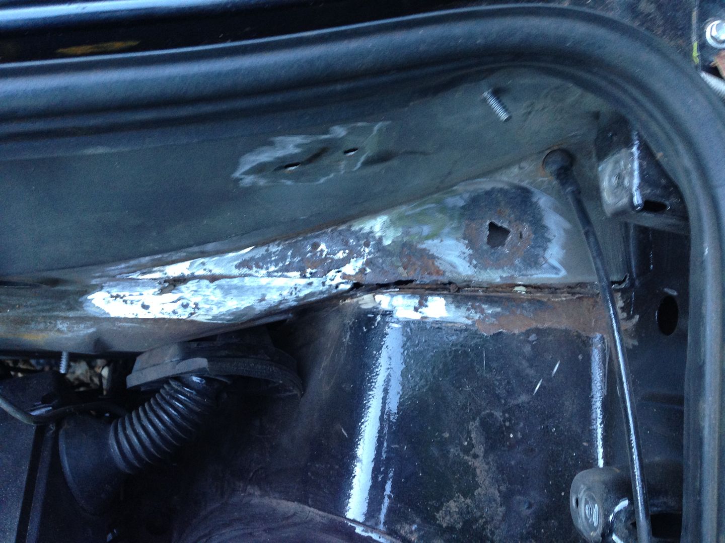

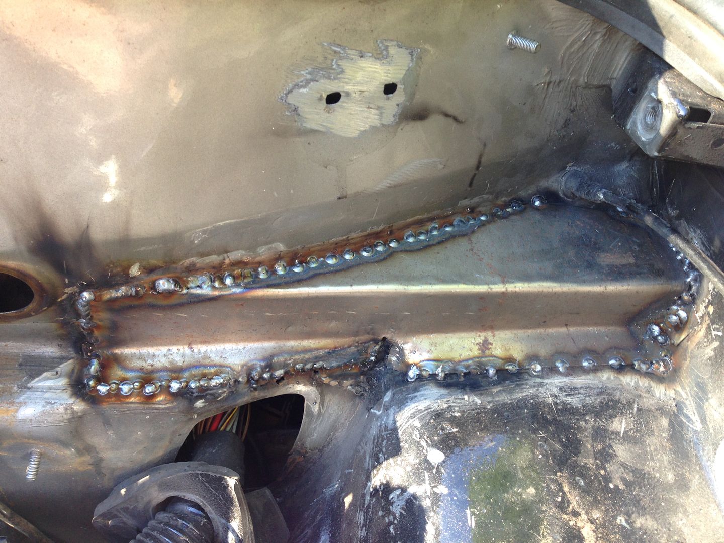

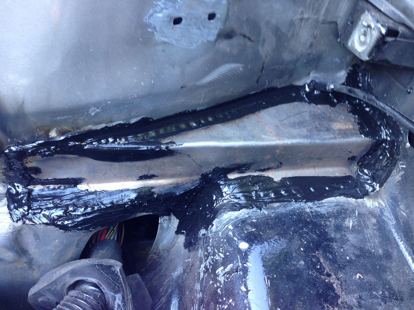

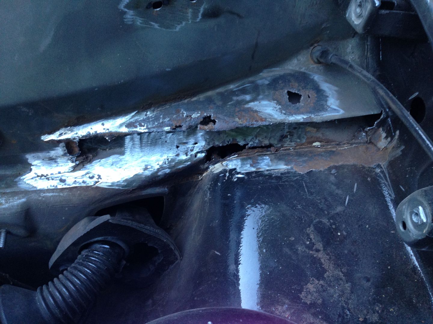

as I was doing the servo bracket found another little hole behind the fuse box so now I know why I was always getting a wet footwell
and now all done

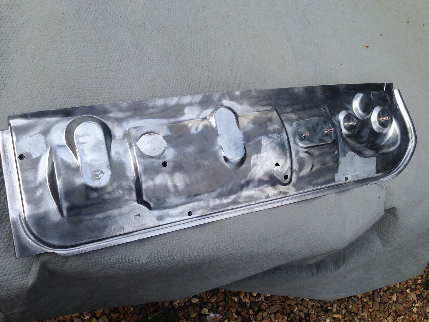

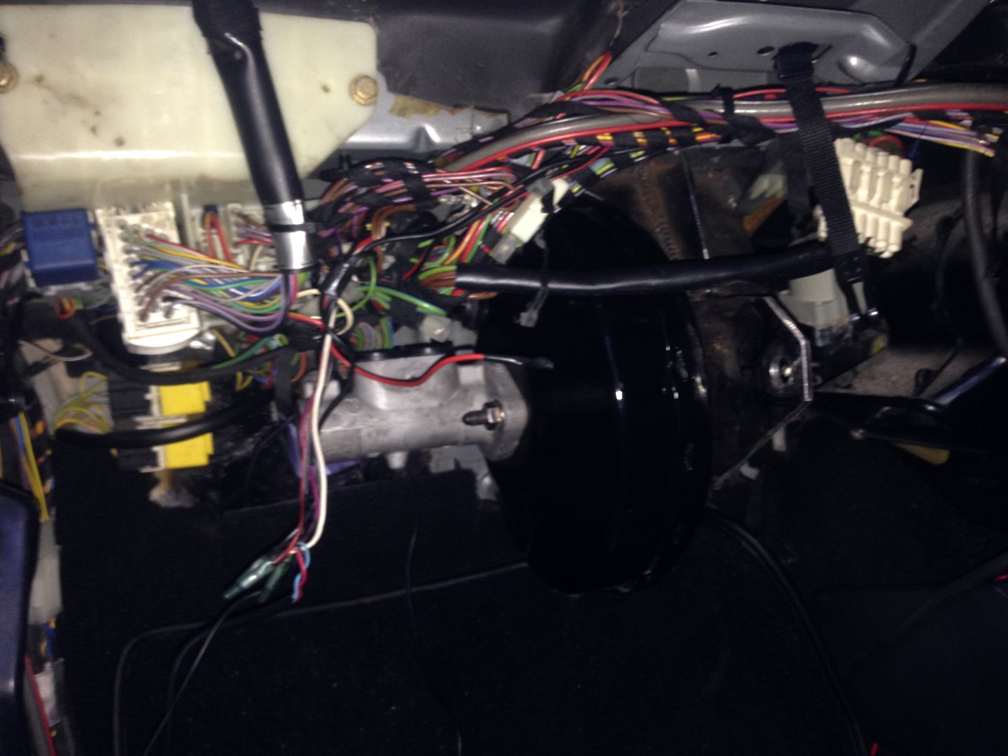

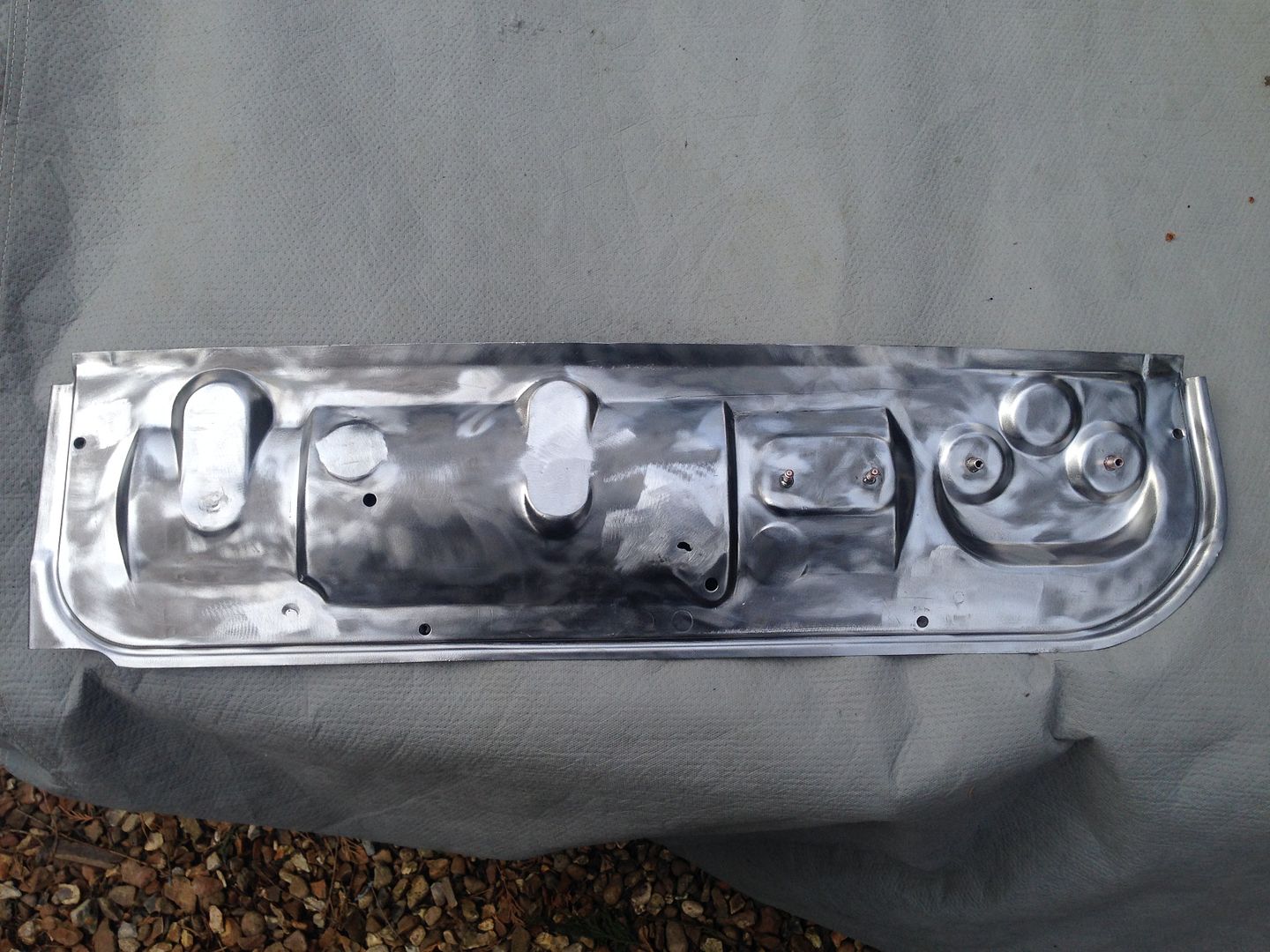

as I can't do much more with the brake servo side as I'm still waiting for parts I decided to start on the engine bay tidy it up a little so I started on the bulk head blower cover thingy basically just stripped the sound deadening off it as it's going to be all painted

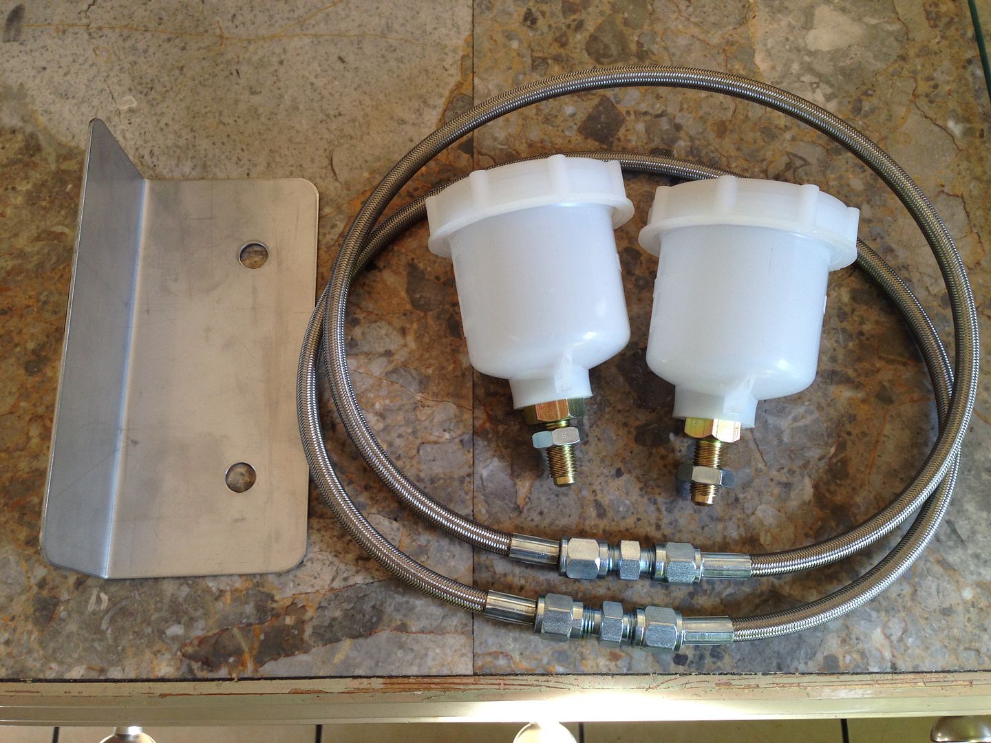

any who these turned up today new brake reservoirs for the master :)

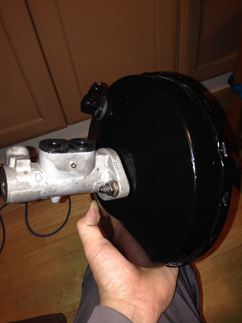

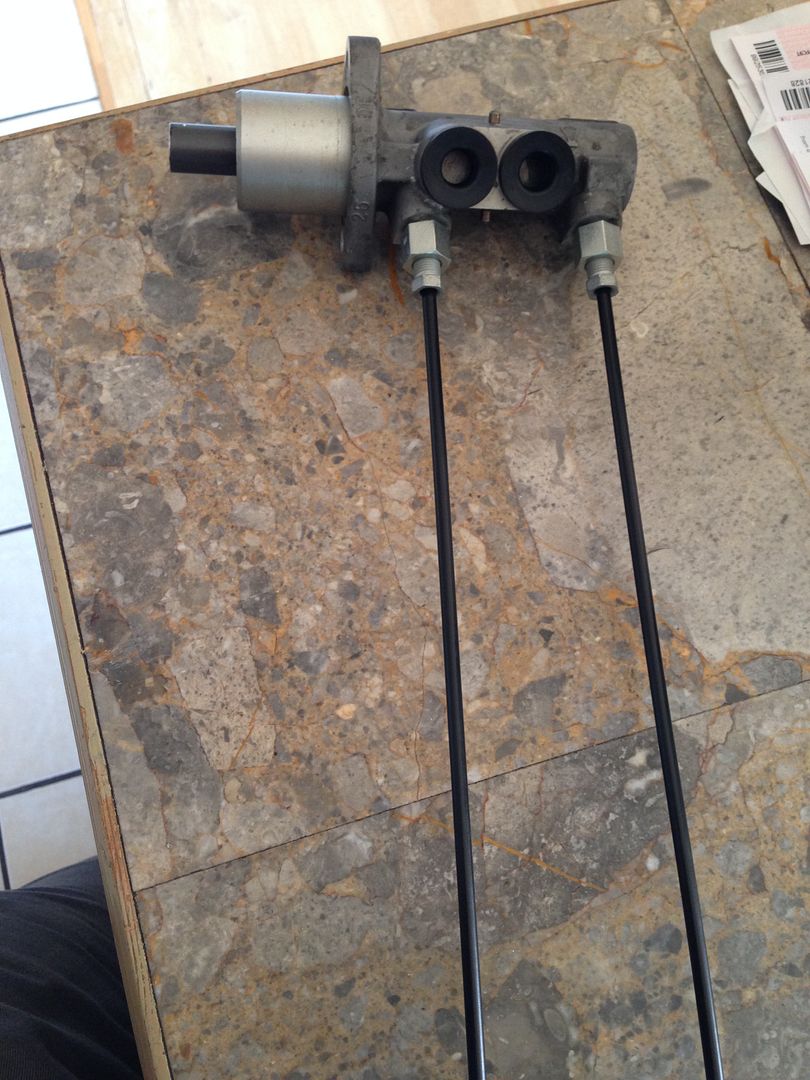

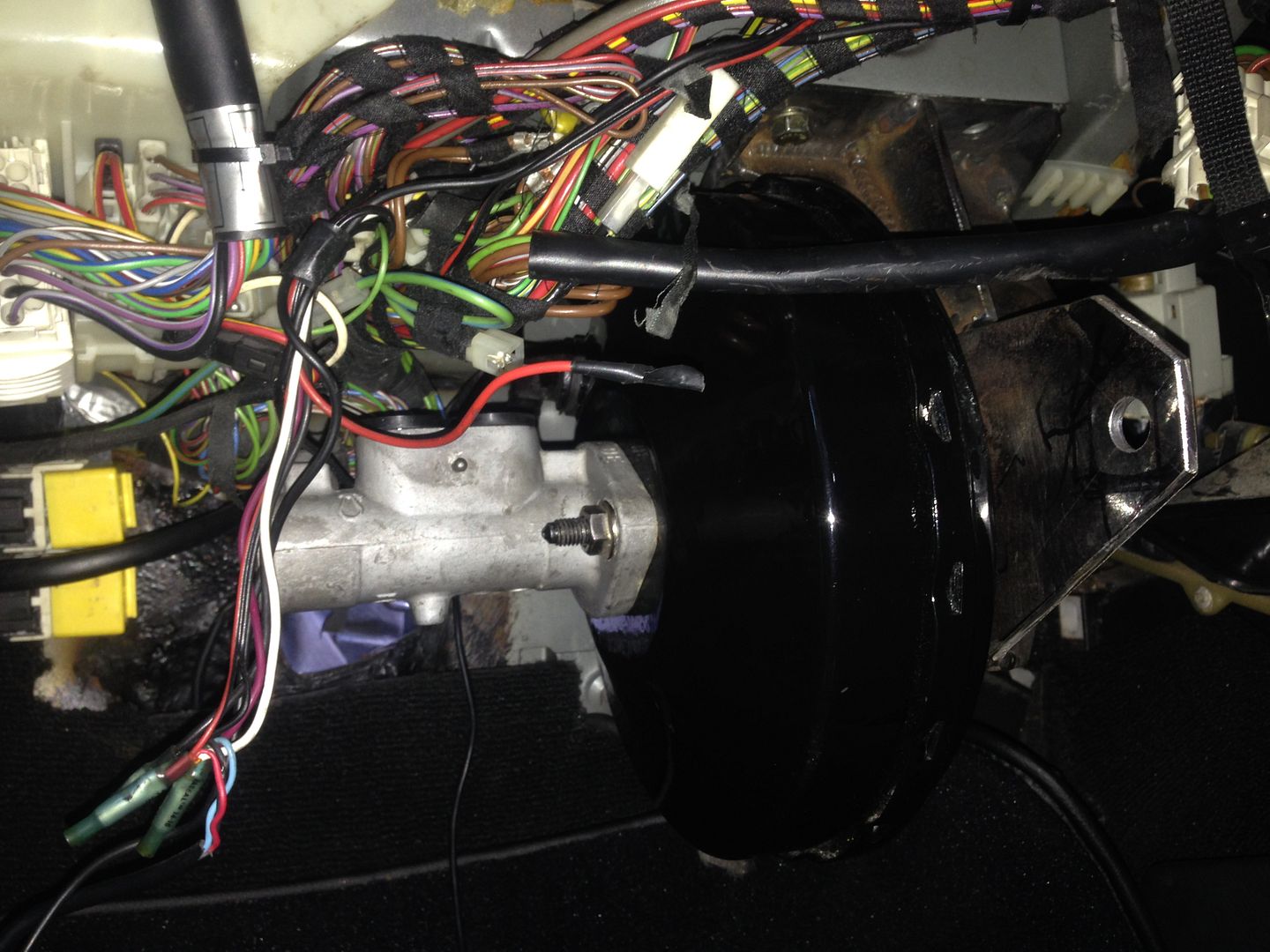

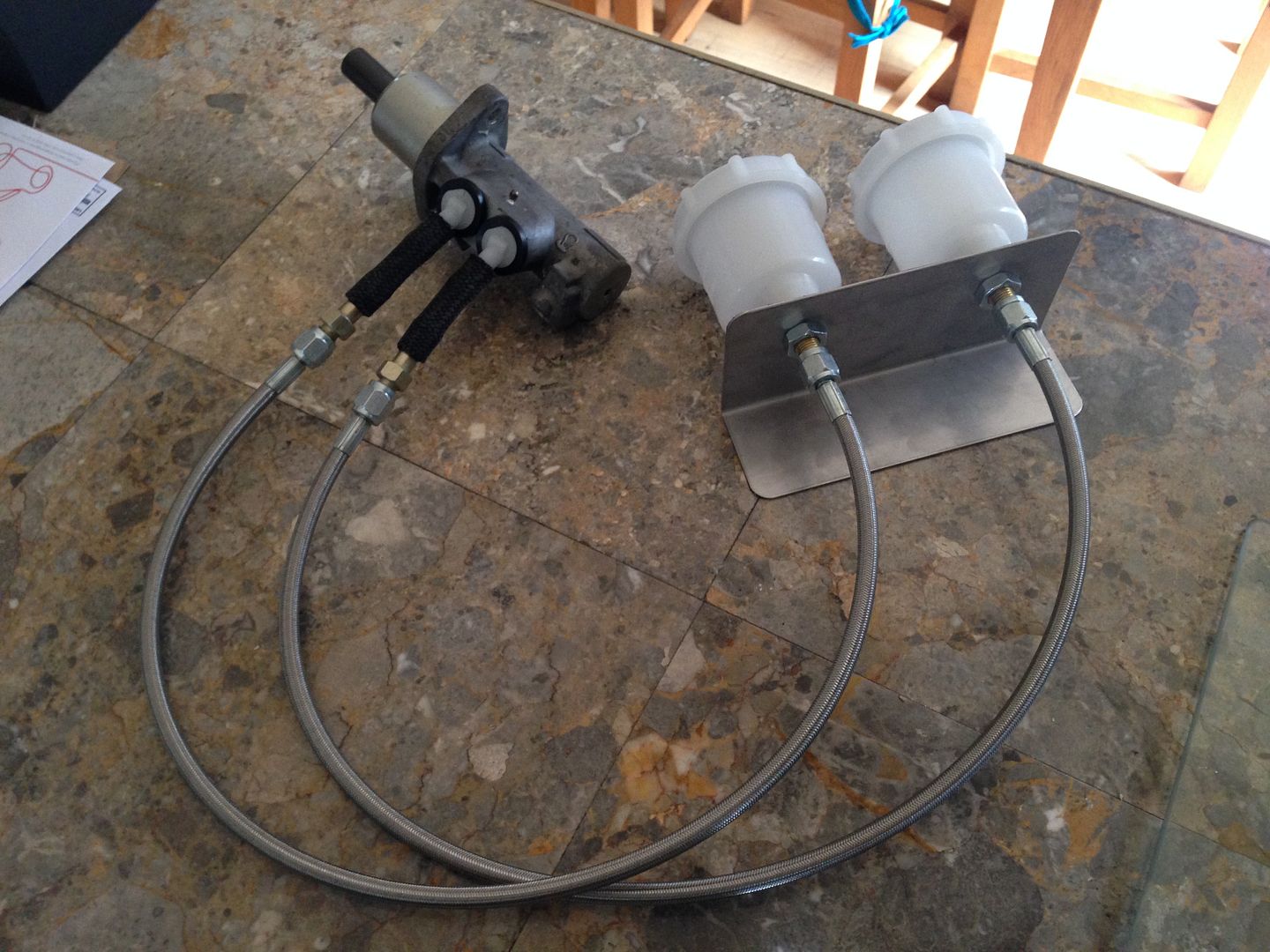

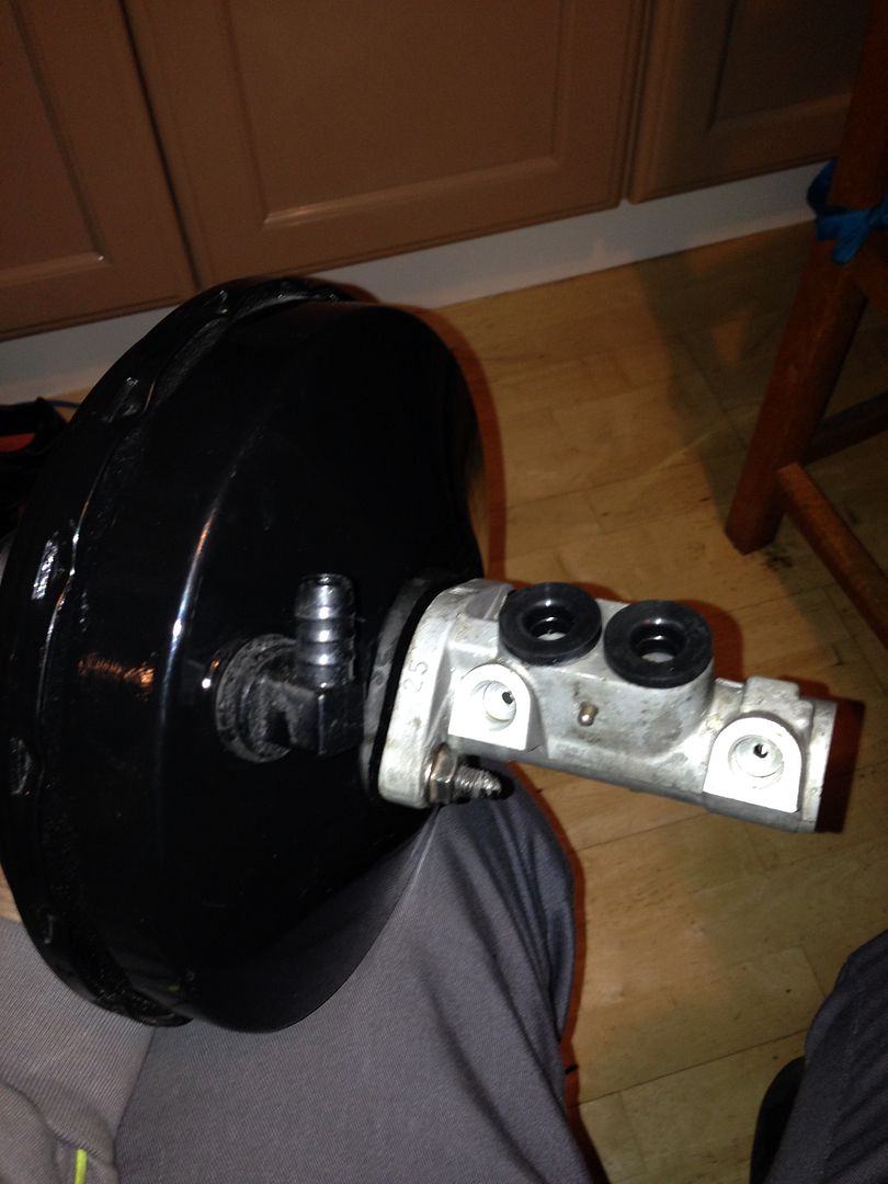

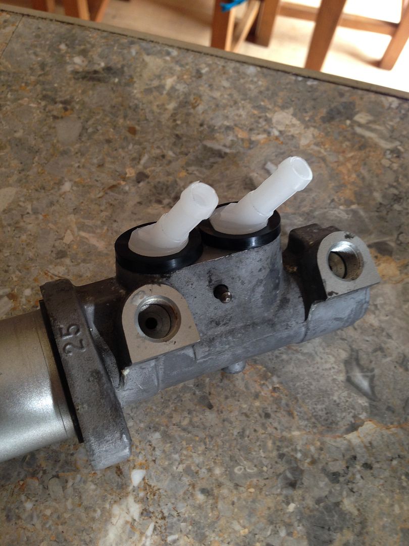

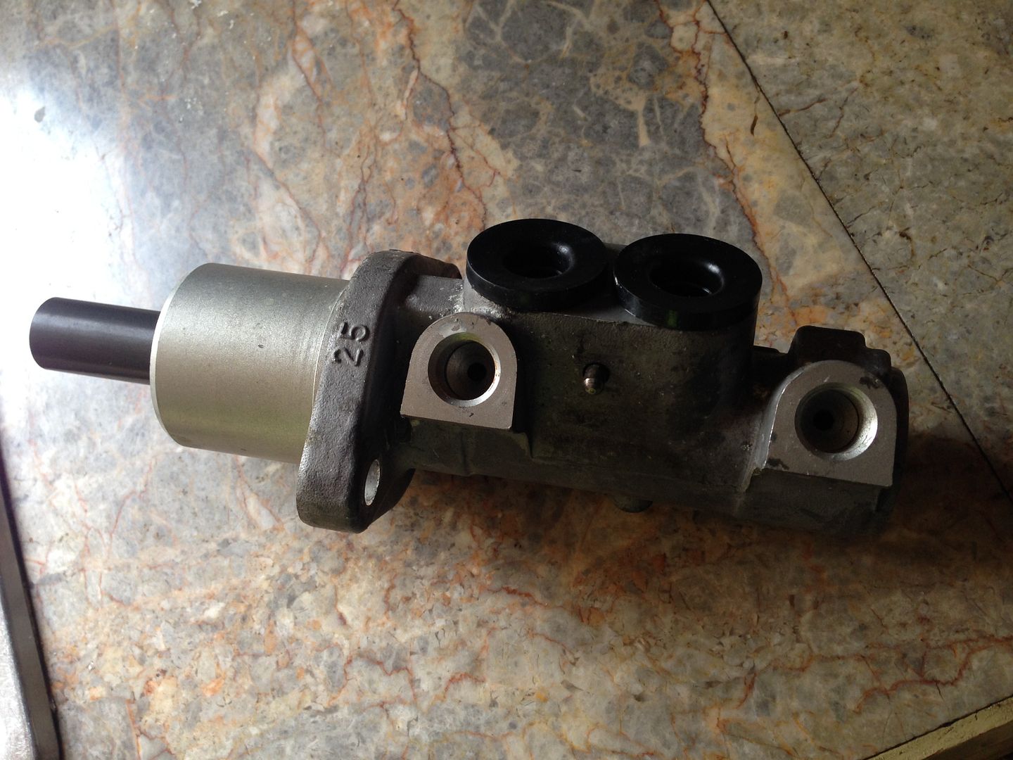

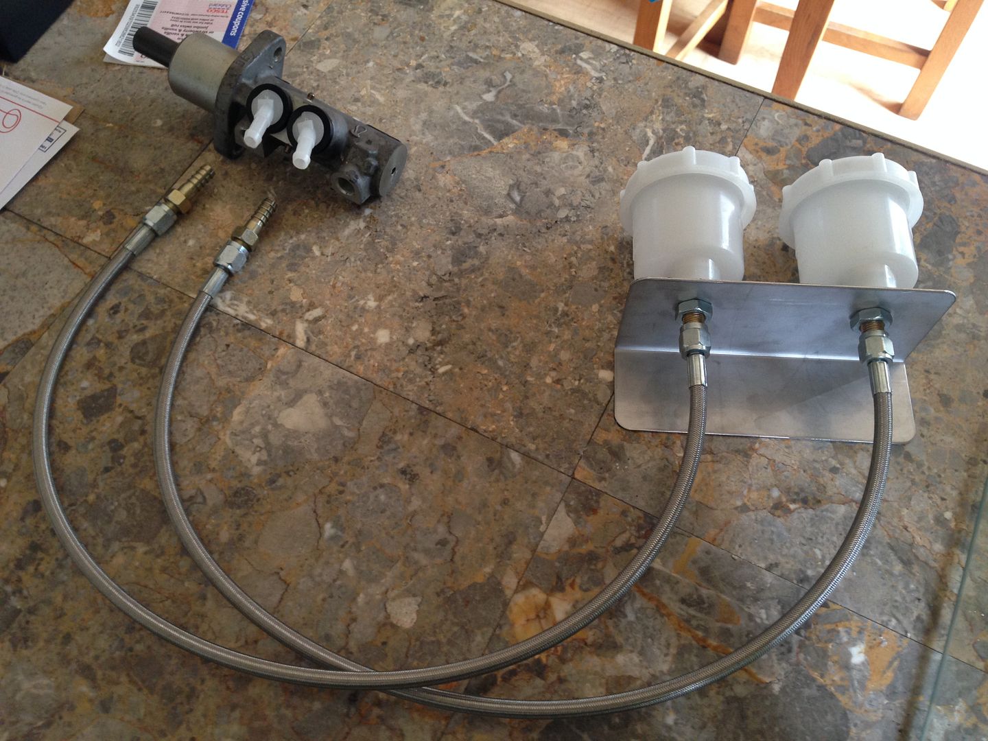

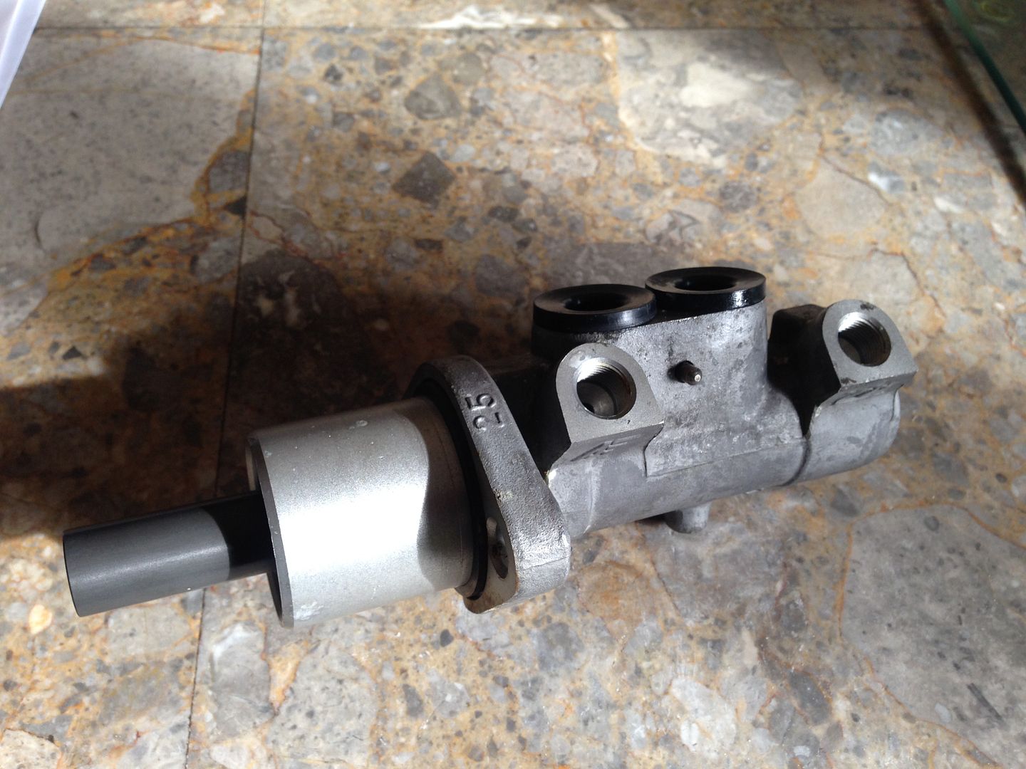

so my master cylinder finally turned up today after 2 weeks of waiting

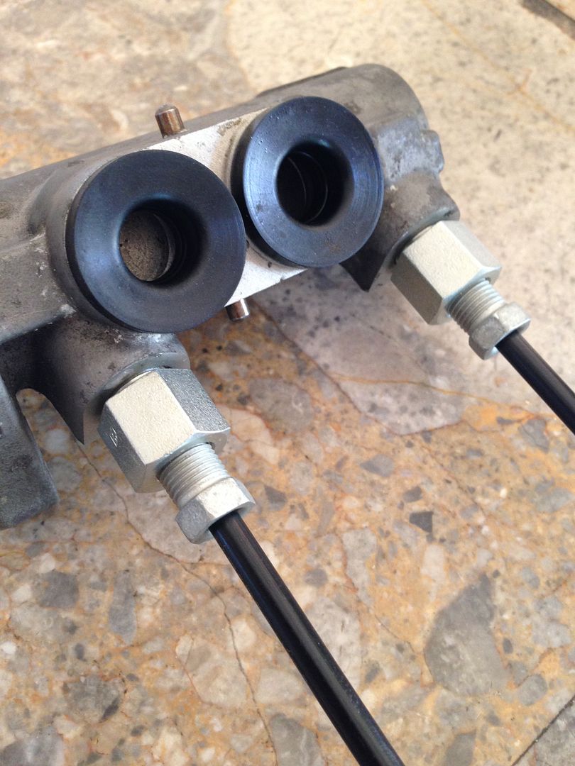

its from a vw sharan 1'' bore which should work well with my 4 pots and is quite stumpy too

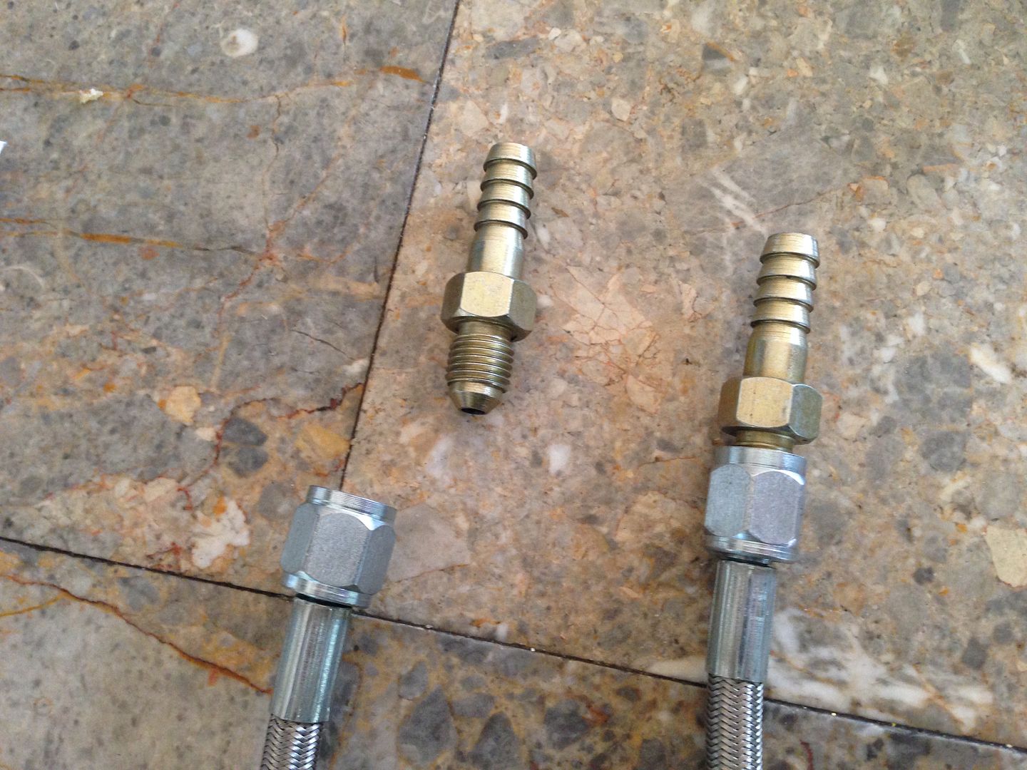

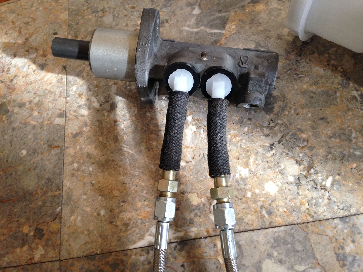

as my feeds from the reservoirs are femal threads ive had to slight adapt them i got these which are from a 1960s beetle
then these to adapt the female part to the plastic bits
which will then look some thing like this
just have to plumb it all in and thats then the brakes all sorted just in the process of refitting the glovebox bk in too as it wont fit properly in front of the servo now so ive had to remake a new hinge system and relocate it
another job ticked of the list

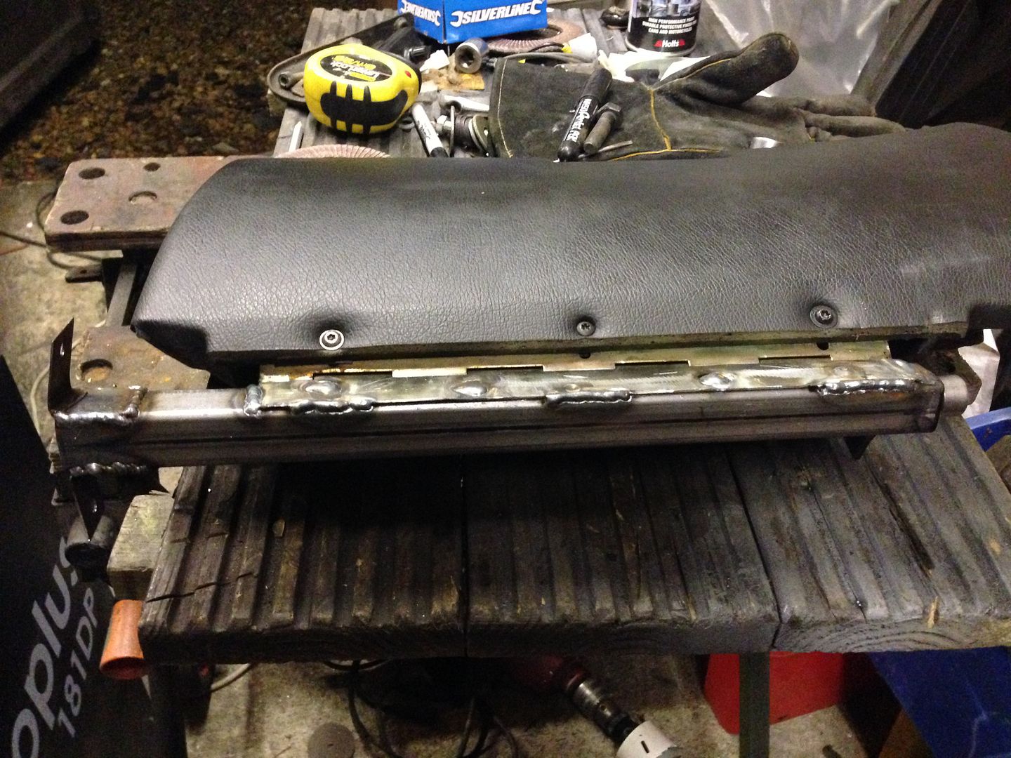

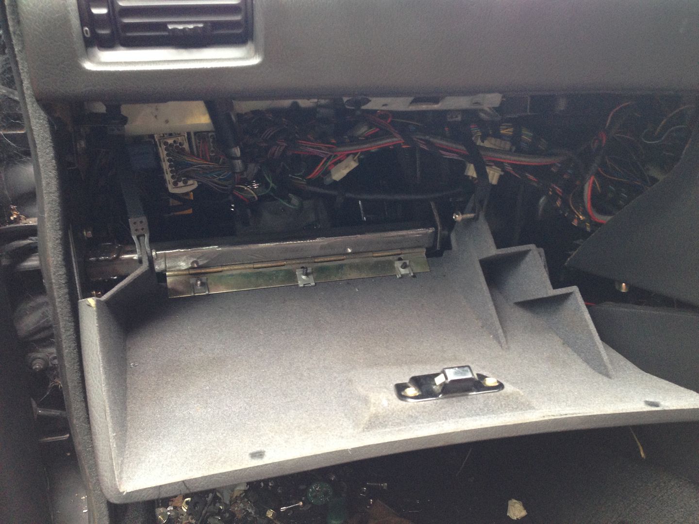

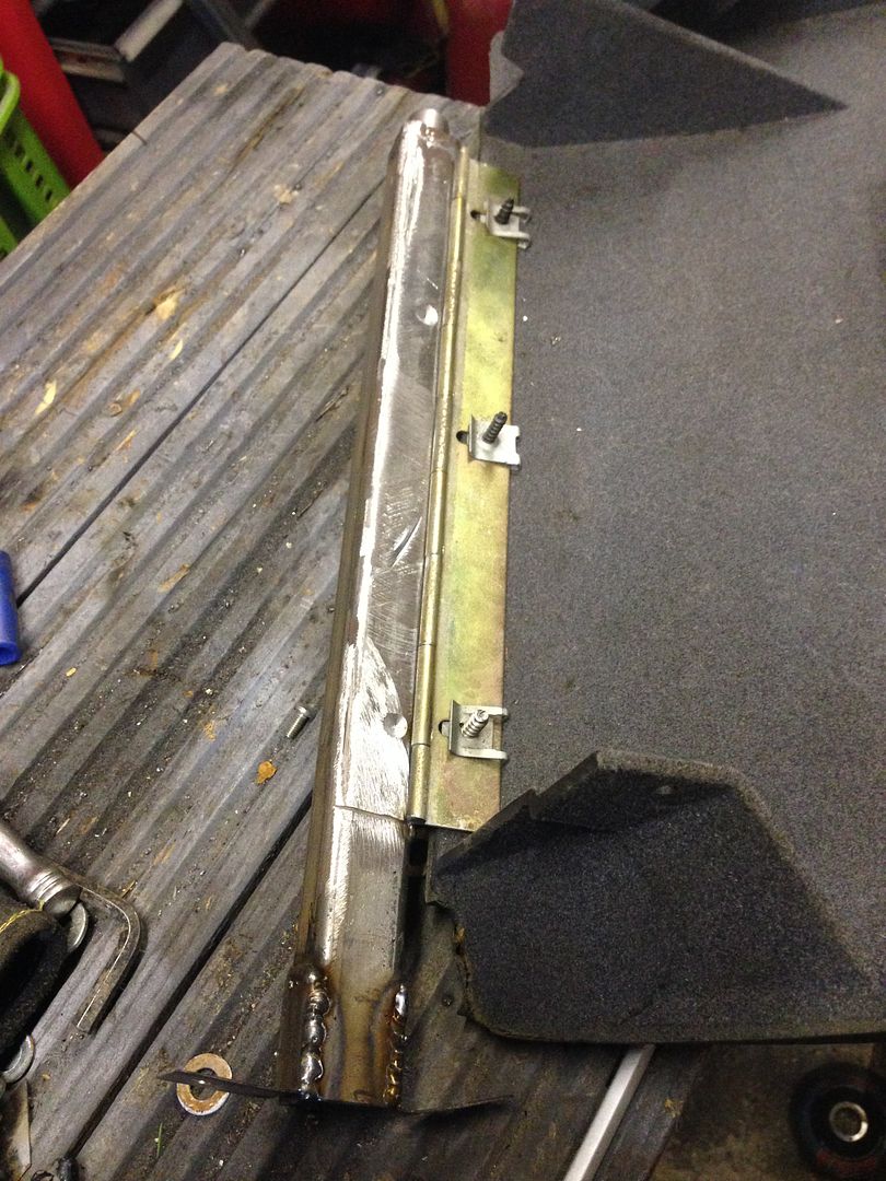

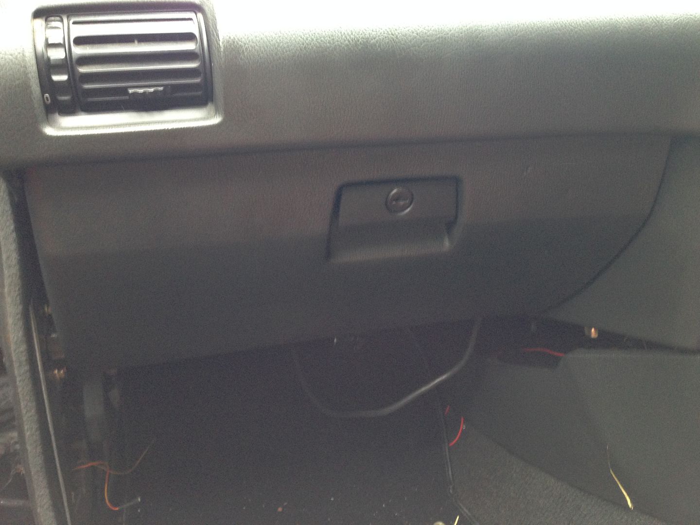

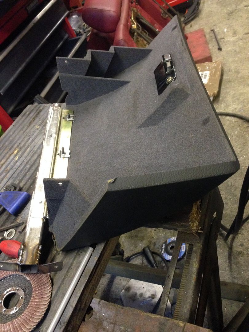

not touched it mate as I'm working on my van at the mo I've managed to do the hinge for the glove box I've had to cut the glove box shorter as it wouldn't go bk in as it was,it's all done so just gotta take it all out paint it all and fit it all properly
couple of quick pics of the glove box

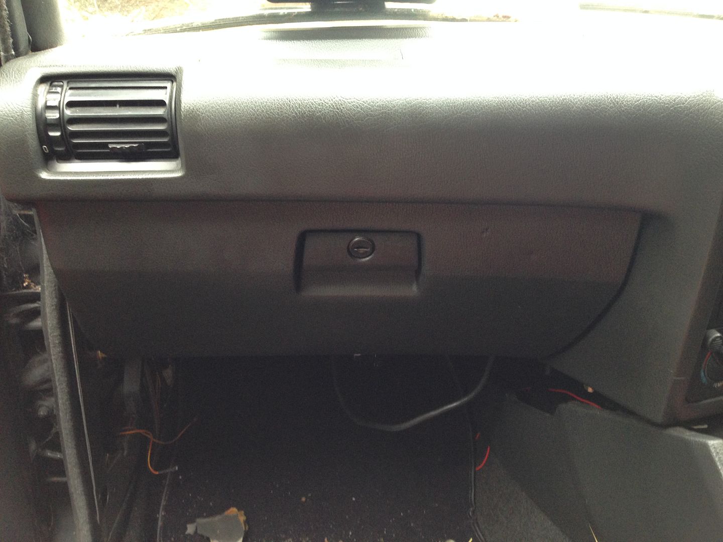

just a couple more of the shortened glove box and new hinge

progress has been slow as of late and ive been working all weekend but i have done a few little bit got the new front brake lines and adaptors for the master as they where m12s not the bmw m10s and finished of fitting the glove box
looks a little tight dont it
adaptors and new bmw hard lines

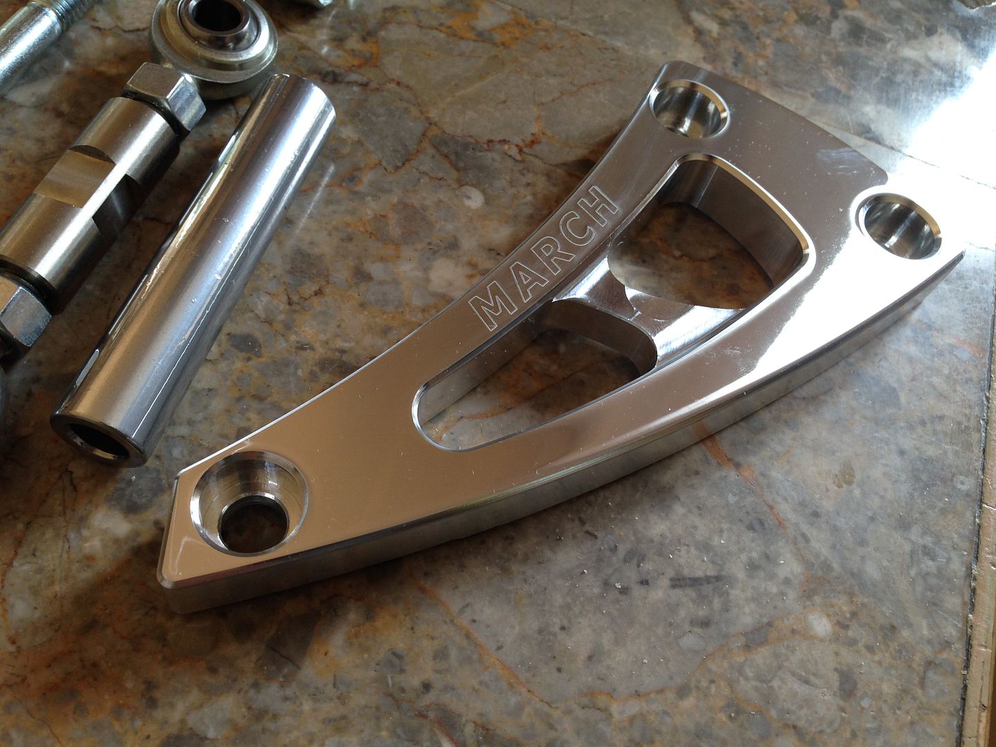

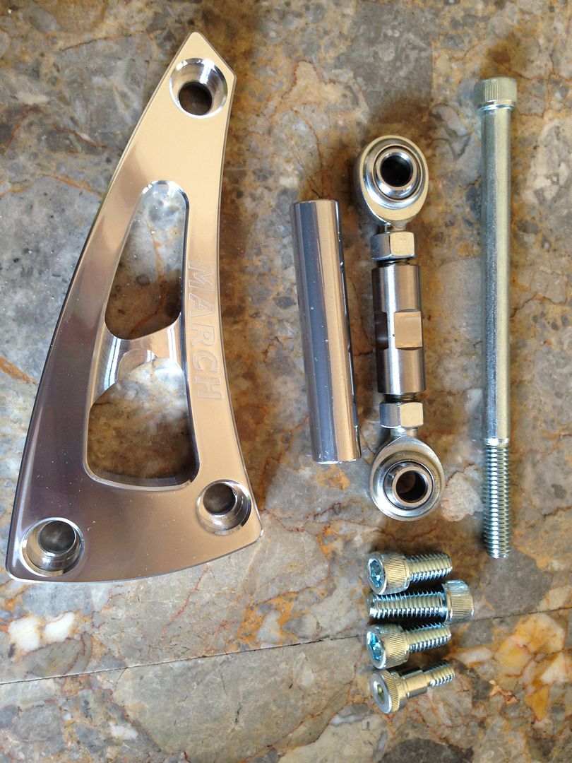

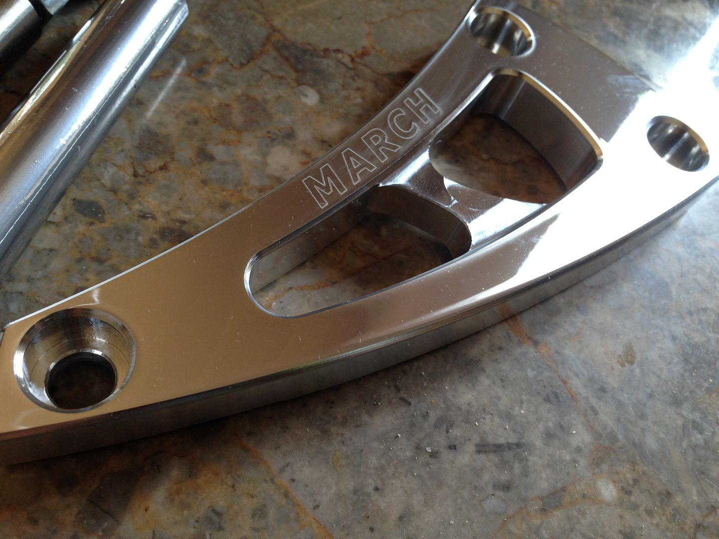

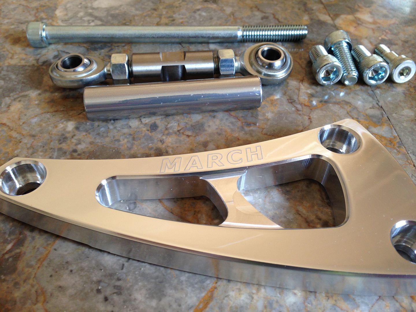

the alternator bracket turned up from the states today too
should looks like this when its all together
you can prob tell what this engine is gonna be like when finished :)

so is the sharan m/c a direct fit to the servo? maybe cheaper alternative to the 750il m/c
ross2009
Posts: 2762
Post Wed Apr 02, 2014 4:32 pm
to a Clio servo yes near enough not 100% sure on the e30 servo mind
the only thing needed is the tube that the adjustable rod goes up needs chopping down a little so it doesn't bottom out in the servo but then that leaves a gap so a 2mm spacer is needed between the master and servo I'm yet to make that
only other thing is mine outputs on the master are m12 were as bmw is m10
Turbo M20

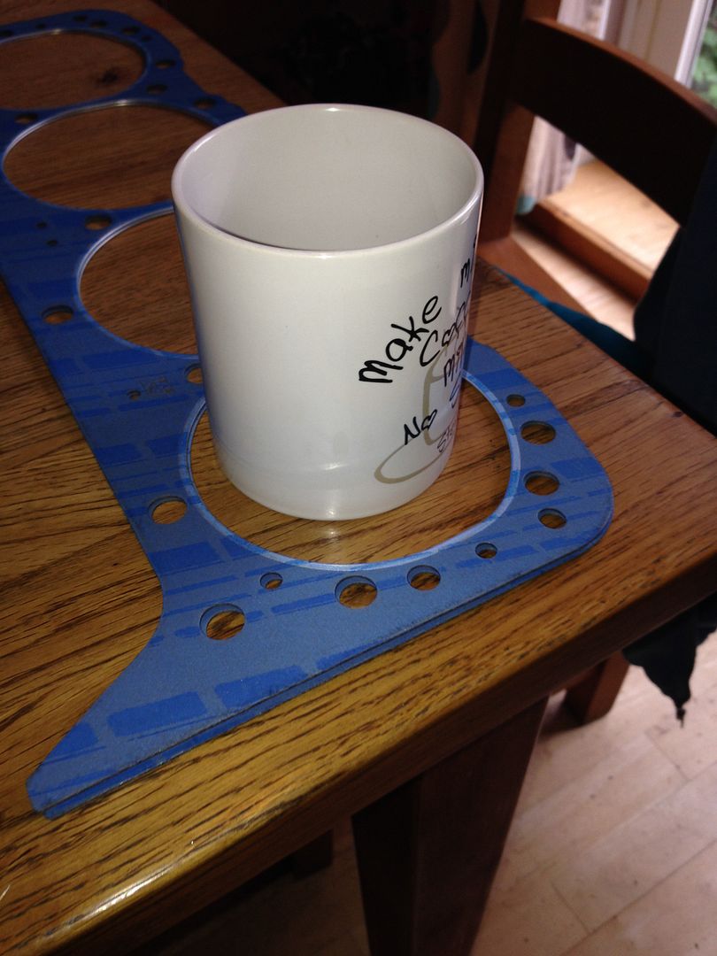

got a phone call today on modifying my drive shafts 4-500 pound EACH !!!!!! dont think so my friend so im gonna buy a couple of bits and machine them my self i aint paying that for some i can do

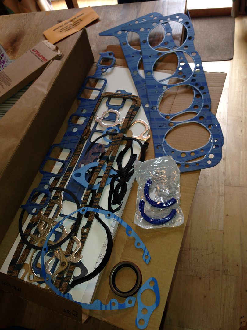

any whoo picked up my full gasket set up today too so altho its gone abit slow at the mo bits are still turning up,
got some more goodies coming from the states too so they should be here beginning of next week pics to follow
