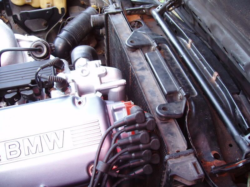

I've fitted an E34 rad from the donor car. With engine in position 3 it is VERY easy so would like to stick with the set up I've got - just not with a leaking rad!!!

DRIFTBOY
Posts: 3131
Post Fri Aug 04, 2006 10:47 pm
That's what I heard too but gave it a go anyway.
It will only work in position 3 (or further back).
All you need to do is replace the left hand E30 radiator lower mount (the bigger one which clips to the bodywork and sticks out towards the right hand side of the car) with another right hand mount (the very small one) in it's place.
I used the E30 top mounting plastic bracket - with cut down rubbers and simply shortened the E34 top and bottom hoses. Photo taken before hoses were attached!
http://i59.photobucket.com/albums/g307/ ... IATOR1.jpg
Put a blow through electric fan on the front of it (had to be put on after fitting the rad from underneath / through the grille).
