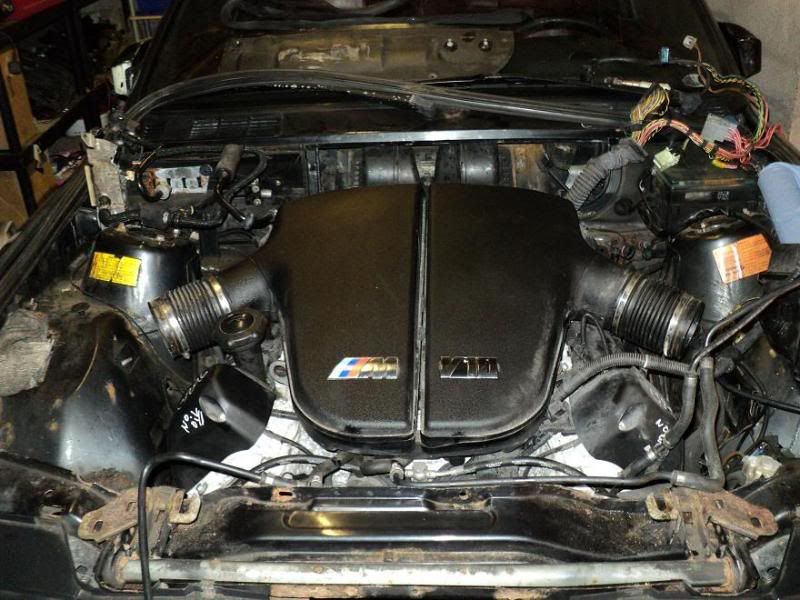

I guess you've already looked at these threads:
http://www.zatzy.com/projekt/338842-joh ... 0-v10.html
http://wp1016621.wp027.webpack.hosteuro ... f01833.htm
In the first case the owner chose to do without power steering and a brake servo due to lack of space. Seems like the other owner retained both.
Anyway good luck to you!

Frenchguy wrote:I guess you've already looked at these threads:
yes, i've read them several times.
i'll be keeping the power steering. probably, i'll modify the cross-member, so that i can position the engine exactly where i want it.

Hi,
Glenn- you will have you work cut out on this one.
Good luck, hope it all works out for you.
After reading through the Zatzy.com thread, it would
seem that their are 'issues' which have been
tackled in different ways.
What Gearbox have you sourced Glenn ? as the E60 V10
was available with a Manual 6 speed in the States so
would be the box of choice, as making the SMG III work
on a E30 would be complex, given all the signals and
sensors you would require.
The S65 M3 Manual would be next as same bolt pattern.
The problem with 'other' Gearboxes that people say are
the same, is they are not.
The 'M' specific G/boxes have superior bushes and some
even have harder shafts etc, to take the Torque these
engines push out.
As can be seen in the Swedish project, he sheared the Gearbox
input shaft clean off, without really trying.
I see he also went for a 'Sintered 3 Plate Tilton Clutch, which
would be fantastic for ripping up the Ashphalt on
your local Track Day, but an absolute nightmare for
every day driving. Would not last long if you started
dragging it, as the sintered Plates are very thin.
500nm of Tourque and you have a Clutch that is either
in or out, I think the standard clutch for the Manual V10 M5
Gearbox would be a much better choice, even if you were
doing the odd Track day.
Seems he also deleted the Vanos, which is more troublesome
on V10's than it ever was on S50 B32 and S54's.
Are you going to delete the Quad Vanos Glenn or retain
it ?
I thought he made a good job of the sump/subframe issues
as reatining the V10 'Dry sump' configuration is more
or less essential as the V10 starves of oil at the top
end due to lateral G-Forces when being pushed hard.
Three oil pumps certainly need their juice.
Not sure how long his Rear Diff and single eared rear mount
will last with all that Torque though !!!!
The rear shafts and diff will need some serious consideration
as Guys with Turbo S14's making circa 400 BHP and a lot
less Torque are known to 'chew' standard Shafts for a
past time.
The Z3M rear shafts etc would be a better bet, but not
sure how they would stand up to the power and Torque
of the V10.
The Guy from the e30.de website seems to have gone a
different route with his rear end and drive train but its
hard to tell from the limited pics what parts he actually
used.
I will be watching your thread with great interest Glenn
and I am sure that once you get into it proper, then it will
all start to come together like a massive 'metal' jigsaw puzzle.
Regards,
The Gorilla.

Not trying to knock this but I believe this is going too far. GermanGorilla has already pointed out a few of my concernes like rear diff/drive shafts.
To makes this a usable car, a LOT of modifications are required IMHO. A lot!

Yes, those are some good points. However, I don't see any other as an issue except the electronics unless, of course, all the traction control and anti-theft things can be reprogrammed away.
Rear axle / shaft / differential problem is quite straightforward to solve with E34 rear axle carrier and special driveshafts from PPF that withstand 1000hp (proven many times). Basically E34 M5 stuff, more info can be found on www.pure-pf.com
After all, when taking on this kind of swap does one really expect to get off without modifying & strengthening "everything"? That's part of the game.. :)

hello dan,
the gearbox (as pictured) is off a e90 m3 v8, as you say, it's the same bolt pattern, so would obviously be the easiest, although not the cheapest!
i'll also be keeping the s85 clutch.
i'm keeping the vanos units, as i will be using the original siemens mss65 ecu.
i too will be making mod's to the crossmember to retain the sump untouched,
i think the swedish guy removed the vanos pump from the sump as he deleted the vanos units.
as for rear drivetrain, i think the 'twin-ear' diff mounting is a must. the e30 rear end is quite robust though, and i'm not saying it doesn't need any modification, but lets see how it copes first, before assuming it cant cope. the rear axle on the white car had been on there for quite a while, and was still perfect, after being abused by the s50, and having had two s62's.
this will be a street car, not a track car. so it wont be having abuse for 100% of it's life. and although having 500bhp, it cant be used for most of the time.
i'm sure the e30 will be fine,
but if it isnt, whatever breaks, i'll modify.......it's what i enjoy doing :D

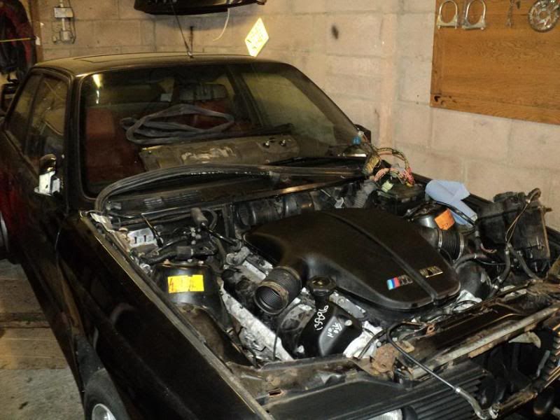

well,
finished removing the s14 this afternoon.
i've also removed the m3 arb, as it's completely in the way of the rear bowl on the sump. looks like i will have to mount an arb in a different position, possibly an e36 evo bar mounted forward, i'll have to get the engine dropped into the bay first then decide how to fit one.
prop has been removed, and i'll get the servo out of the way tomorrow.
i should have enough room then, to have a first 'trial' fit.
it's pretty cold out there today :o: ....plus the rugby's on this afternoon :o:

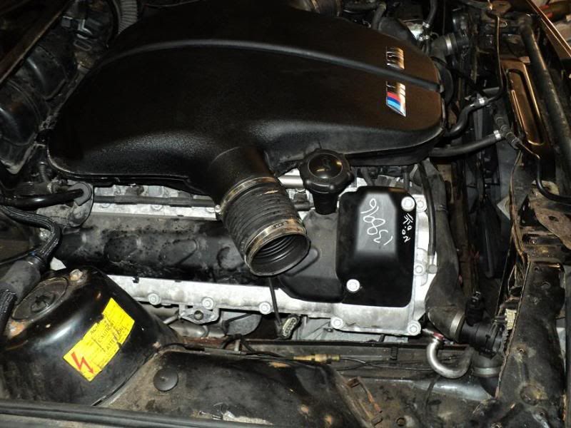

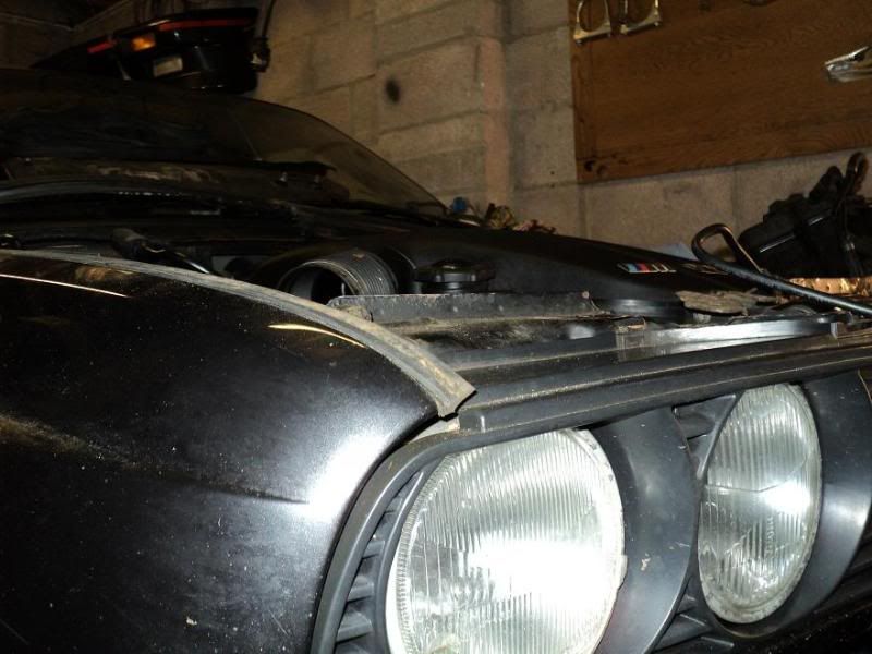

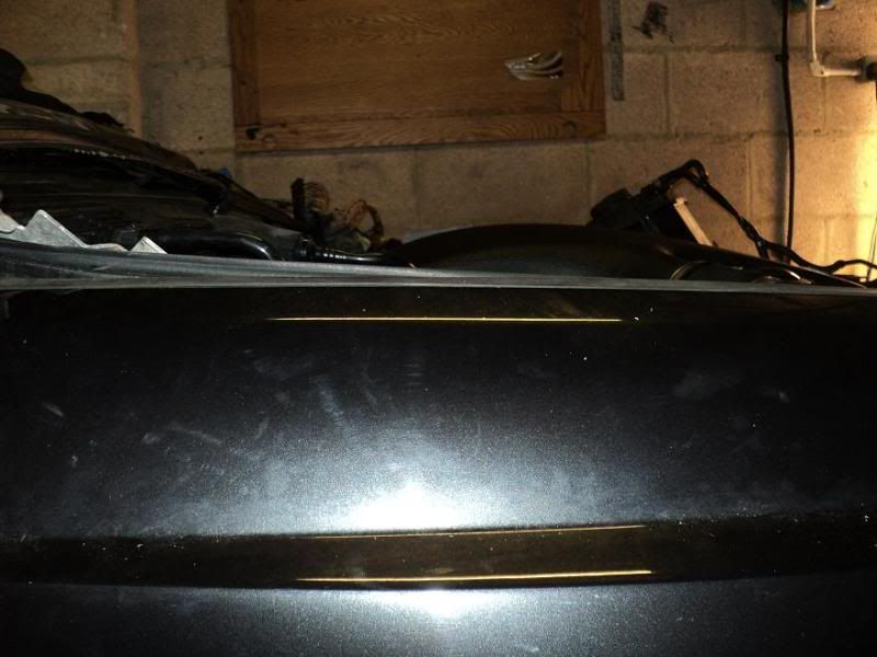

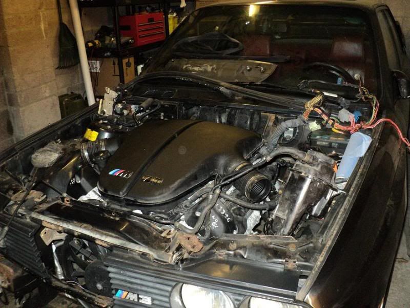

Post Mon Nov 29, 2010 6:38 pm
a few pics of yesterday's efforts.........
Dezzy
CR24v it's a lifestyle
Posts: 11974
Location: Middlesbrough
Post Mon Nov 29, 2010 6:46 pm
It's a squeeze then :eek:
Post Mon Nov 29, 2010 6:52 pm
Loads of room... :eek:
glenn
Engine Transplant Services
Posts: 2196
Post Mon Nov 29, 2010 7:21 pm
Dezzy wrote:It's a squeeze then :eek:
Jhonno wrote:Loads of room...
lol,
8O the clutch was rubbing the bulkhead all the way down, with the front pulleys rubbing the slam panel
