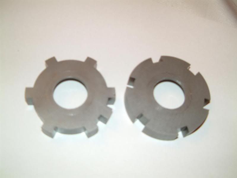

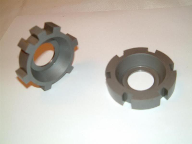

paul, i was waiting for someone to make me a set of camshaft position trigger wheels, that more closly resembled the s50 wheels, but after 7 weeks of promises i took my drawings to a precision engineering workshop who made me these......
The wheels look good Glenn, who did them for you

Sorry for reviving an old thread mates....Quick question, could you guide me as to who manufactured your trigger gears? I'm having a similar swap at my hands, don't want to lock the VANOS. I would appreciate your help with this mate :)
glenn
Engine Transplant Services
Posts: 2196
Post Mon Jul 12, 2010 7:53 pm
neverdies wrote:Sorry for reviving an old thread mates....Quick question, could you guide me as to who manufactured your trigger gears? I'm having a similar swap at my hands, don't want to lock the VANOS. I would appreciate your help with this mate :)
i got a small local precision engineering shop to make them for me. i took them in some drawings of what i wanted, and they made them up for me. they wern't cheap though, i think they were around £190.
