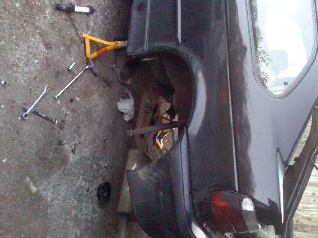

alittle update on progress
i brought a 318ti the other day to take the rear beam off. took some pics as im trying to get into the swing of things.
just wondering if there is anything else i can steal from the E36 318ti?
cheers
cheers

Steering rack..?

ok abit of an update....
things have been abit slow as im trying to by a house at the same time. = banks are assholes.
anyway iv finally got my head back from being port and polished and its looking real good and tidy. iv also got over sized valves which have been ground in...
i now just needing a new cam and the heads complete.
im waiting on cotswold to sort my invoice out so i can buy all the gaskets, seals, bearings ect so i can finish the bottom end.
ps beefy you will get a pm about a set of mounts soonish
and one of my my over crowed garage (random)
