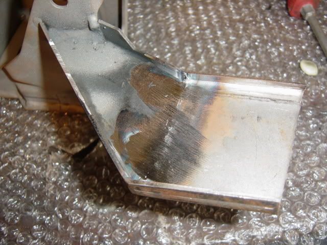

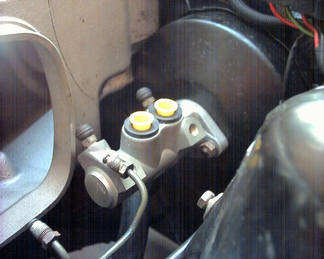

Also, in that last photo, the master cylinder looks a little 'cranked' toward the centre of the car
Jai, the master cylinder is loose. The plates do bolt up square to the bulkhead and the master cylinder will protude at 90 degrees.

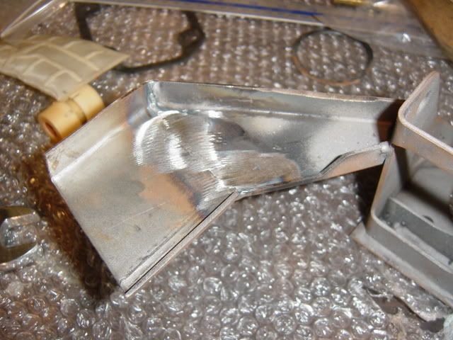

Talking of the plates for the pivot assembly - here they are in rough format. I'll update when I finish them! You'll notice the pivot bracket has been sandblasted :D

that bracket looks the part! should be nice and stiff too! spanner wielding clearance next to the m/c looks tight but not as bad as a lot of new cars!!!
i'm looking forward to each new job i have now as my little brother was GIVEN a sandblasting booth (big enough for a wheel) during a clearout at his work!!! time for shiiiiny bits!!!! just need to get a plating tank now! all your shiny bits have got me all inspired!!!
Hope not too tight, I have spent hours working on this part of the job as I wanted to iron out any niggles so I only had to do the job once :D Hopefully I have taken everything into consideration and it should work perfectly. Where's the fingers crossed emoticon :?

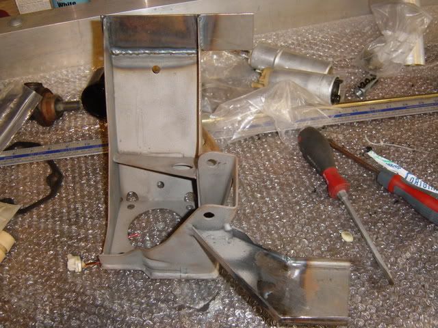

Is that the part that comes into the cabin and supports the pivot mech?
Will you have to use the E34 (longer) pull bar?
Yes, and yes (ish)!
Jai, when that part is finished I'll do some drawings for the modified plates that need welding to it as well as the other plates. I was thinking about designing a bolt together method for those who want to avoid the welding too. We'll see how it goes.
If you lie back under the passenger footwell you can see most of it! Hopefully I'll finish it this week and post some more pics up from inside the car with it in situ.
In total there will be four plates per installation. Two for the bulkhead arrangement and two to make up the pivot bracket properly. Add a few M8x1.0x32mm studs, a longer pull rod, a new bulkhead gasket and servo gasket, a little welding and 8)
There are three options for the pull bar. Cut the E30 item and make a spacer piece with locknuts (pants). Try an E34 item (who knows) or machine a longer end linkage. Personally I think the longer end linkage would be best, that way it can be fitted to the standard e30 bar and adjusted in seconds. The "near side" linkage is standard M10 thread, whereas the "offside" (pedal box end) is reverse cut with a steeper pitch. Therefore I am going to try and make a new nearside linkage which I think would be easier. Need Buster or Matts input here. :thumb:
When you look at the E30 item you'll see there is a huge amount of adjustment, but you could probably only make it an extra 30mm longer safely with the standard links.

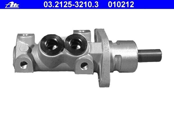

Been trying all afternoon to locate this master cylinder, the best price so far is £176.00. No one seems to have a second hand one.
Well at least i know what it looks like now!

Is this : http://cgi.ebay.co.uk/Brake-Master-Cyli ... dZViewItem
a suitable 23.8mm one (for E30M3 brakes)?

needs to be 25mm
