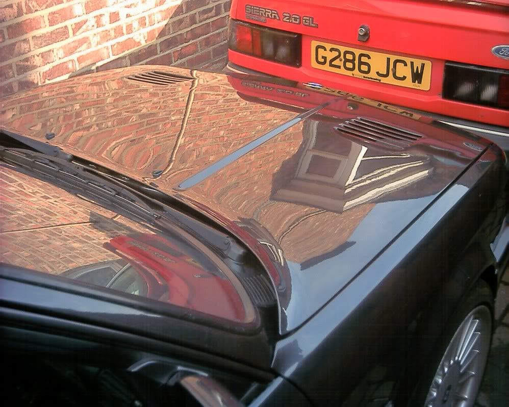

Time for those Halfords bonnet vents Toby :roll: I've watched your threads on M30 and now Turbo, I started my m30 project at the same time and I've only just fittedthe engine! Respect,well done

You could always put in some louvres like mine.

i've just been out to look at mine and i reckon if you drilled an extra hole on the rear bonnet mounting track thingies you could lift the rear of the bonnet by 20-30mm. it may cool or daft... could be quite 70's street racer cool! this would give you a 1" x 36" vent at the top rear edge of the bay so should make quite a difference.
