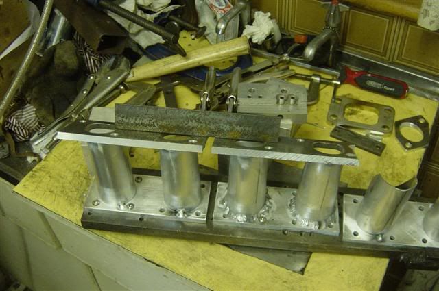

Been burying my head a bit with the eletronics but will need to look at them again soon I think, I'm just not getting it
Anyway, not had an amasingly productive weekend, but have managed to close off one of the inlet manifolds and get another to about 50% completion before running out of gas. Couldn't figure out why the weld just would take on the last one until I flicked the gauge on the bottle which made it drop to zero
So, here's the most complete manifold which just needs injector bosses and fuel rail ties welding on

Just out of intrest has there been much distortion on the plate were it will mate to the head or are you going to skim them in a milleing machine???

Cheers guys, can't wait to get the thing up and running myself!
I'm gonna get the manifolds all jigged up and skimmed to just make sure the angles are all the same, but amasingly the plates have all stayed pretty much dead flat.
All I've been doing is clamping them down to a plank of steel about 3/4" thick which has been doing the trick nicely

That'll be a nice heatsink. I wish I'd done that, mine looked like a curly wurly when I'd finished welding up my runnersTurbo-Brown wrote:All I've been doing is clamping them down to a plank of steel about 3/4" thick which has been doing the trick nicely

Aah, the other thing I've been doing is jigging everything up, clamping to my plank of steel and then putting the whole lot on the gas stove for a while to bring it up to temperature. Makes welding thicker stuff to thinner stuff SO much easier!
Nice gauge of when the metal's ready to weld is touching a piece of wood against it. If the wood gets a scorch mark on it, the metal's ready to weld
