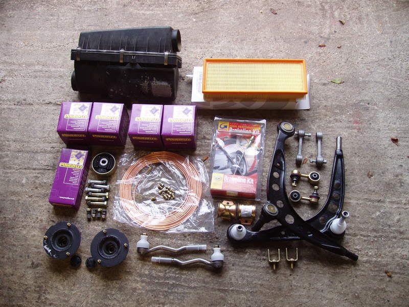

I plan to drop the diff, rear beam anf fuel tank.
Change all bushes and brake pipes and fit my last two Goodridge flexi hoses (the ones that are almost above the tank). Easy peasy! :?
Then re-do all the front stuff.
After reading a couple of air filter tests that someone posted on here where the standard air box with genuine (Mahle) filter element came out best for power I thought I'd try both when I eventually get my car on a dyno.
The K&N cone filter looks faster winkeye , but maybe it isn't! ? We'll see.

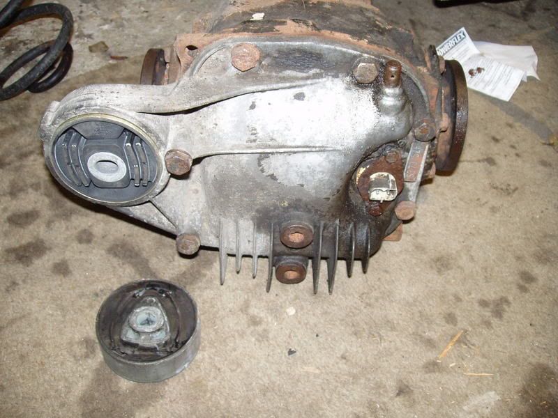

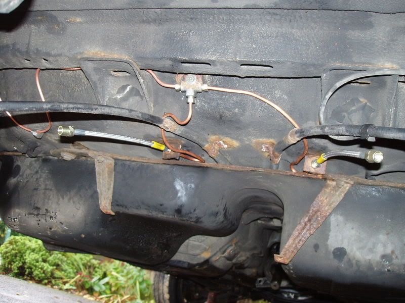

Well, I had quite a productive week off!
I had the rear axle out and replaced loads of stuff!
Z3M diff bush.
Poly beam and trailing arm bushes.
New metal and Goodridge flexi brake pipes.
I also fitted new handbrake shoes which made a surprisingly good difference!
There was lots of swearing, tool throwing, bloody knuckles, cold, wet and dark driveway, increased debt, a disinterested girlfriend and aching limbs to deal with!
But I didn't have to drop the fuel tank down as I thought, the rear brake pipes just loop over the top of it and back again! :D
Just waiting for my H&R anti-roll bar kit to start on the front now!

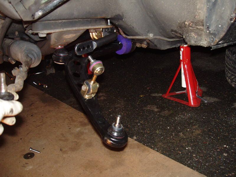

I've just got in from the driveway again, just fitted (but not connected) my rear H&R anti roll bar and new (thicker) rear spring pads, just to take the back end up a few milimeters, which it has.
I have read on here that the flange on the trailing arms bend easily or even break with beefier roll bars on so I made up a couple of reinforcments which I hope to have welded on in the next few days. Then I can fit my new drop links too.
And as I have this week off work :D (starting tomorrow) I will fit my new front suspension bits and sort a few other little things.

Fitted my front H&R anti-roll bar, new wishbones, Polyflex eccentric bushes, drop links and strut top mounts.
I also had a slight mishap :o: with the metal brake pipe that runs from the right hand front flexi, behind the cylinder head and down to the abs module so I had to make a new one of those, fit it and bleed the brakes too!
Not road-tested properly yet as I still have to sort the rear roll bar links and brackets but it felt good, with no clonks or squeaks! Well it flippin' well should do now! :D
