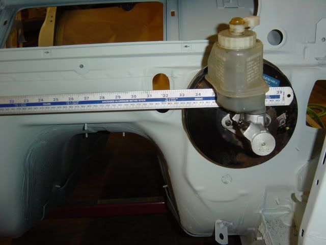

Had a panic today when I realised that I needed to do the servo modifications before the shell was painted
I eventually found a servo from a local breaker last week who was intending to break the MkII Golf donor vehicle today, and he came through thankfully. So my devilish plan was to move the servo over 60mm from the original servo location. That combined with the decrease in diameter Golf servo should hopefully give me enough clearance to avoid cutting the plenum on the S50 engine.
The standard ATE servo is 270mm in diameter. Here's what a standard 325i servo in OEM "position 1" looks like:
This is the Golf servo in "position 1", the servo is 180mm diameter:

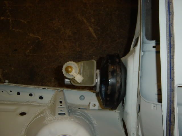

And from above:
This is the new "position 2" moved over by 60mm, I checked on my "spare" E30, and this won't impinge on the glovebox:
And from above:
The new master cylinder is from a 1997 Polo 1.4, unfortunately I don't think it'll work as the connections are not M10x1 and the reservoir is a clip on type with very close ports so may be hard to find a more suitable reservoir. My intention was to find an Audi 200/V8 M/C like Buster has used but just can't find one....yet.
This is what it looks like inside:
I intend to make up a 4mm steel plate drilled to take the servo connections and cut the bulkhead section out completely and reweld into the bulkhead. Then all I need to do is lengthen the brake pull rod by 60mm and adjust the internal servo hanging bracket/pivot and I'm there. Hopefully all this will pay off when the engine goes in
And from above:
And from above:
Many thanks Buster!

Try an E34 brake pull rod. I only moved my servo 25mm, and had to thread and shorten the E34 rod, but 60mm and it may not be far out at all at the standard length.

top work there,i didnt think you'd get it that far over without fouling something.
I wish i had put a bit more thought into mine now and moved mine over that far

Do you think it'll clear the plenum though

yes,i only had to remove a very small amount and i only moved mine 0.5"
With yours over that far you will probably be able to use the e30 master cylinder,but to use it you need to make a spacer for the actuator rod to go inside between the m/s and servo.See the m50 developments thread.

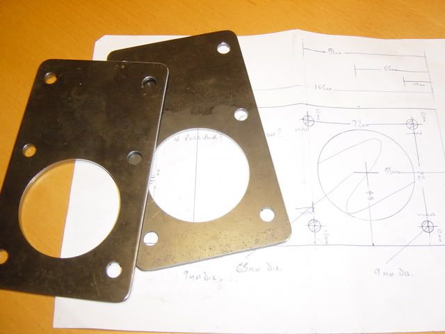

As Brian stated, I am going to try an E34 pushrod first before modifying the E30 item. I've had a look at the spacer required for the E30 cylinder to fit the Golf servo and think I can go one better but we'll have to wait and see until the car comes back from the paintshop.
I have made some plates up which will help relocate the servo mounting and reinforce the area around the bulkhead:
These will have a stud welded through the original part of the bulkhead hole and then be retained by the servo bolts themselves for additional strength. I'm trying to go about this in a way that can be replicated and look factory 'through and through'.
The servo operating pivot which bolots on the inside of the bulkhead also has to be moved over the equivalent amount. For this I am cutting and rewelding the top plate that bolts to the underside of the dashboard metalwork.
All this is really 'under development' but will be plated in goldy colour and finished like an OEM item. No butchery here!
I'm making templates and keeping drawings for all this. Maybe I could help do an article for the forum when it's all complete.

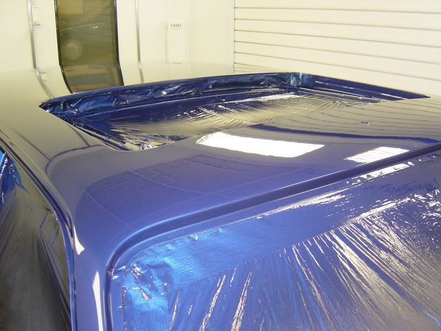

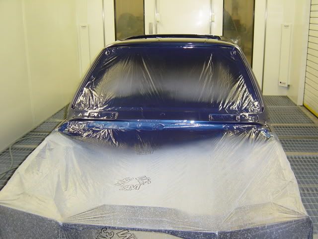

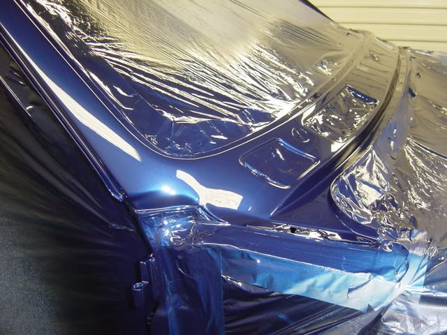

Meanwhile, I took the shell to the paintshop on a trailer, carefully loaded with the telehandler, by mois
I popped in there to drop the new sunroof panel in that had just come from Germany this morning and they had already started on the car. Well, to be fair, they had gone mental on it. It was nearly in bare metal again. All that primer I put on had been taken off ready for a high build coat. When I left I forgot to ask about taking pictures but they phoned me later on this afternoon and tasked ME to come in and take some if I wanted to. A bit of a surprise really! This was how far they had got with it this afternoon:
The 'Camo' look is the sealer coat on top of the primer, these are taken just after the car came out of the oven (I couldn't get there any faster to take the pictures). They resealed the engine bay seams with the spray on stuff aka BMW use and baked the car at 85 degrees C after it was primed just to cure it all. They have also redone all the wheelarches with the same stuff. The oven/spraybooth has an air operated ram that can varying the height of the car as it's being painted, it's also huge. They paint Bentleys from time to time so it has to be!
Now they tell me they are going to paint the entire shell black
Fair play these guys know there stuff. In the background you can see an early Lotus 15, they reckon it's worth 1.2 million

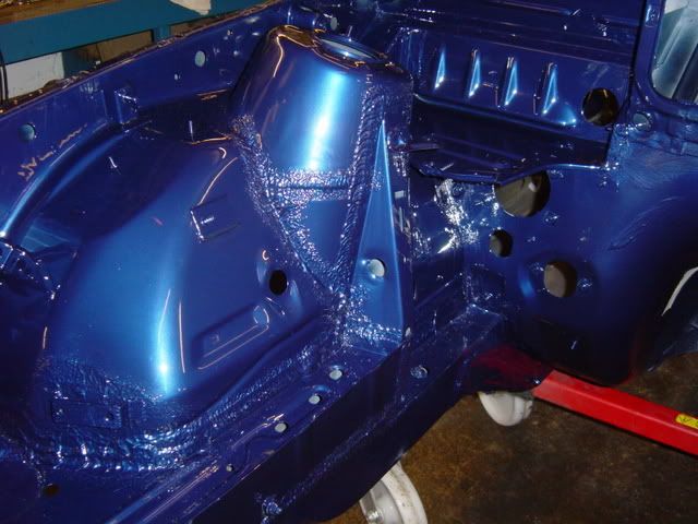

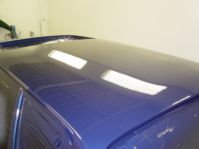

Been a while since I last posted so I guessed it was time for an update
The shell is now painted and waiting to be flatted and polished before they'll let me have it back. The last coat of lacquer went down tonight and I was invited in to take some more pictures.
When I walked into the paint oven I was grinning like a Cheshire cat as you can imagine.
The pearl in the paint really gives it a nice tint. Just as importantly the painters are over the moon with the way it's come out
I think it's an awesome colour in it's own right and I think it will suit the look that I've got in mind for the car too.
