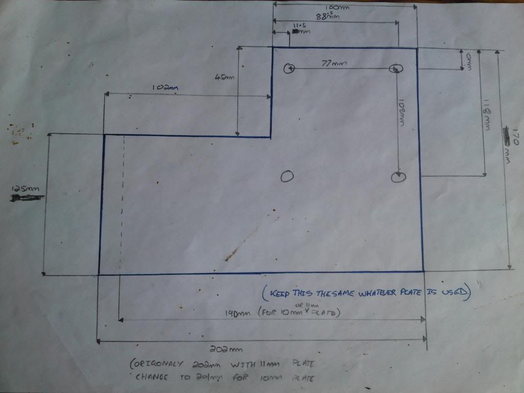

Could probly doit it tomorrow, draw them out take a pic the PM you them with the big images. Hardest bit is boring the hole for the charger to locate on.
They would'nt be the mk2 design either although ive got a good idea which bit needs more material to add a excentric tensioner and save the hassel with the PAS belts.

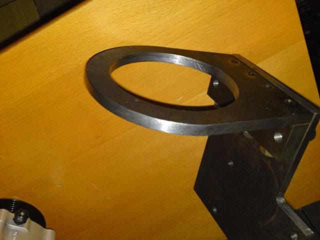

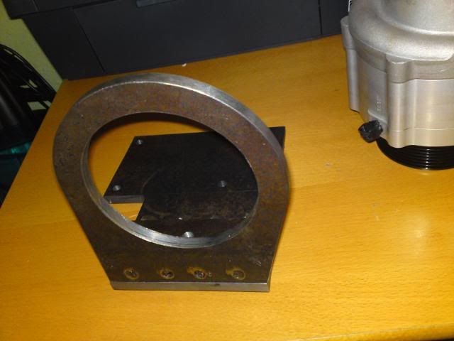

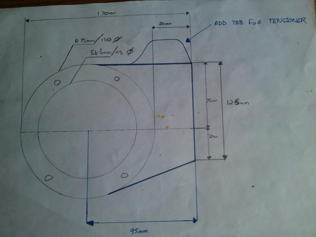

The C30-84 is the one that i now have fitted wether with a largenough pully it would be ok low down i don know * await geoff to update* i think that the largest pully you can get is 110mm but i may be wrong.
at current with this charger mines making 188bhp 5200rpm at 8-10psi (still havent checked with the new charger as the cars SORN at the moment) so if you run it slower you should be able to get that 10psi to be peak at the red line and have a charger that you can afford to get and that as geoff has calculated if you do decided to drop the comp should get or be very close to 300bhp
i'll load the Pics here large and let the zone resize them then anyone can save them who wants them buy clicking and viewing the larger images. mods if thats not ok fee free to adjust/remove.
The bit a the bottom about 202mm or 201mm was because i had some 11mm plate laying around i was going to use but then decided to use 10mm for ease so the dimsions should be 190mm on the inside and 201mm on the ouside.
Miss placed the drawing with the connecting block.
ive left the PCD of the rotrex bolts off as i'm not sure there the same on all sizes but there all on the rotrex website. if you do go with the C30-84 i 'll do another drawing with the possitons for the holes on i did most of the work in my head as i went along and didnt realy wright much down..oops so there may be an odd dimesion missing so if you spot one let me know and i'll get it off mine.
You can use any rubber here doesnt have to be a stadler one
Just a note i designed this to leave one "V" of the 8V pully spare on either side of the pully so that i could fit the thicker plate in and not recess it on the charger side (lots of work) but also keeps the over hand/leverage on the front charger bearing from the belt pulling to a minimum
Edit looking at this now theres afew little mods to add, so i'll do another drawing over the weekend and post it up on monday when i get back form working in irland
theres nothing major just afew little bits.
