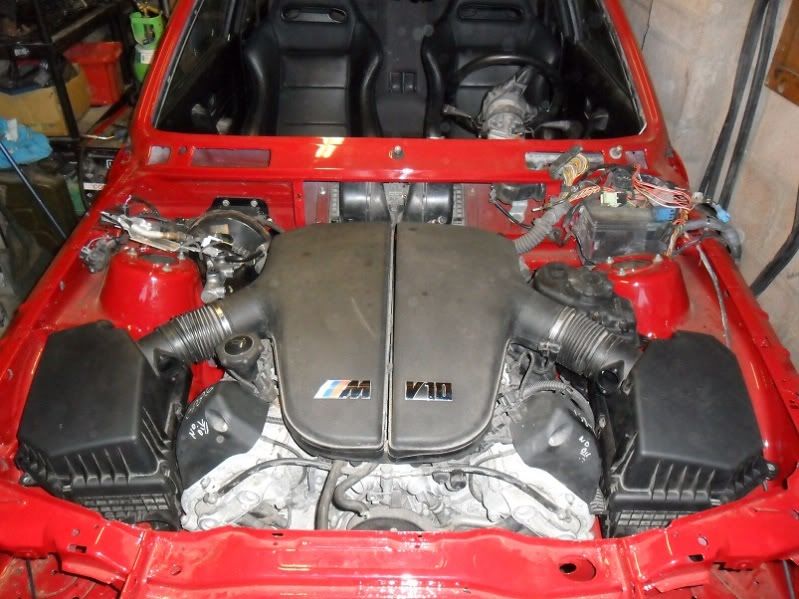

little update...........
been quite busy refitting the engine etc.

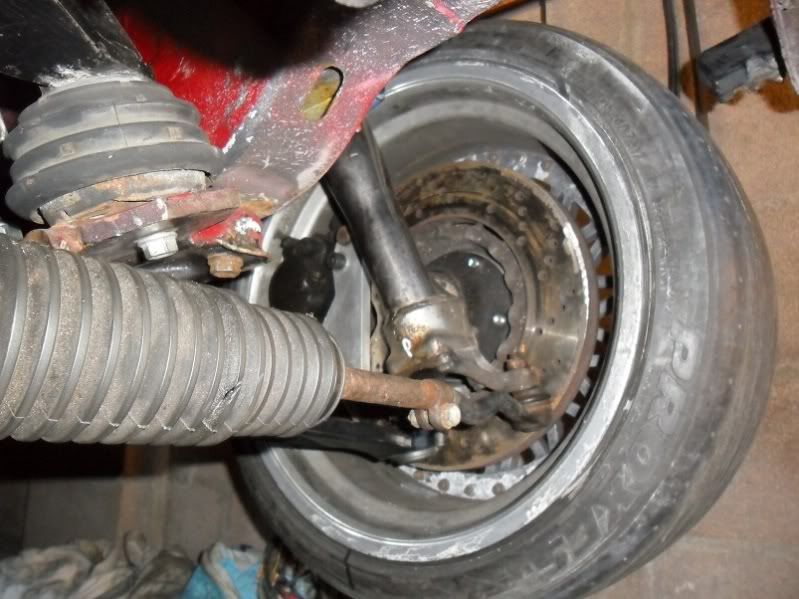

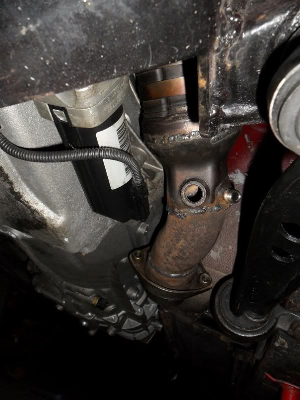

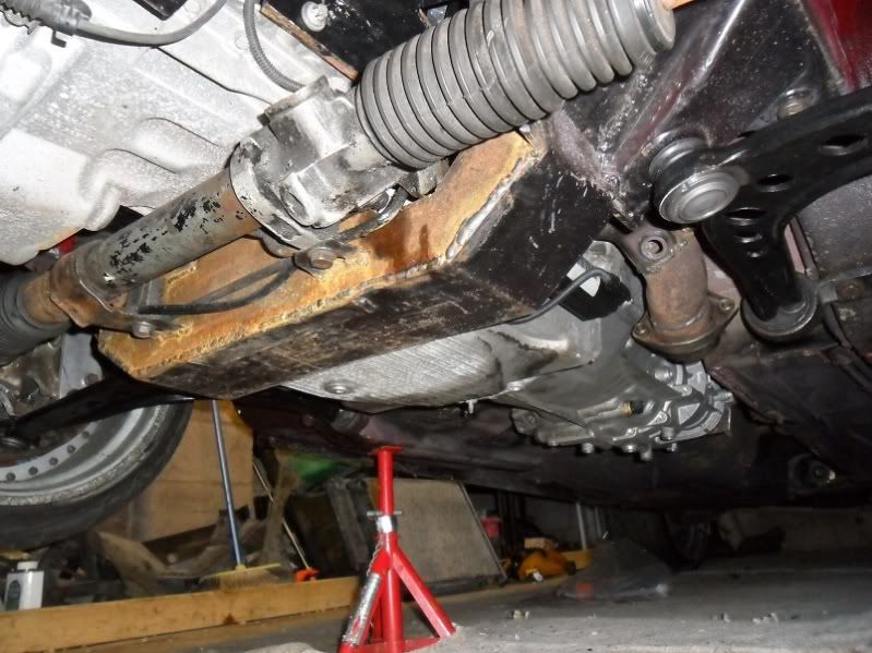

i completely changed the front crossmember, as i wasn't happy enough with the position of the rack. now, the rack is almost back to its original position....well as close as i could get it. it's pretty much in a straight line with the tie-rods.

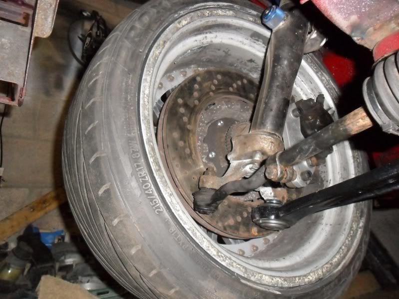

also i've fitted e46 m3 discs/brakes

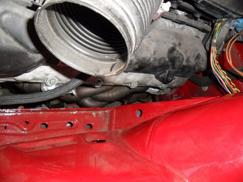

both manifolds refitted, minus the cats...
also fitted modified (lengthend) steering column shaft
most of the interior refitted
happy days ! :D

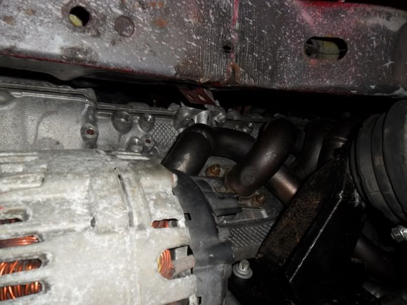

thanks steve.
actually, i found these manifolds much easier than the s62 manifolds, as there seemed to be a little more room between the exhaust ports and the chassis rails with the s85.
plus, with the starter motor being 'inside' the vee, i didn't have that to contend with.
also, unlike the s62/m60 manifolds (two on each side), these manifolds are a one peice item, which i found much easier to work with.
saying all that though, i still picked up a little 'spanner rash' lol,.........

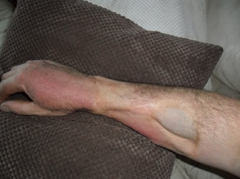

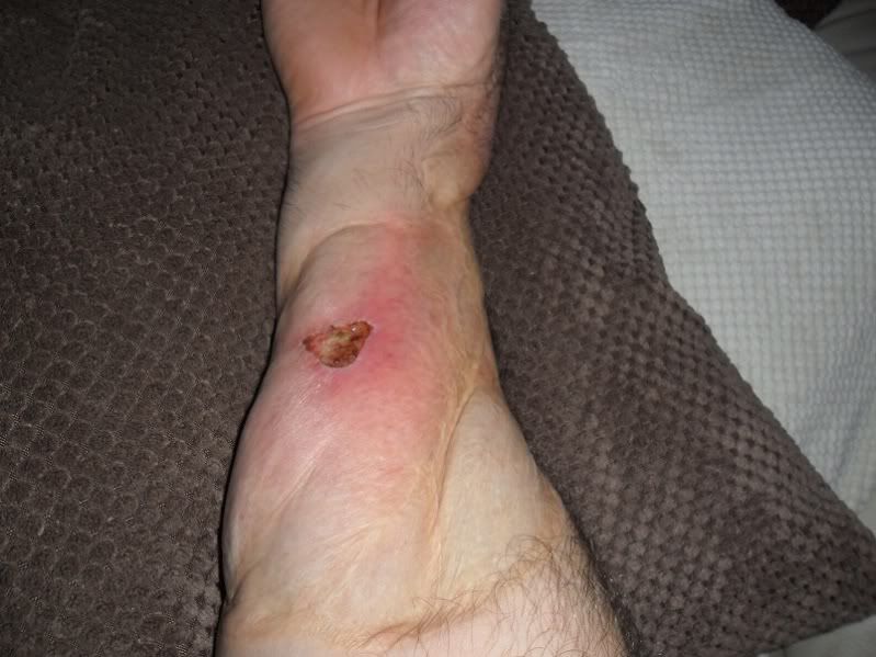

my right arm isn't a pretty sight to start with, but, after fitting the nearside manifold....

Bloody hell Glenn what happened to your arm?! I'm glad you've still got full use of it!
glenn
Engine Transplant Services
Posts: 2198
Post Sun Mar 11, 2012 6:38 pm
that was the result of an accident i had back in 1984.
i was in an open top land rover that i flipped end over end, after hitting a car that pulled out on me. when the land rover landed, upside down, the top of the windscreen landed on the palm of my hand, and then we skidded about 50 yds down the road, needless to say, there wasn't much left inside my hand. so they took tendons and ligaments from my forearm to enable me to move my fingers. then they took a flap of skin off my forearm to cover the back of my hand, and skin off my leg to cover the forearm.
it all works just fine :D

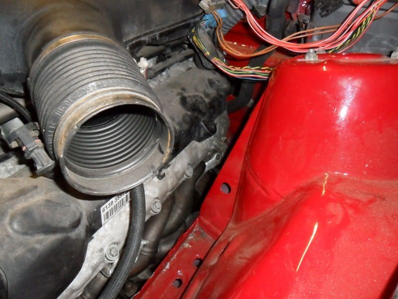

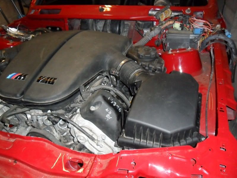

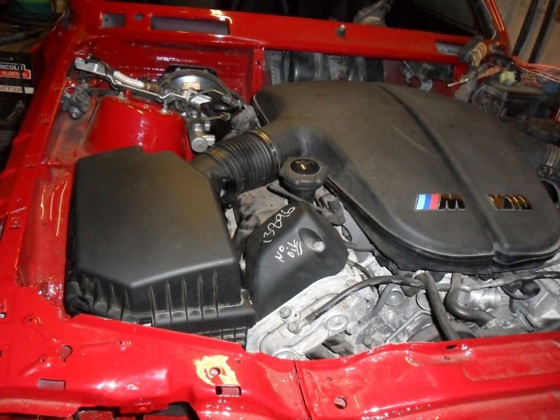

today i've been working on the gear linkage, though not quite finished yet. there isn't much room in there. the back of the gearbox is directly under the hole for the gearstick, so the linkages are very short.
also this week, i've been playing around with the airboxes and the header tank.
the offside airbox is bolted in-place, the neaside will be bolted down this week.
the original m5/m6 header tank can be seen just behind the nearside plenum intake, which is where i plan to mount it, hopefully if i've got enough room, but as with everything on this conversion, the clearences are minimal/tight !

Tight!
Bottom of the airboxs chopped to fit?
glenn
Posts: 2198
Post Sun Mar 18, 2012 8:18 pm
bss325i wrote:Tight!
no barry, the boxes are still full height !,
but basicly i've had to remove one corner to get them to fit. i'll put a pic up once i've finished them.

bss325i wrote:It's surprising how much is fitting into the bay!
thats right barry,
although i might just mount the windscreen washer bottle somewhere else,
just to try and keep it a little neat & tidy in there
Post Mon Mar 19, 2012 8:11 pm
Could mount it in the boot or possibly a small one behind the bumper where the horns normally go.
This is where E46 M3's have theirs.
Where is the ABS unit going?
glenn
Posts: 2198
Post Mon Mar 19, 2012 8:34 pm
i've removed the abs
a small bottle behind the bumper, under the nearside airbox is where i was thinking about, as i'll probably mount the oil filter/oil cooler take-off under the offside airbox.

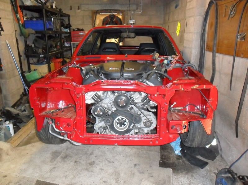

i lowered the engine in from above....but it was tight!
i dont think it will go in from underneath, as the front part of the heads are wider than the chassis rails.
i had to fit the gearbox after the engine was in the bay, but the crossmember has to be removed and the engine has to be lowered deeper into the bay, to enable the gearbox to go on. once the gearbox is mated to the engine, the whole lot can be re-lifted back onto the mountings.
i'm using e46 m3 front discs, with e36 m3 front calipers.
i'll be fitting e46 m3 rear brakes later in the year.
