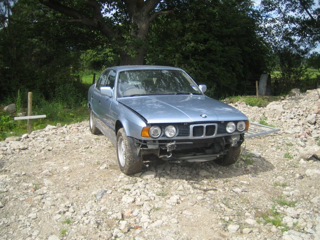

Well went down to the yard where I removed the engine this morning to clear up my mess. Got the engine onto a trailer and towed it home with the volvo. Incidently I discovered today that the volvo has aircon!! lol. I didn't know that. Shows how often I drive it eh? We've only had it about 6 months..

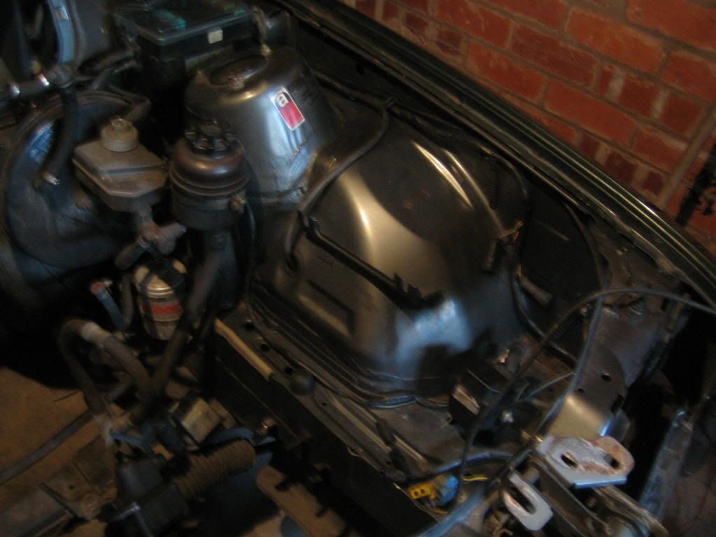

Left the E34 looking like this. It's been violated!

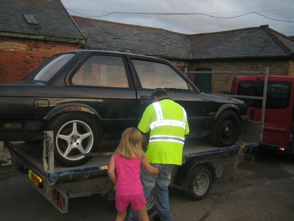

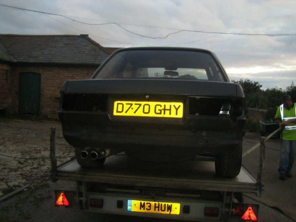

Fri Aug 07, 2009 5:13 pm

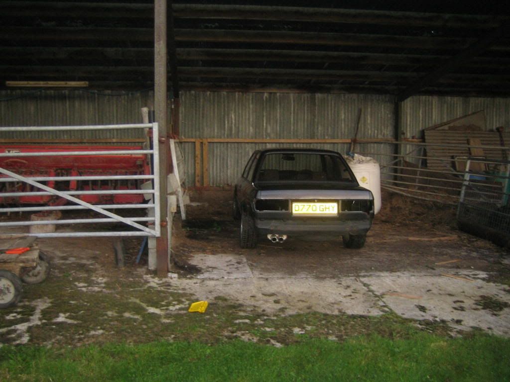

Just bought another donor car. :o: :D
I just can't help myself. :lol:

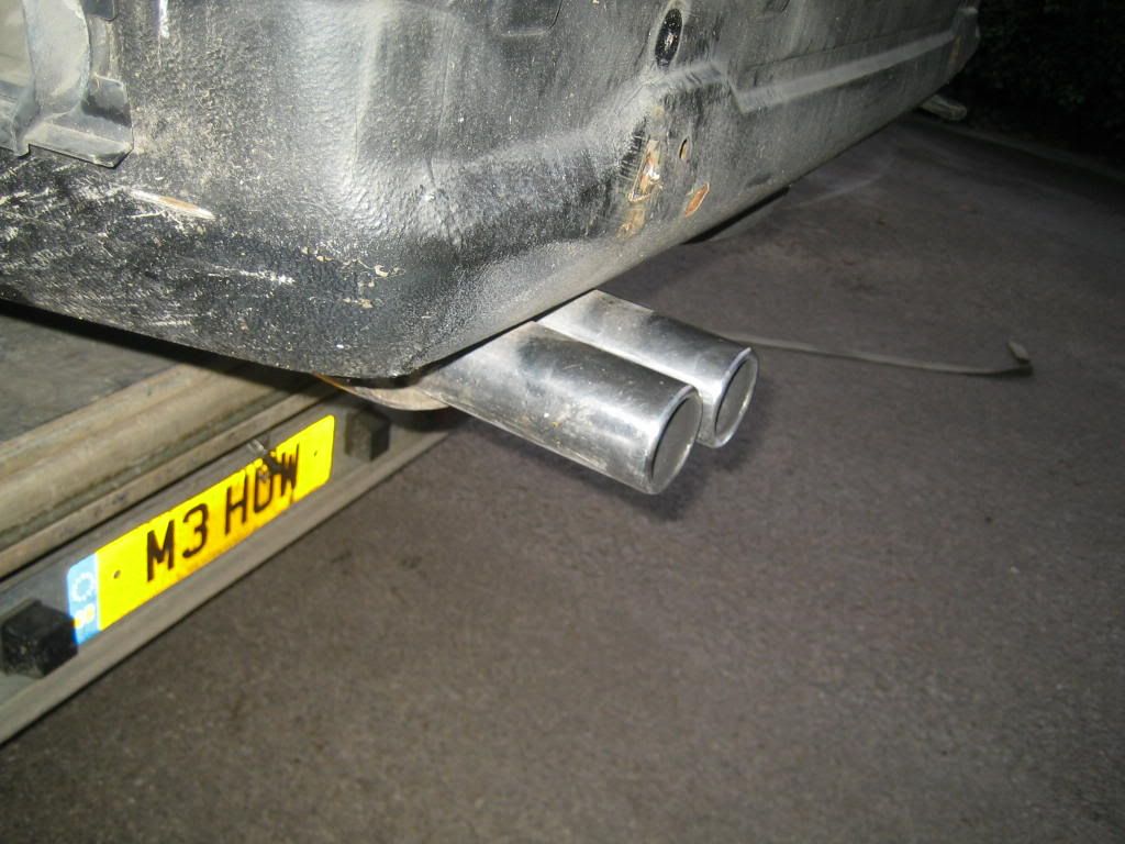

It's an E30 though, 325i 2 door with all the suspension bits I need, a nice zaust, and a whole host of spares for el Chavo. Bonus! It's an early one so it's got the right radiator I need....
Better get that trailer out again.... :roll:
So that's it decided. The M30 is heading for my lovely 318 shell. :cool:

zaust wrote:What's the 2 door shell like winkeye Is it salvageable ??? Want to build another tech 1
I wouldn't really recommend it. There's quite a lot of rust, including patches on the roof aswell as a dent. The engine seems good though. I'll take some pics when I get it home. :)

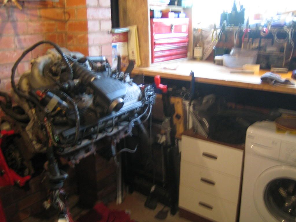

Also managed to remove the monstrosity of a fly wheel and get the engine onto the stand this morning. :)

Had a good old clear up and tried to get a bit organised today. Engine onto a stand and moved right next to my workbench, which had to be cleared of beer bottles, empty glasses, fag buts, rubbish etc etc....

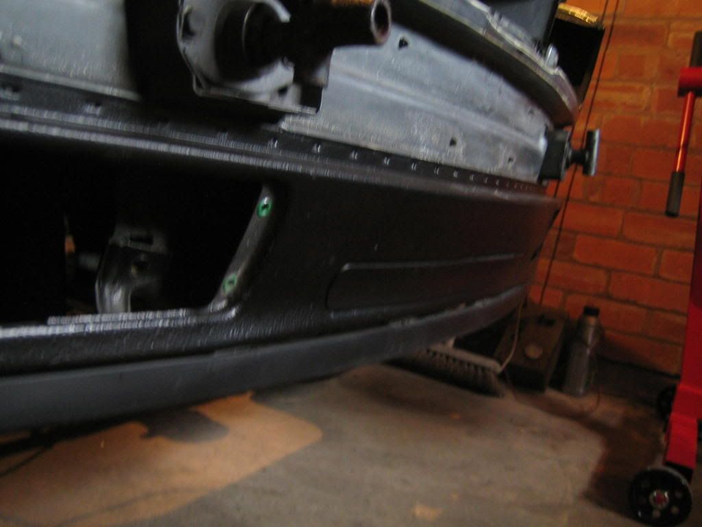

First proper look at the fanimould..
Been doin a bit of cleaning in the bay..
And sprayed bottom half of the valance....

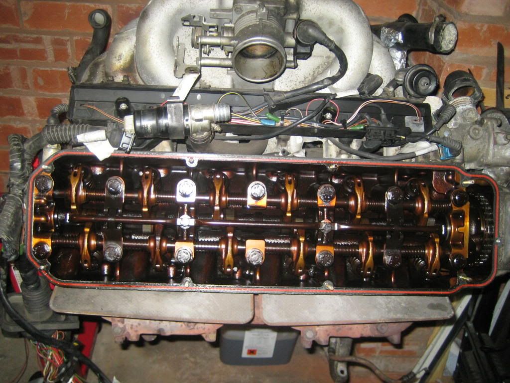

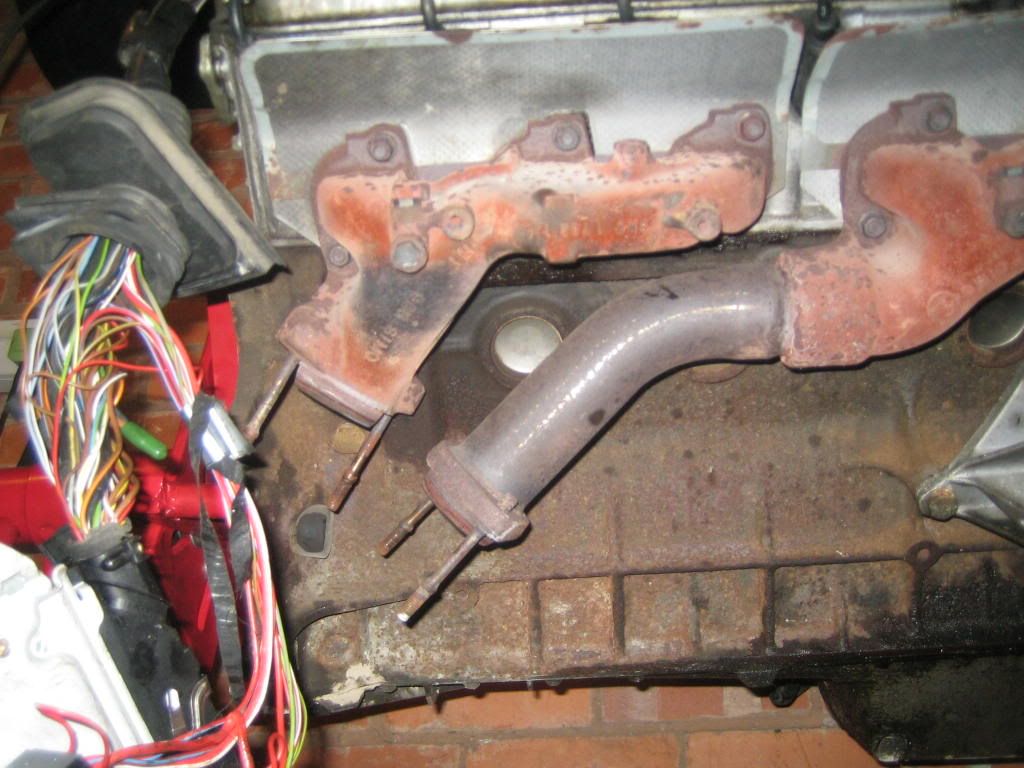

Made a start on work to the motor, breaking myself in with the spraybar mod...

You wont need to touch those manifolds,the flanges are the same as mine and they will 'just' clear the column,i think ive got a pic somewhere to show the clearance but you will be fine
Unless your fitting an E36 rack
Mon Aug 10, 2009 11:52 pm
Or heat up the bottom flange and turn it 90 deg, like i did. winkeye

Just remembered,if i was going to do the m30 swap again i would knock back the fire wall a touch to make way for this part of the manifold,or cut a bit of the heatshield away as mine touches here and makes getting the downpipes on a bit of a struggle along with the bolts
I sprayed the inlet etc using hammerite,i used hammered black on the inlet & rocker,gloss black on the block (was gonna do it silver) and silver for the TB,thermo housing,mounts,oil filter housing etc.
