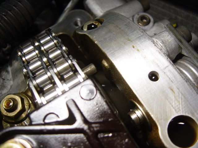

Why would the valve timing be out?
Do you know anything about the engines previous runnings?
I would put some wire down the plug hole of No1 just to make sure the piston is at the top of its stroke, if the crank is at TDC I cant help but think the valves are hitting a piston with the cams where they are. You should be able to see if the cams have been moved by looking at the sprockets, look for clean parts where they have been turned round.

I put a bit of hard flex down the bore and rocked it gently in fourth gear until it was at near enough TDC. The result is there in the pics.Jhonno wrote:Hmmmm.. Mine looks a bit diff..
How did you tuwn the engine in the end?
I'm sure the second pic shows the DC mark on the inlet cam sprocket too. I can't see any reference on the exhaust cam sprocket.

I have a wad.. My pic was TDC.. Cams ae well off! Not in welation to each otha, but out of time with the cwank. Odd. Its tuwns ova atm, but wont catch, doesnt sound like its twying eitha. Has spak and fuel and compwession. Odd pop of flame fwom the inlet also suggests timing

does my pic of my cam timing still show, doesnt load 4 me now.
If both cams are timed right in relation to each other and it is genuinely at TDC then presumably the timing chain or sprocket has slipped at the crank? In the pic above they look like they're a full 180 crank deg out compared to the manual and Oldschool2002's pics!

not 180 out, moe like 45/50 deg..
