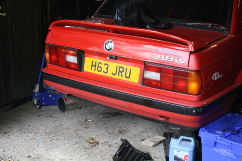

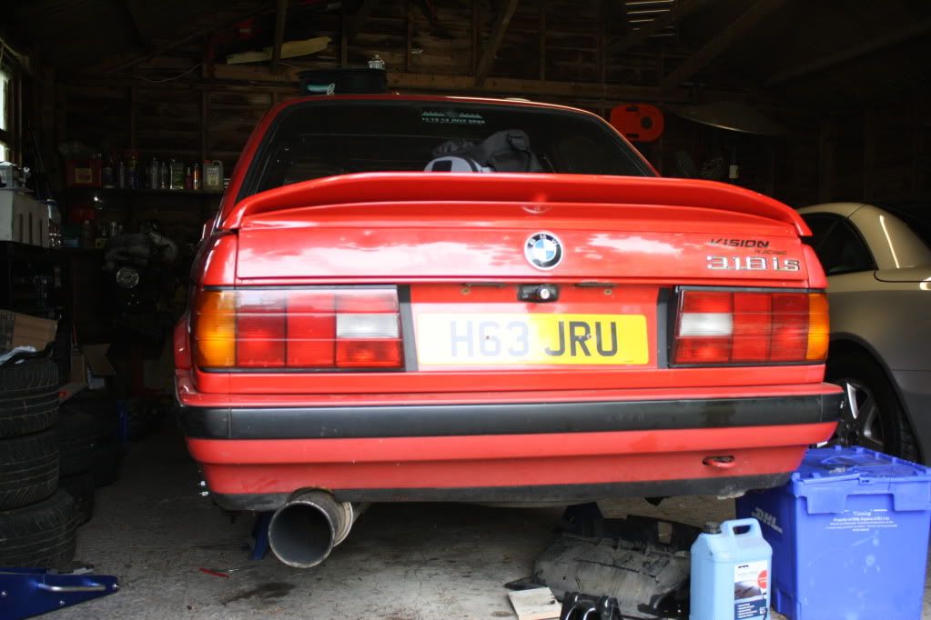

Quickly knocked a bracket up to hold my dipstick tube in place too:

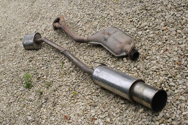

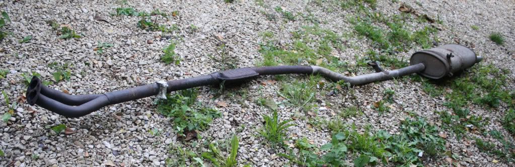

I have also made this redundant:
The centre section has been badly bodged and considering I’m spending all this money on new components, I’m not going to leave this part out. So Magpie hooked me up with this stainless power-flow rear end with BMW front end :)
Not sure how I feel about the bazooka look so may get a freind of mine to chop the tube off and weld a smaller one onski winkeye
Nice 8)

Jesus christ rich thats huge!!!! wait till you go over the first speed bump and off that will come. What size is it by the way? looks like 5" :eek:
Post Fri Jul 31, 2009 8:55 pm
it wont come off trust me winkeye
my car is lowered 4omm on eibachs and it was fine.
did you get it fitted ok in the end?
rix313
Posts: 4967
Location: Silverstone
Post Fri Jul 31, 2009 9:10 pm
LOL, when I get a smaller tube on the back it'll sit higher. No speed bumps between here and the race track any way 8)
One hook is on the mount and the other is currently cable tied just so it's up there. I need to have a look and a faf and get it set up properly

I added a bit to the bottom of that update, I'm taking my spare engine to Turbo-Brown in September to have the brackets for the super charger made up :D
Gearbox is being done Tuesday!!
Exhaust is going to the fabricators tomorrow to be sorted :)

wtf is that rich. get it off there asap mate!

Post Mon Aug 03, 2009 2:09 pm
Wait and see winkeye having the paint can swapped for a 2.5 or 3inch pipe instead, much more nicerer.
