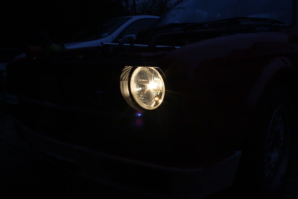

Cool. Give me a bell next time mate. After I hooked in the proper air intake I had much better IATs so I gave her a bunch more advance and she was running really well. Still get some slight resets but noticed that they only happen when I try to run way too little advance (sub 10deg) so with the cooler intakes it's not been a problem which is nice.
Need to get proper H4 replacement light(s) though as it's not gonna pass an MOT with one headlamp removed

Ash I got something coming that will be of some major help RE: head lights, will advise ;)

Ohh what you got? Please be plug and play... The lights is one thing i havent been looking forward to making an adaptor/holder for.rix313 wrote:Ash I got something coming that will be of some major help RE: head lights, will advise ;)
Ill post some pics of the diagrams up when i get a chance. You just need to add a loom for the map sensor and the manifold temp iirc.

Ric - keep us posted on the lights

It isn't looking pretty at the moment lol! gashed up a set of headlights so far doing R&D, just waiting for my new lighting units which should be here by the end of the week and I can then get some pictures up and report backappletree wrote:Ohh what you got? Please be plug and play... The lights is one thing i havent been looking forward to making an adaptor/holder for.rix313 wrote:Ash I got something coming that will be of some major help RE: head lights, will advise ;)

Nice! so is that dip, main and sides then?
