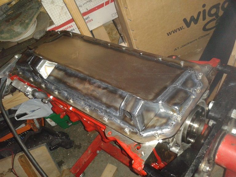

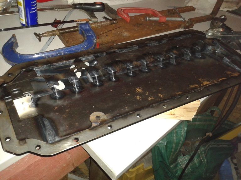

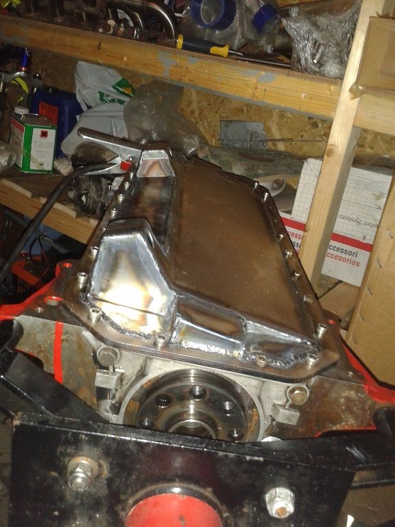

Bit more welding done this weekend, The sump has taken on a bit of a bow so the conrod bolts juuuuust clip it now. Nothing a nice thick gasket won't sort :)
Need to make some spacers and other ali parts so that I can finish the front of the sump off.
Got prices for the ali parts, but with a baby due in the next couple of weeks, I'm gonna have to cast them instead! :)

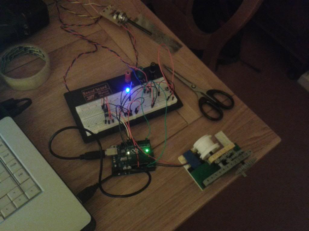

Much internets research and experimenting with the arduino has almost yielded a control system that should do the job.
Wasn't quite as difficult as I'd feared, just lots to absorb! :-)

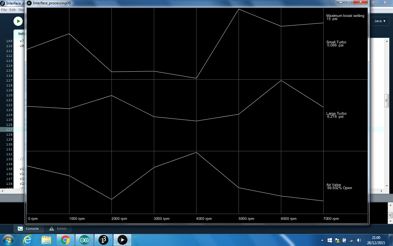

Have finished the mapping software!
Not much to look at, and doesn't cater for traction control yet, but now I know what I'm doing that should be easy.
Wanted to be able to map boost levels on the fly, so with this software, all you do is click on the relevant graph and it instantly maps the value to the ECU.
In the background, boost is also mapped against throttle position.
This may not work at all as an approach (target boost against throttle position) but only one way to find out.
Next step is to make up the actuators and mock up the system.

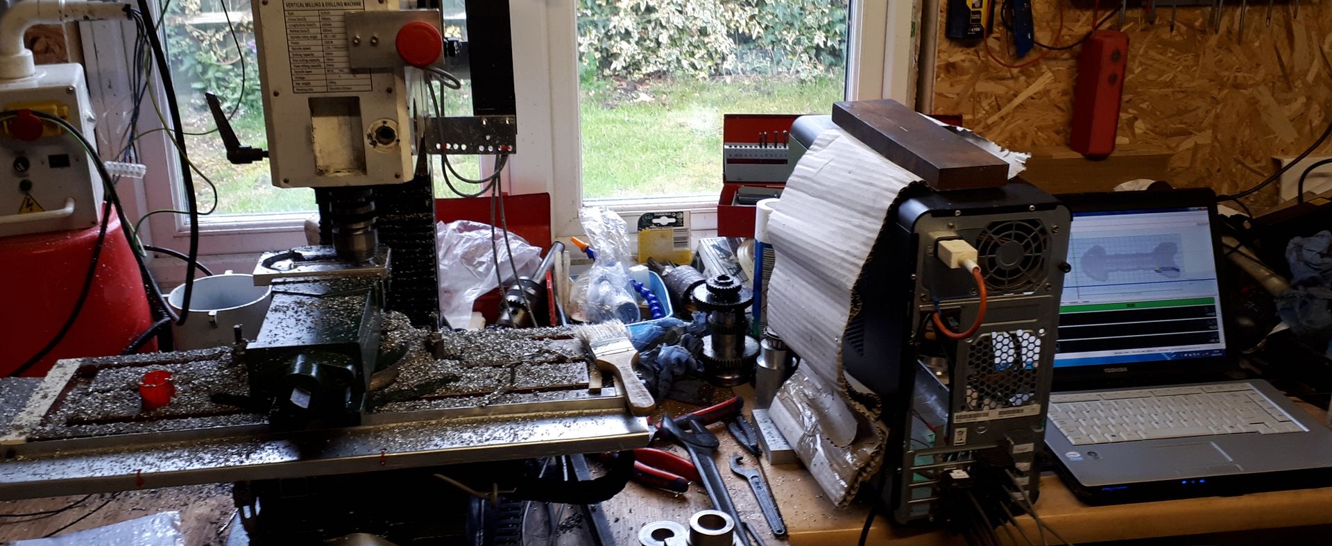

Built myself a CNC milling machine.
Hooray!

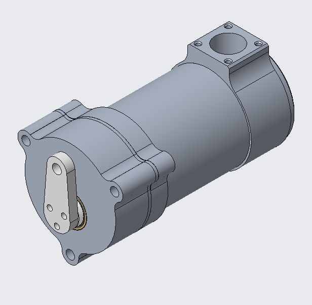

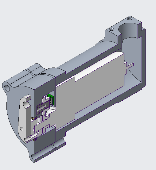

Designed an actuator for the wastegates, air valve and traction control.

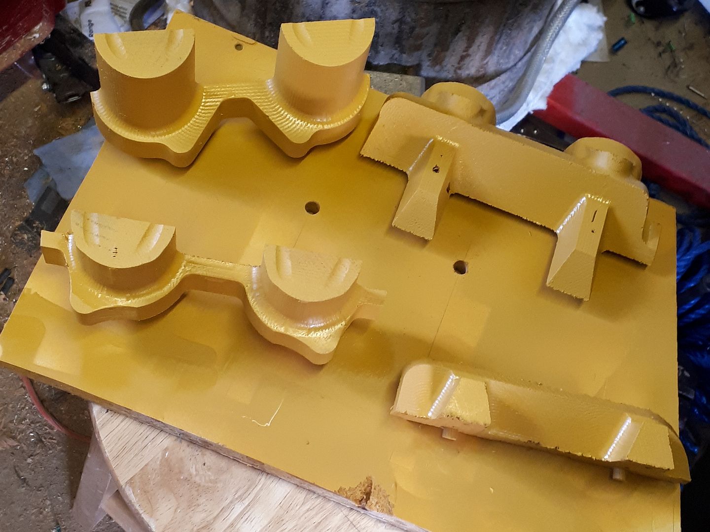

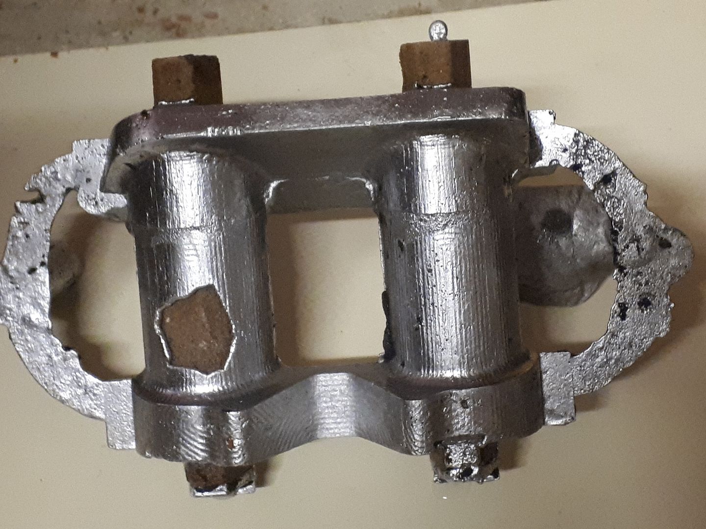

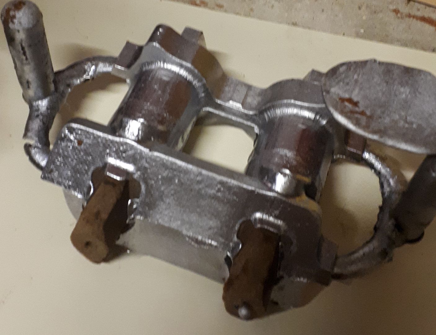

Pattern block for manifold version.....errr 10?

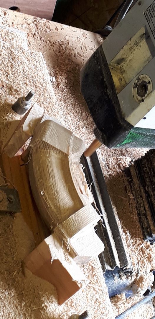

Half a pattern, half machined.

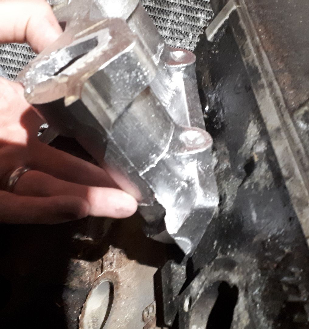

Tue May 07, 2019 6:59 am
Just needs smoothing and a lick of paint:)

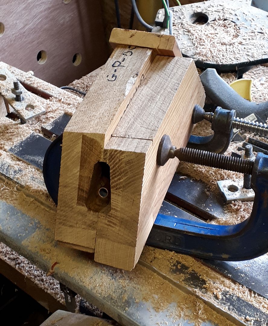

Sat May 11, 2019 9:58 pm

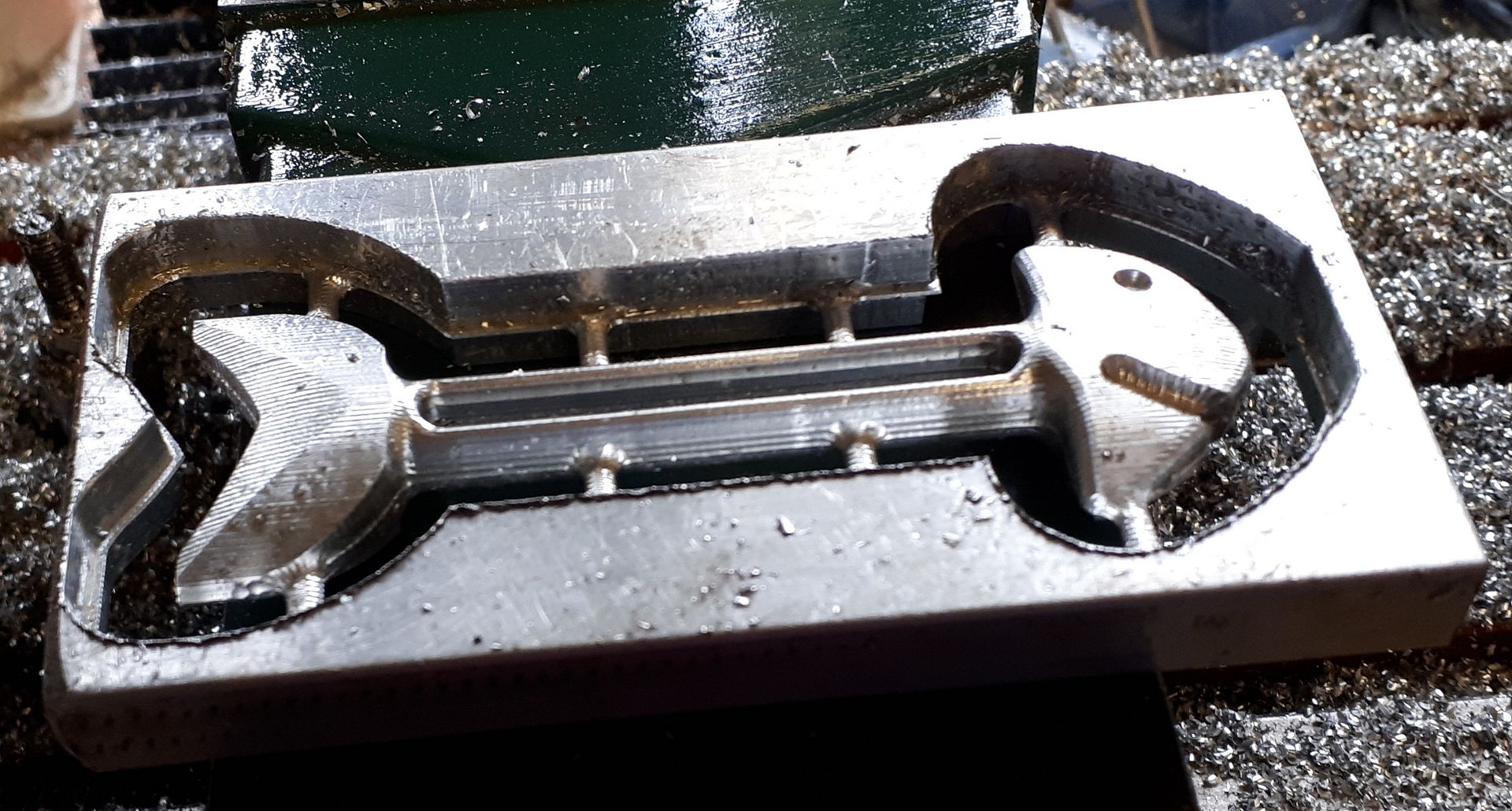

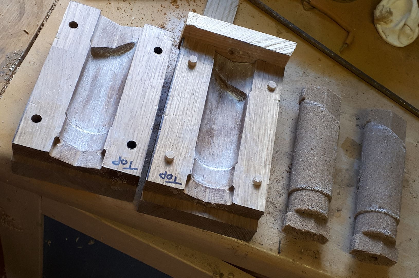

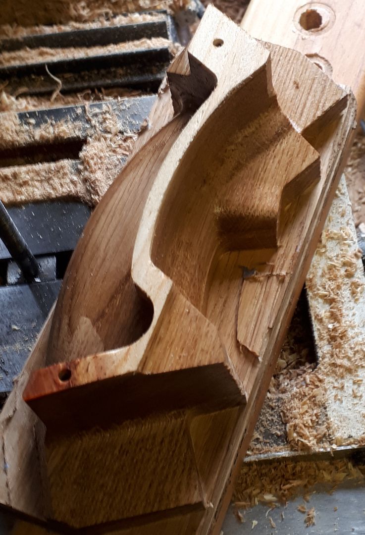

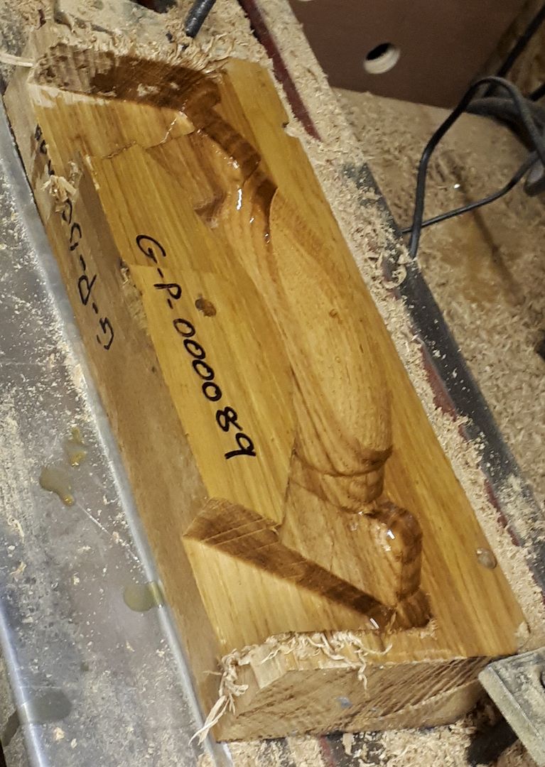

Core box half

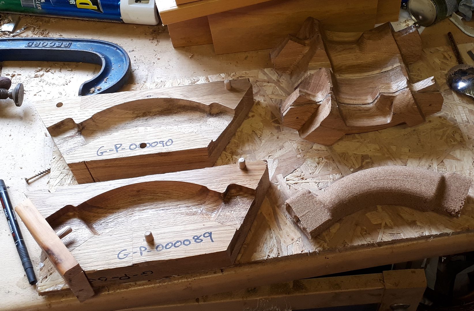

Sat May 18, 2019 3:33 pm

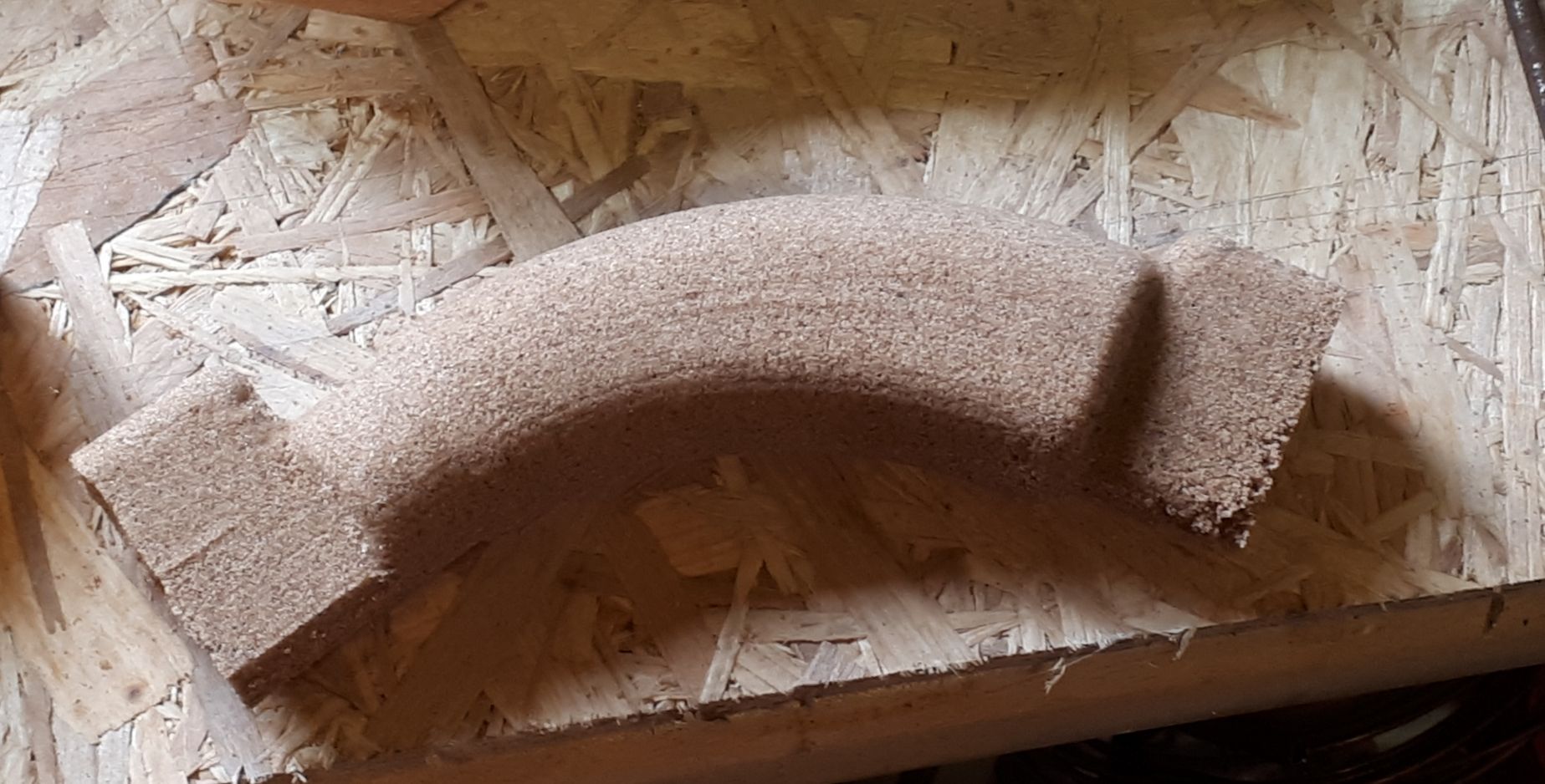

The power of CNC is amazing, can't even see the split line in the finished core

those cores look like pretty good quality (i used to work in a core shop in a foundry),
looking forward to some more updates.

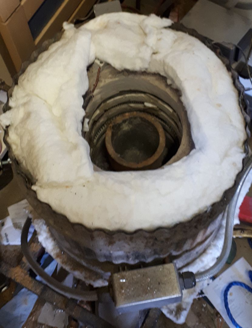

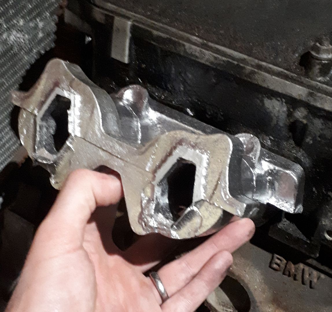

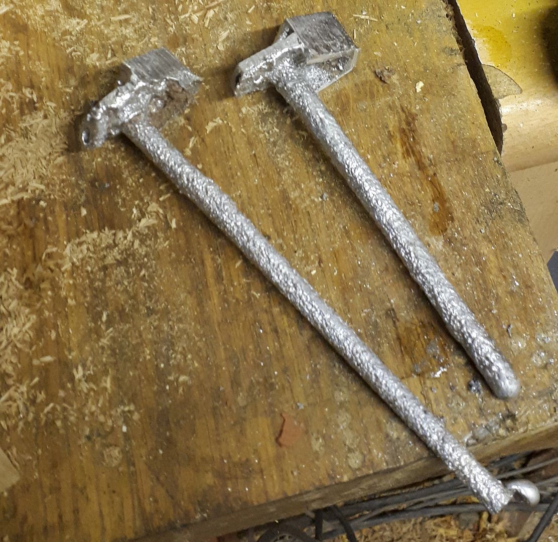

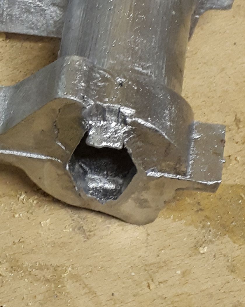

Sun Jun 30, 2019 10:15 am

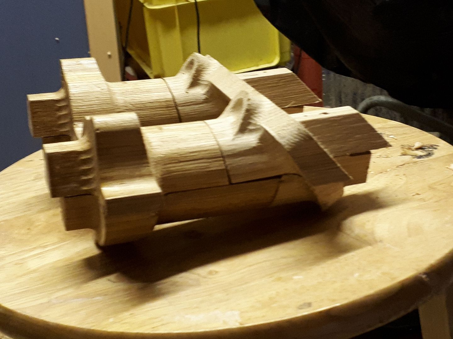

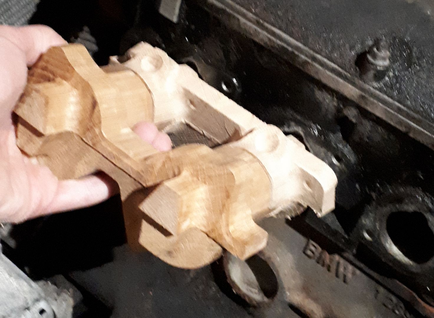

Found a fatal design flaw with the curved manifold; didn't leave enough room to get an air box on! :roll:
Gone back to a design I've made a few times over the years.
Took me a loooong time to figure out how to break the pattern down to be casting friendly!
Finished the core boxes last night, need to fix the furnace next and see where we end up :D

Wed Jul 03, 2019 9:00 pm
Core boxes done and tested :-)
And furnace fixed...hopefully!

Furnace worked almost flawlessly tonight. Did trip the RCBO once, but was fine after that. Poured when the furnace reached 730C.
Couple of defects :-(
The bottom of one runner didn't fill, and there's a funny step in a thicker part of the casting which shouldn't be there!
Somehow, managed to cast some 1/4" rods!
These are the core vents!
Amazed that metal would go all the way into a the core prints and back down the vent but not fill all of the casting!
Good news is that the shrinkage allowance seems to be just about right.
The casting is way too heavy so need to machine the pattern down and thin out the flanges! Almost ran out of metal from the crucible!
