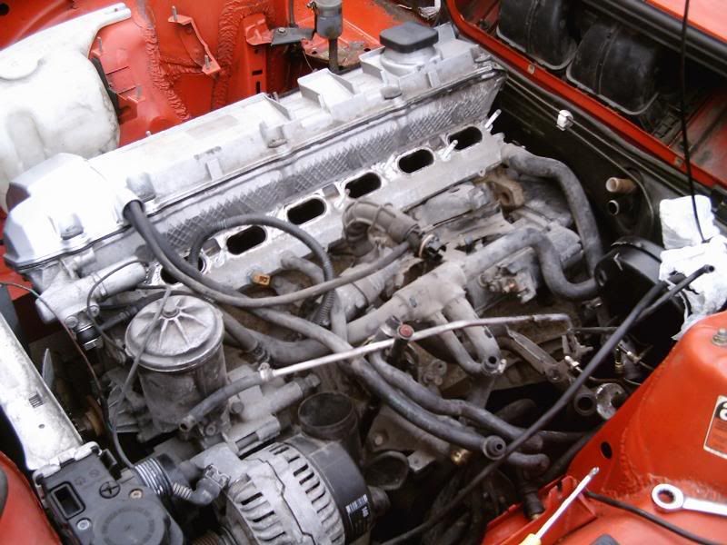

*******QUESTION***********
I have 2 two pin female connectors left..which i presume one is the air temp sensor on underside of inlet and other is my spare water temp sensor which i had to wire direct..question is which one is the air temp..the brown and grey or the brown and brown/pink
any idea :D
