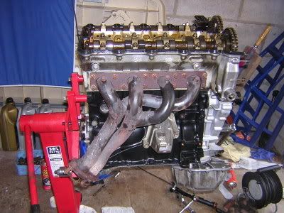

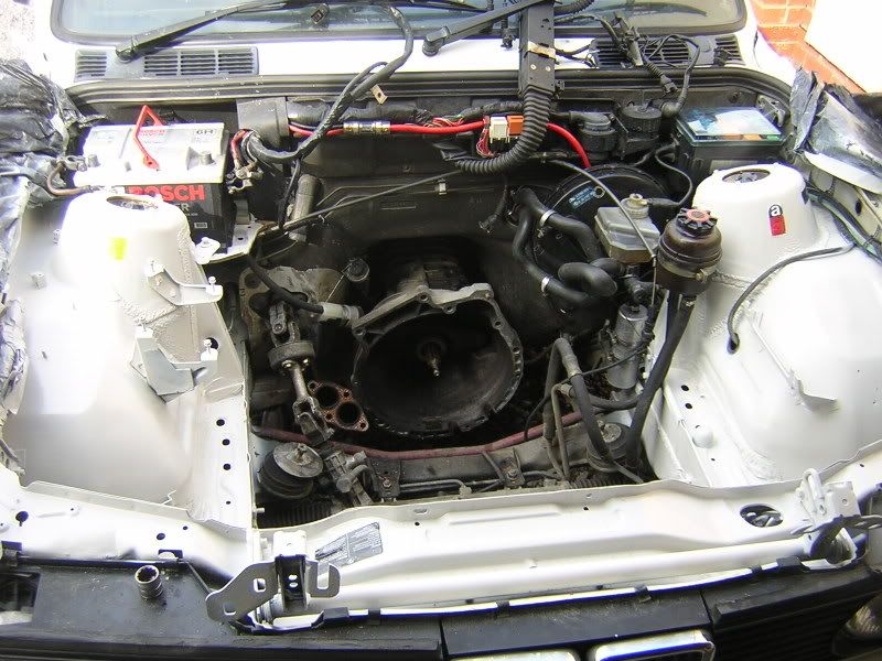

Here's some pics:
The beginning
Painted engine bay
Bench build (before cleaning the head and sparying exh manifold etc)
Block in

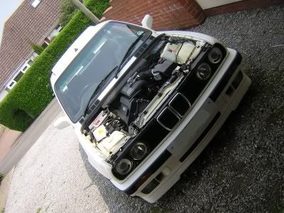

Post Sat Jul 01, 2006 10:43 pm
thought i'd do a quick update as i had a great day on the car today. Had the car running on the throttle bodies for the first time today :cool:
here's a pic:
The car is a rocket with the ITBs on. feels very fast and makes a great noise. very loud though, need to quieten her down a bit, but i ran without inlet pipe and air filter today as i only had a quick drive down the street so hopefully it will be a bit quieter when finished! the fuel rail needs some work as the injectors aren't quite in level and the injector seals are letting air in. throttle cable clip needs a bit of tweaking too, and need to figure out what i'll do for an idle, otherwise everything's pretty much spot on. it really is very quick now, has so much at the top end now, feels like it jsut wants to keep on revving. the sound is very m3-like.
also been working on the cylinder head, have a late m42 head that i'm going to flow and add piper cams to. will put up pics later.
