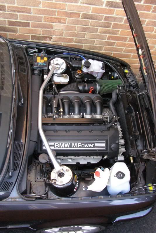

brian325i
Posts: 308
Location: Cork-Ireland
Sun Apr 08, 2007 2:56 pm
m3 engine into e30 and range rover into a bog..you like getting your self into sticky situations id say..
any pics of engine sitting mint in the bay with bonnet off..and all auxillaries connected..if so can i rob it for my wallpaper..
thinkin of gettin a m power cover for my m50..ya knoe the american one..cheeky i know and fake i know but its as close as ill get while being a student :D
fairplay to ya for doing the conversion

Heres the m3 disk etc :
Ooops,dont laugh,had a few runs in the hammerite on the backing plates ! Many thanks to Dameon for them :cheers: :
Oh still need some pads though.I've ordered ebc redstuff.I have fitted the proper disk retaining bolts but i just wound the wheel nuts in also so i dont loose them.
Heres an engine shot for brian,i think at the start of this thread there is a pic with the bonnet off. :

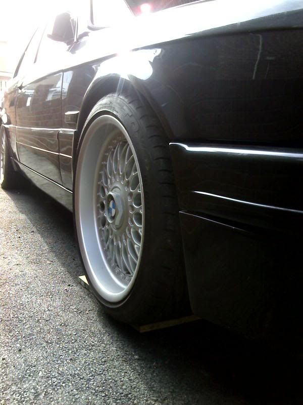

Right ,
got the spacers today.Came in a stupidly large box :mad: :
5mm spacer in place :
It clears the caliper but im concerned now as the bloody wheel is poking out the arch :? :cry: :
Dont know what to do now.They looked as though they may just clear without the spacer but now they stick out.
I wonder if i'd have gotten away with a 3mm spacer.Every little bit counts.Its very close to caliper but with spring off and no spacer it only just cought caliper body.
ANy ideas peeps ?

Simon
Posts: 14936
Location: South Wales
Tue Apr 17, 2007 7:35 pm
Andy, find it strange the wheels rub the caliper too, is this also because of new pads?
Never had any issues when fitted to the M3, but as I said, never got around to fitting new pads to mine!

andy, i cant understand the caliper spring touching the rim :?
as there's hundreds of m3's running these rims.
what about the thickness of material ( on the disc ) where it mounts to the hub?
Wed Apr 18, 2007 12:59 am
they all run spacers as they have the same issue with caliper/wheel contact with new pads

Jhonno wrote:they all run spacers as they have the same issue with caliper/wheel contact with new pads
Space is not such an issue on an M3 though. They have flared arches to accomodate the wider rim/track.

Wed Apr 18, 2007 8:30 am
Simon,
Yeah there brand new pads,and new disks.Only just catch the caliper.
Well the way i see it is :
Option 1.
The wheel only just took the paint off the caliper with no spacer fitted and no spring clip.If i could bin or take it off for a while until pads wear down then i could just grind back the caliper slightly as it is only cast steel and pretty thick.Would this be ok without the spring/retainer clip ?
Option 2.
Machine down the pads enough to get wheel on without spacers.Dont really want to do this,because pads wont last as long and i paid £90 for the buggers !
Option 3.
Roll the arches.
Option 4.
Try a 3mm spacer.
what do you think i should do ? Also does anyone have a 3mm spacer they can sell to me or even lend me to try.These pro spacers were £35 so dont fancy buying more if they dont fit.
On the m3 the 5mm spacer wouldn't be a problem as Ian said,because of the wider arches.
Your help appreciated guys,
cheers,
andy
Wed Apr 18, 2007 8:47 am
yup, was just clarifyin tho that M3's do have the same issue but as you say can get away with it as they have the wider arches to start with.
Rolling the arches will prob be your best best.. What size tyres are you running?
buster
Posts: 3779
Wed Apr 18, 2007 8:48 am
215 40 17,same as whats on my old wheels,but 8j rim.
Backs are 245 35 17.
Really dont want to roll them though.
Yours look quite close in your sig,no problems or is it a decieving picture ?
Wed Apr 18, 2007 9:05 am
im running et20 16x7.5 with a 205/50 tyre.. I Might be able to squeeze 225's under there, but i'd have to roll the arch
there isnt loads of room in there tho

Wed Apr 18, 2007 9:25 am
Andy, mine dont seem to stick out as much as yours and I think our setup is the same. I do seem to have quite a bit of toe-in though. Whats the offset of your front wheels?
I remember having to grind down the retaining springs slightly but cant remember if that was before or after fitting the spacers.

buster
Posts: 3779
Wed Apr 18, 2007 9:41 am
Hi Sandy,
Yours looks like its got far more clearance than mine.I've just checked the etk and my wheels are from an e31 (8 series) and the front wheels are et 10.
The photo below of mine with no spacer looks ok :
But after the spacer not so good.but i have just remembered something.When i took the photo from above the car the suspension hadn't settled properly as i had just fitted new springs and hadn't quite lowered it off the jack.Also,i wonder if it makes a differance that i've fitted m3 eccentric control arm bushes ?
bigpimpin
Posts: 691
Location: Aberdeenshire
Thu Apr 19, 2007 10:10 am
Andy, my fronts are ET 20mm so that'll give me 10mm extra clearance than you from the calipers (if its positive offset)
But in theory this would also mean your wheels should have more clearance at the arches as they sit 10mm closer to the hub? :mad:

buster
Posts: 3779
Thu Apr 19, 2007 10:46 am
Well i've lowered it down (have taken pictures but photofuckit doesnt seem to be uploading) and it has sat in better but still very close.As you pointed out above the offset should give more arch clearance but need a 10 mm spacer just to be the same as yours.Im very confused now.Im going to go and check what the wheels have wrote on them.
