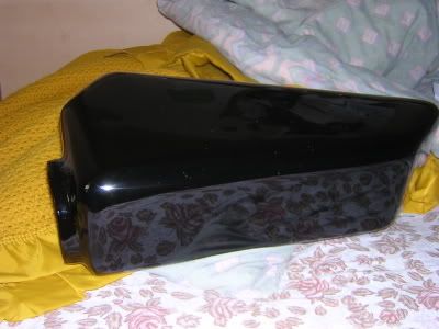

the plenum is pretty good for a first try, i'm well chuffed. did have dome drama earlier in the wkend as my mk1 effort didn't fit - it hit the MC tank. but i've chopped it up and fibreglassed it back together. i've decided to paint it black and have a BMW M Power transfer along the top, with a BMW E36 M3 GT 'BMW motorsport international - limited edition' plaque on the side. didn;t want to fork out for topcoat and lots of labour and experimentation so went for paint. here's the latest pics:
Things kinda worked themselves out really. thought i'd build a fibreglass mockup as a starting point to see how it went, which definitely turned out for the best cos of the orig mockup being too big to fit. The finished item is pretty good so i'm going to run with it for a little while, if not permanently. It's also pretty tough having had a good few layers of fibreglass, and doesn't resonate much due to being so thick and having dynamat resined to the inside. this is in keeping with what i want as cos its a daily i dont want it to be too loud. the trumpets also fit pretty nicely with this setup, and are a decent length, about 5" to the throttle body and 6" to the butterfly.
the afm-plenum bellow has been ordered from bmw, as has the throttle linkage clip, they wouldn't do me the GT plaque without a chassis number, so i had to order from germany. now its just sorting out the breather hoses and an air filter to use (must be something cheap and temporary as it'll probably be discarded when i go to the final MAF setup). also want to put an IAT sensor in the plenum for potential MS use.

am mightily pissed off today though, as went to have a look at the plenum to do some work on getting it smooth and found lumps in it! take a look:
this has happened in a few places. admittedly this is mainly on the side nearest to the heat where i've been drying it out, but is definitely not the filler or paint, feels like the fibreglass! its thick enough that its not really a prob, but i dont want this to happen when its in the engine bay!!! any ideas?

Sounds like the paint you're using is reacting with the resin in the GRP you've made..
If it's really driving you nuts, wait til its in the engine bay, hot and dirty. It'll all bubble off like crazy.
You could strip it all back and first paint with an inhibitor.

yeah think you might right jai. was standard polyester resin though. have taken it in to be painted by the guy i normally use for bodywork, he wants Ԛ£30 to do it. he reckons its the filler reacting with too much thinners in the aerosol, which could also make sense and would explain why its happening around where i've dug out the top layer of fibreglass and filled it. think i shouldn't have dug out the fibreglass in these areas. sods law though, they're going to have a go and make sure its ok under heat etc. so in short not my problem, which is a relief as it was really pissing me off. at least it will look sweet now as will no doubt look better painted by him than by me. was driving me nuts.

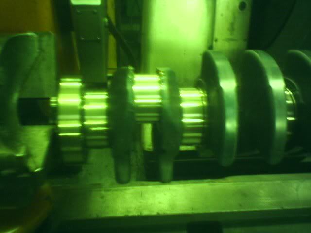

have been to visit the engine at the machinists this morning. the rebuild's costing an absolute fortune (will be Ԛ£700 once complete), but it is about as sexual as an engine block can be. looks brand new, and the bore spacing, which was a bit of a worry going for such large pistons, looks absolutely fine. the reground and modded crank is also a work of art.
only had my phone on me but here are some pics of the crank, tried some of the gorgeous newly modded rods and rebored block (soon to be decked so it will look completely brand new!) but they didn't come out well, the light was terrible in their workshop:
god i'm happy with their work. sadly I'm pretty skint at the mo and am worried that i might have to sell her on. if i got the right offer i'd accept. have had loads of bills come at once this month. i hope it doesn't come to that, i've spent nearly Ԛ£1500 on this block, but just looking at the work and knowing that its one of the very few 2.1l m42s in existence (and imo done more cleverly and to a higher standard than the much more expensive hartge conversions) makes me glad i've gone down this route. i'm sure its going to make huge power! actually with that crank and the CR etc its going to be an absolute torque monster.

plenum:
that's after being sprayed by the bodyshop. unfortunately after a night it bubbled up again just like when I sprayed it, so its back with them again! in a weird way feel a bit vindicated that they had the same problem - at least it wasn't my painting skills! bit worried about whether they're gonna be able to sort it.

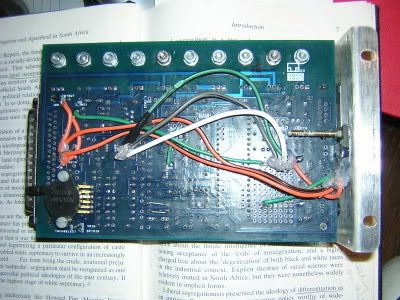

much more exciting is the megasquirt, and i owe a lot of thanks to ant for answering my emails! what a gent!
so now the car will now start on megasquirt! not many pics, but you can see the mods I've had to do to the MS to tailor it to our configuration:

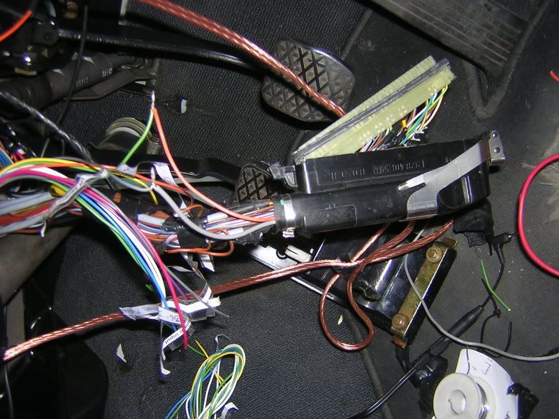

and a wiring mess photo
so far I've managed to wire it all in, sharing all the sensors with the motronic. I've made it so that to swap to MS requires simply uplugging two molex connectors from the motronic and into the Megasquirt, takes like 10 secs. means i can still drive the car around on motronic for now, and test just fuel or just sparks on the MS. It works pretty well using MS for fuel and motronic for spark at the mo, that's about it though. this is an interesting proposition really. sparks and idle on MS are still a bit dodgy. I'm struggling to get MS to control our idle, but only started on that today and got dragged away to the pub with omi for most of the daytime (well thats my excuse anyway). at the mo it surges between 500ish/stalling and 1000rpm, mb not quite so drastic but still pretty shit. i'm pretty much at a loss as to why its doing that, need to do some research and annoy ant some more. i hope i don't have to revert to using the throttle stop to control idle.
