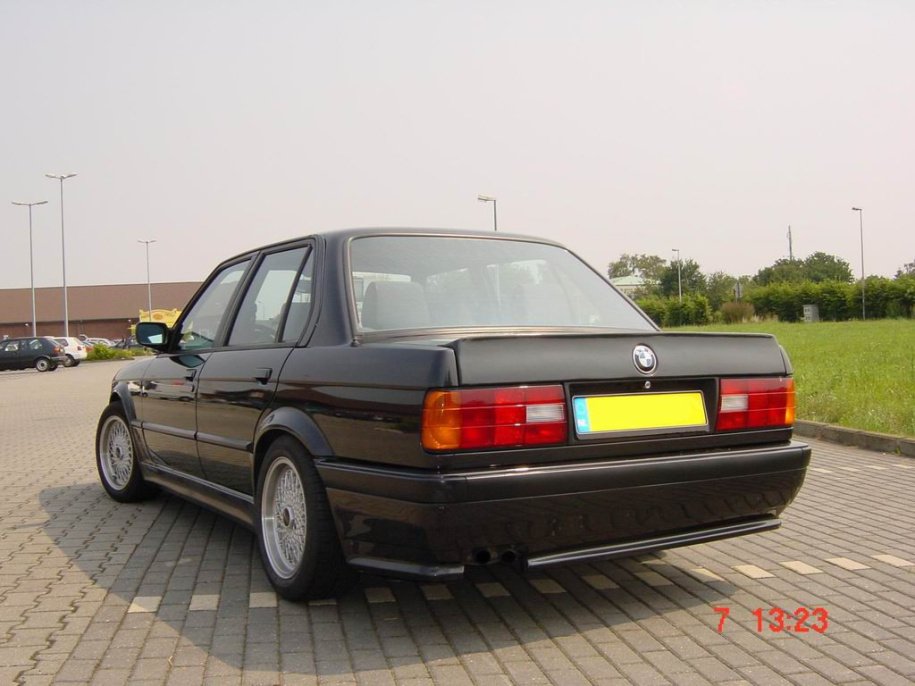

The car as I bought it 17 years ago.

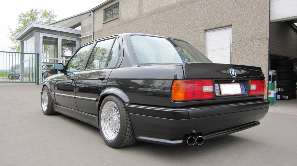

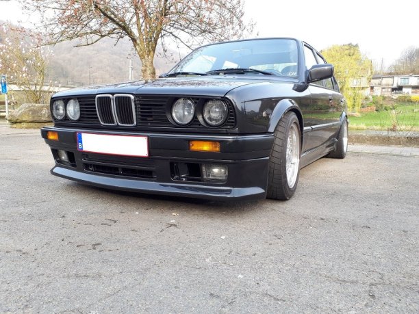

Current state

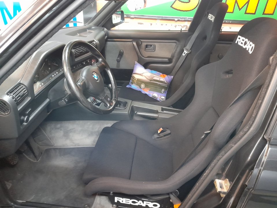

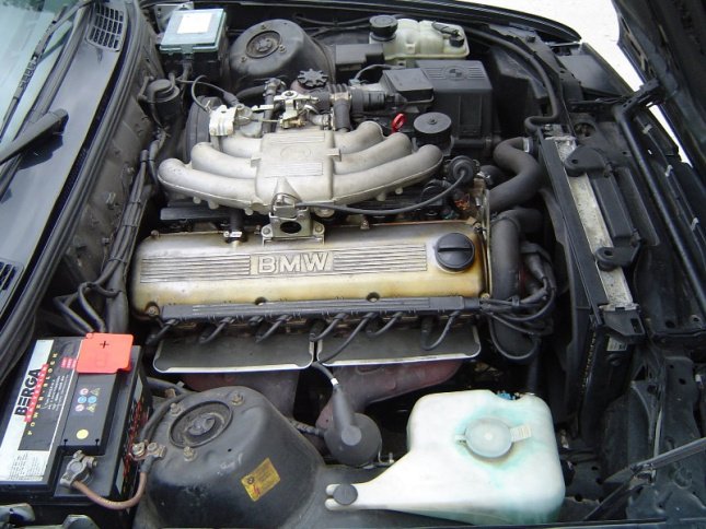

Engine bay

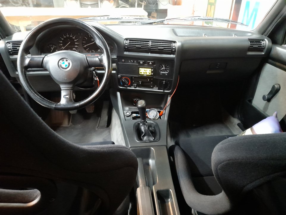

Interior, analog oil pressure gauge will move as it will be visible on the can display

underbody redone, complete suspension overhaul incl all bushings, subframes, axle shafts, driveshaft, new 3.91 OS Giken Superlock LSD.
I must say, the car is a joy to drive. The sound of the inlet combined with the exhaust note gives goosebumps, car is always asking for more! Some years ago after receiving new paint and some grille work. However, as the car is used for roadtrips, mountain driving and an occasional Nurburging Nordschleife lap, it's a challenge to keep the car in this state. The fact that I enjoy driving above cleaning also doesn't help

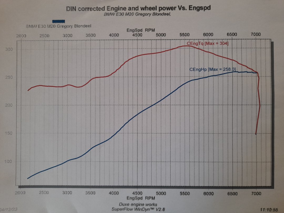

After break-in it was time for dyno day!
Lots of torque as foreseen, however top end flattens a bit faster than thought, apparently due to airflow.
Could be the size of ITB's which is on the small side, or the valves, or the head.. As it is a streetcar, I am not planning to change the setup as I don't want to lose torque in the quest for finding more hp in the upper range.
Anyhow the car is a beast
Pushed it once towards 7800 rpm, however limiter is set at a save 7000 rpm.

Nice graph, nice diagonal curve. Similar figures to my n/a 3.1 and 280bhp and 325 nm torque. I am running on Rama RHD ITBs 42mm. What diameter you currently running? Keep up the good progress !

I am not sure what is choking airflow.
Running 40mm ones from RHD, but I am also running Schrick valves with oem diameter, however valve stem towards valve head diameter is significantly smaller than oem valves, which in result should flow more. Head is also ported and polished (again no supercrazy things as the car remains a streetcar where durability for me was important).
Cam should peak at 7000 rpm.
