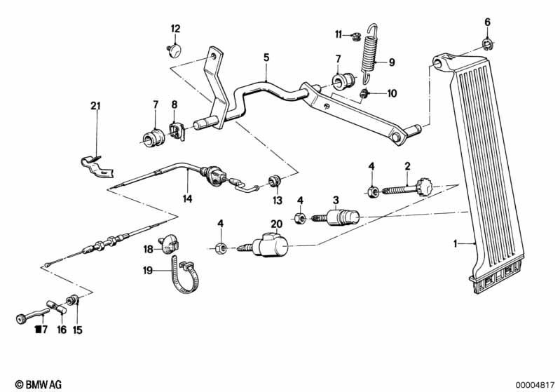

Time for new pedal bushings!
I thought the accelerator pedal was old.
- squeaky
- vauge sloppy feeling
- poor throttle response
As it turns out, there were no pedal bushings at all.
So when you press the accelerator the pedal linkage would flop & slop around before actually opening the throttle.
I know there is a plethora of aftermarket options available in different materials - bronze, Delrin, UHMWPE (Ultra-high-molecular-weight polyethylene).
Ended-up using good ol OE parts.
2pcs of 35411119016 (item 7)
Also had some spare rubber grommets laying around (item 10 & 11) that help keep the return spring quiet
I'm waiting for a replacement lower kick panel, so installation was easy.
Remove the circlip (item 6) & disconnect the accelerator pedal
Disconnect the return spring (and fit new rubbers if needed)
Remove the circlip (item 8 ) & manoeuvre the pedal shaft out of the mounts
Pop the bushes in
Re installation is reverse of removal.
Check and adjust the throttle cable if need be.
Was really impressed with what a difference from this simple maintenance task.
The vagueness & slop is gone and great throttle response.
An auto 320i is actually fun to drive!
