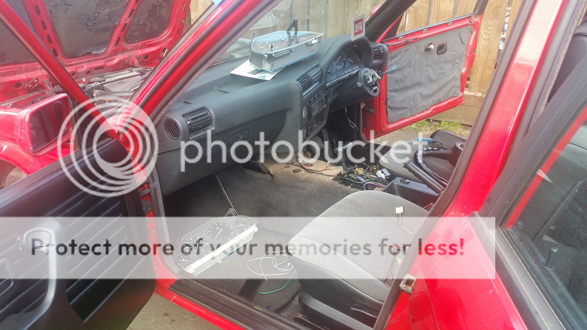

i bought this with full intentions to frag it being an m40 slushbox combo with nasty beige everything until i checked the shell over for rot and discounting the beige [ i have a plan ]...
This none sunroof 74k miles turd is solid , it really is worth me tinkering on with it for this reason only , i couldn't send it to china
can't believe i actually sold the BEIGE drivers seat from it ... result !
i've sourced an m42 conversion for the project and going to convert from auto to manual at the same time , it's got a headliner like a 4 post bed canopy so i've got that to sort out too but what a good solid car though 8)

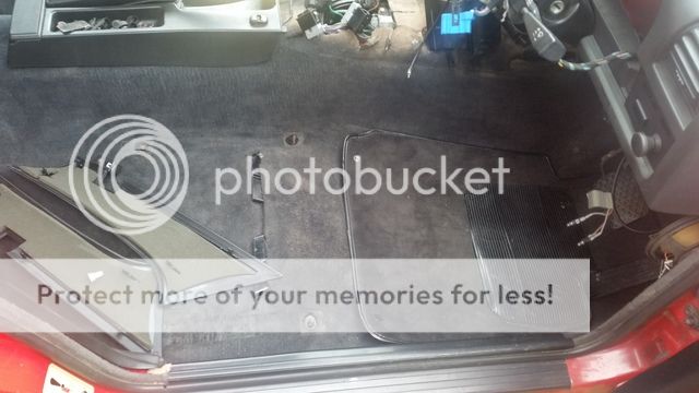

i've sprayed the door cards and rubber handles from beige to black using this stuff ...
http://www.ebay.co.uk/itm/VHT-SP942-Vin ... SwMNxXWPN4
and dyed allthe rear carpets with this >>>>

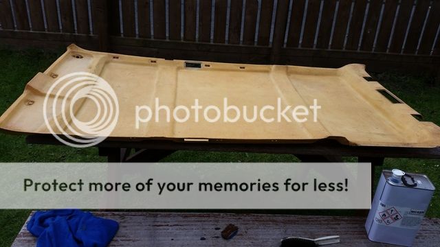

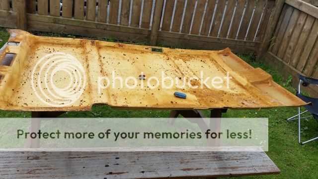

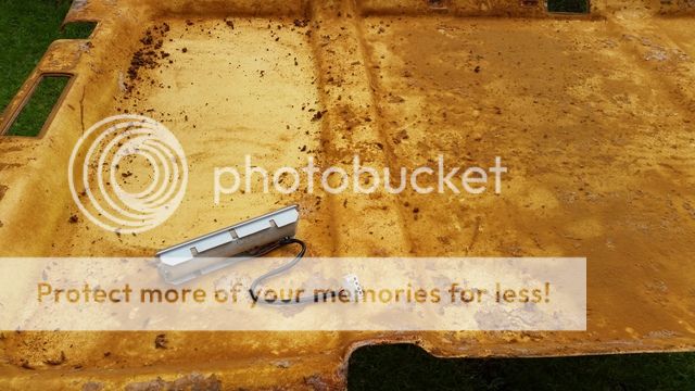

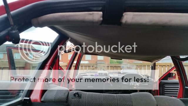

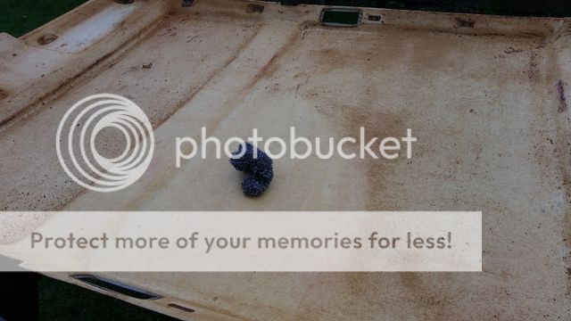

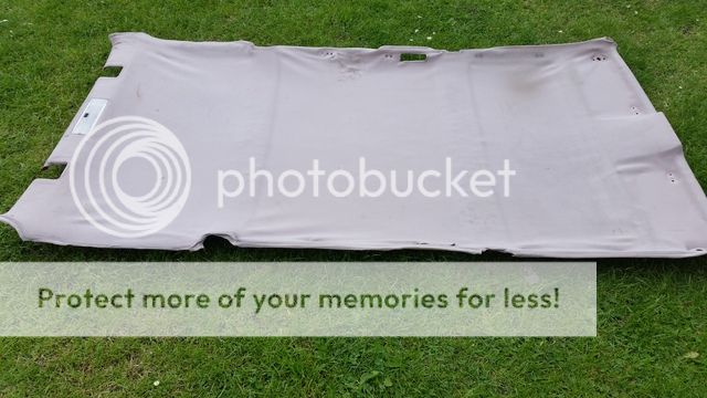

made a start on the 4 poster bed headliner option , taking it out was pretty easy but getting it glue free was another story, very therapeutic :mad:
i found that wirewool and some panel wipe + elbow grease sorted it out within 3 hours ..... my plan is to have it flocked as i've never seen one done i think this is the way forward for this car if i can pull off the desired finish and look on the headliner :D

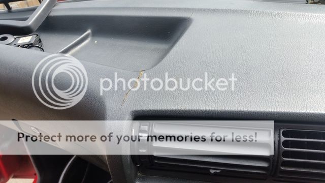

this car has a cracked dash not so rare now lol so maybe getting it flocked along with the headliner and both centre consoles for a further £110 and it will all blend in well .
my other option is to just buy some green can evo and some suitable black material for around £50 ish
[ not knowing much about material prices ] and changing the dash which has a large crack < 8O for one with a very small crack starting which will save me around £180 hmmmm

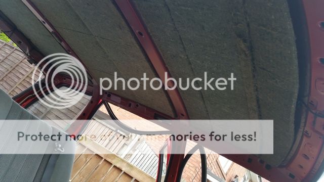

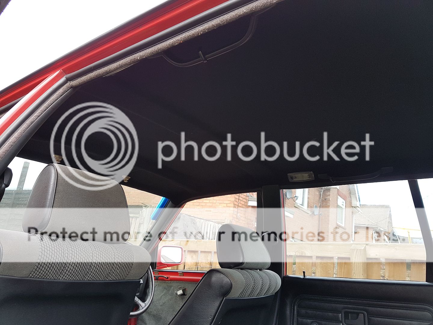

Wed Jul 06, 2016 11:15 pm

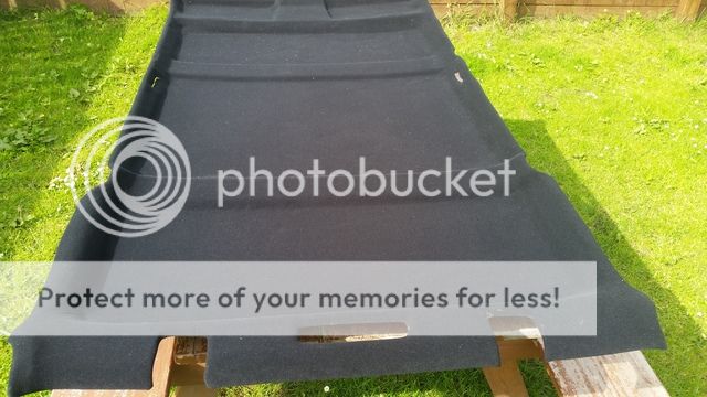

ha i took the head lining board to a trimmers not 5 mile from me and ....................
TADAAAA ! :D
very happy with that , a half roll of padded black headliner material was sat in the shop that was perfect !
putting all the black bits /covers and things back on .... looks much better now .

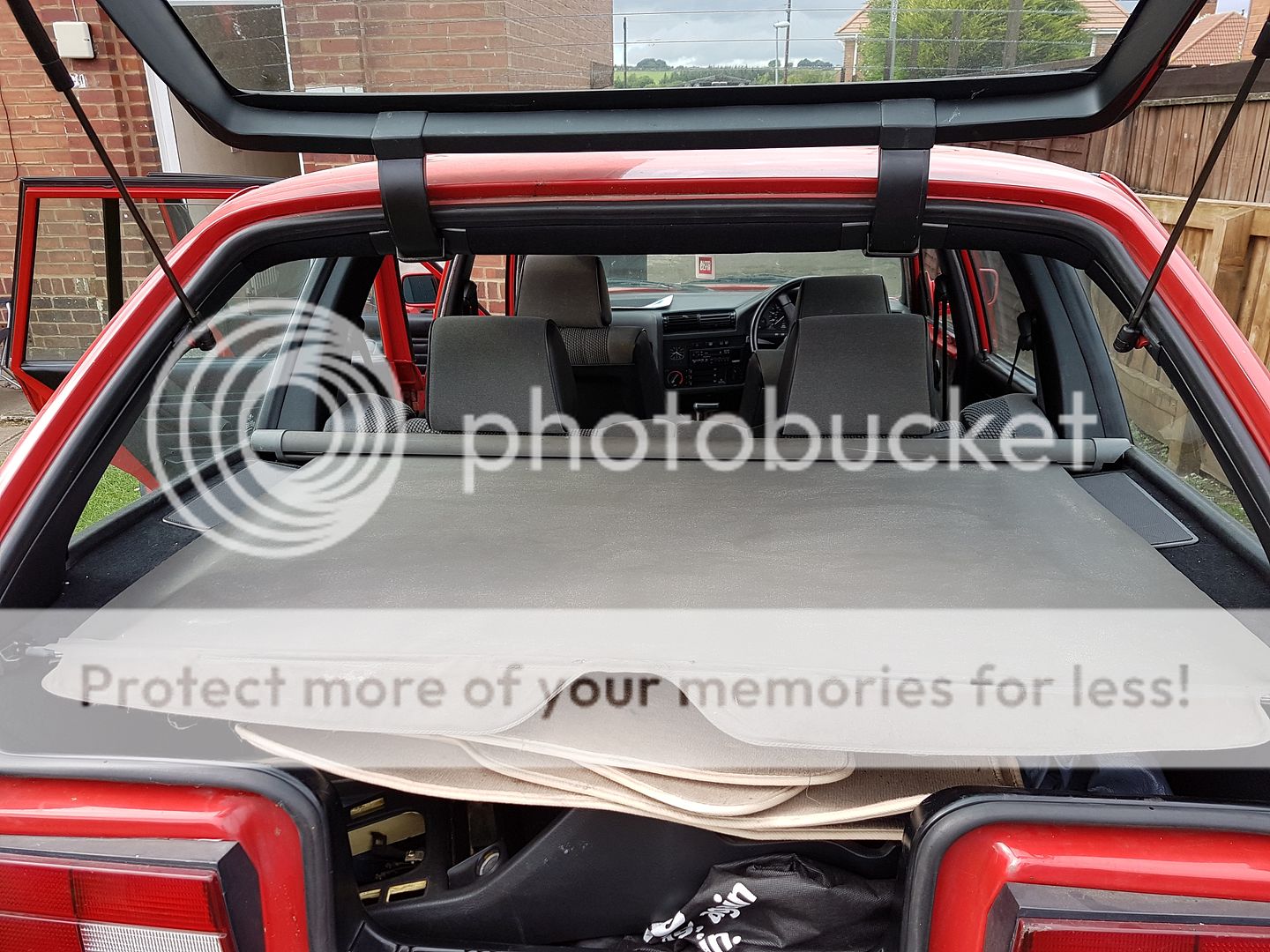

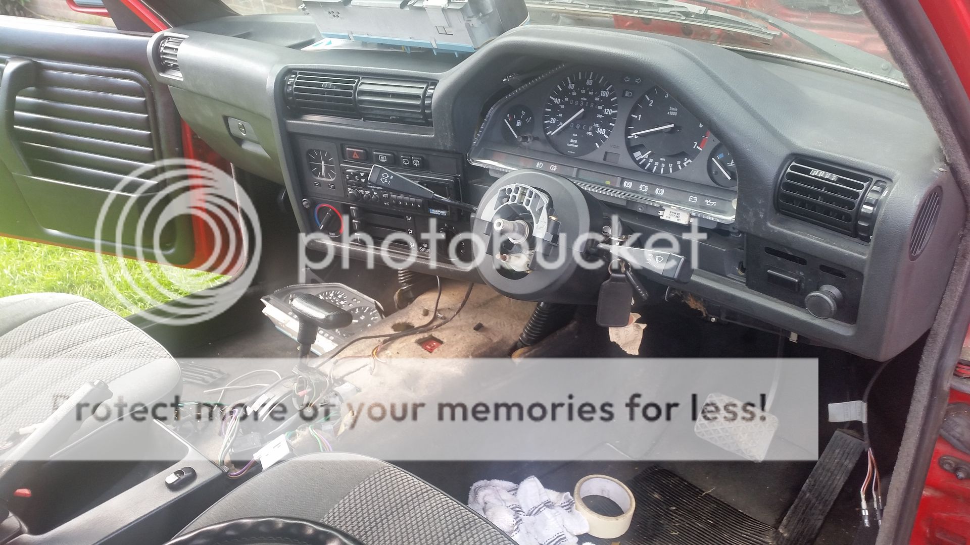

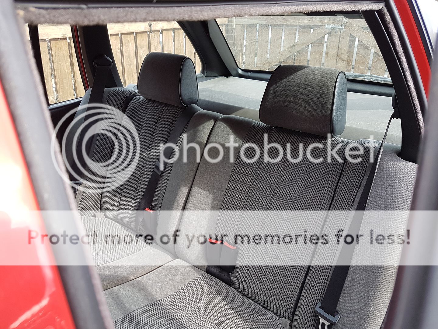

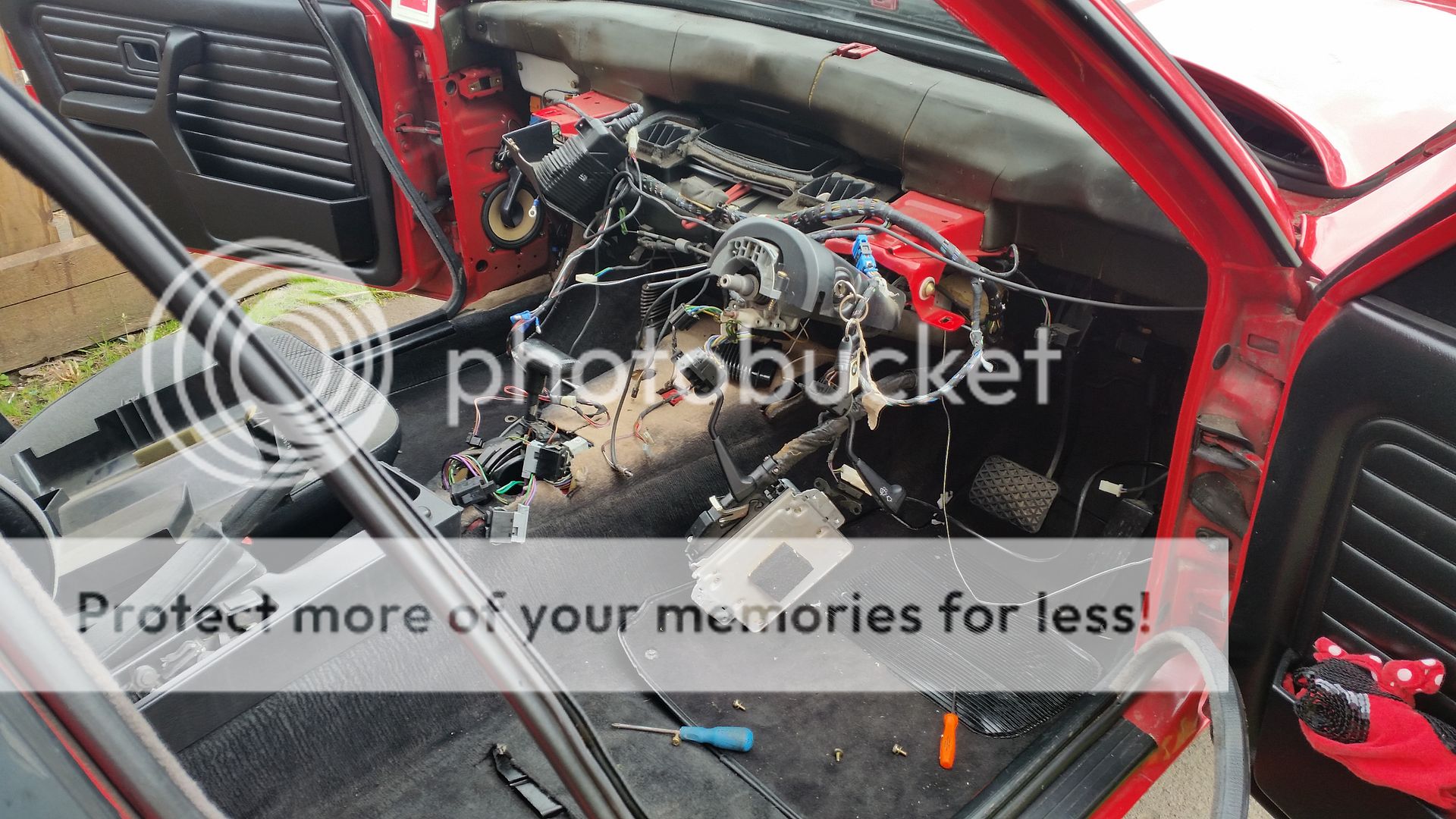

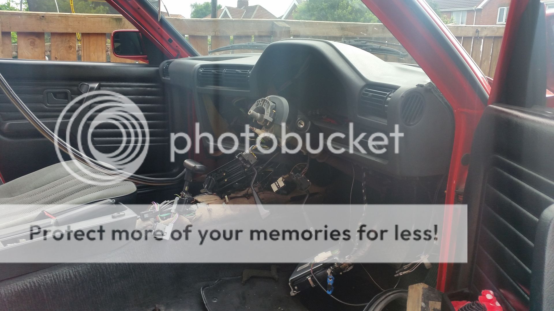

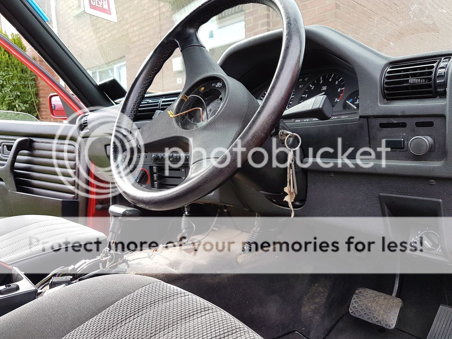

not having my white car at home has led me to tinker on with this one for a bit , got bored so done a few things .

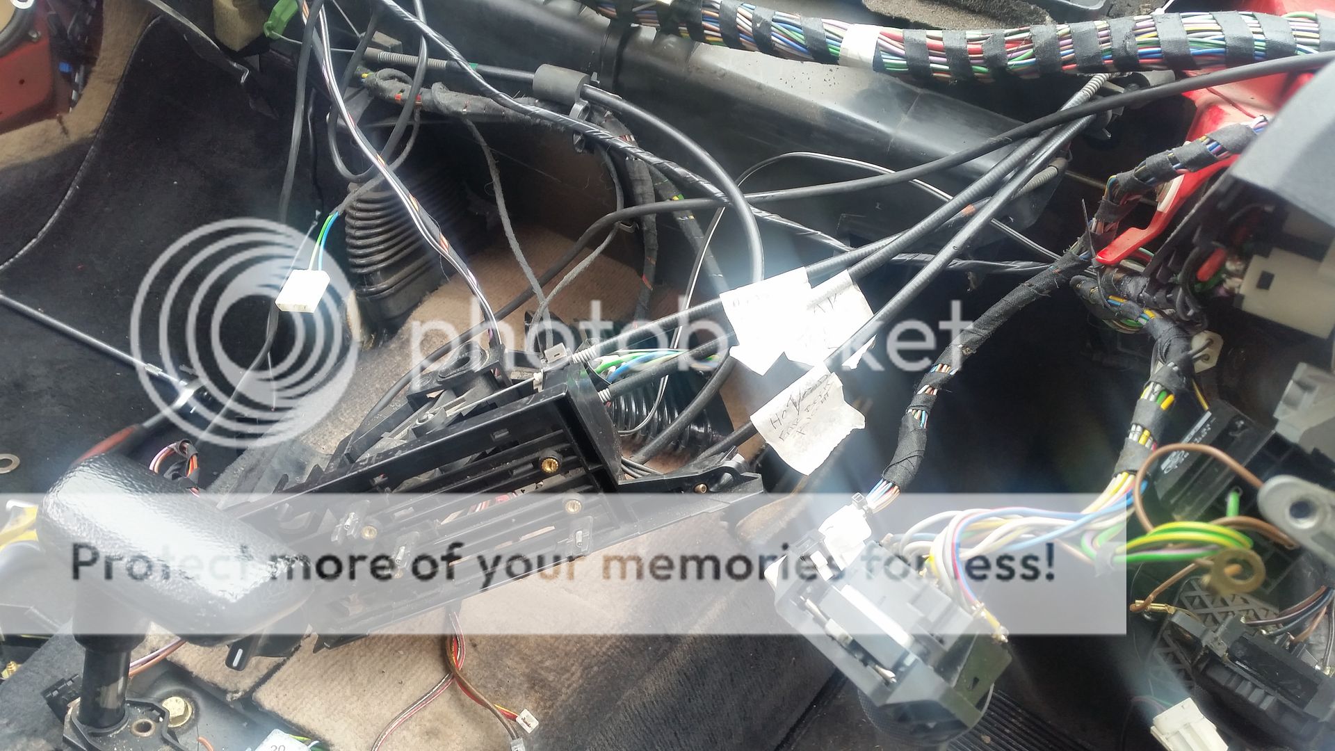

took the cracked dash out and i also had to change all the boysen cables on the heater box as i cut them all when i sold the heater panel from it before i'd decided to keep it [ the car that is ]
what a shit job those cables were , no chance in hell of doing it with the dash in . :cens:
all fixed :D
put a better dash back in

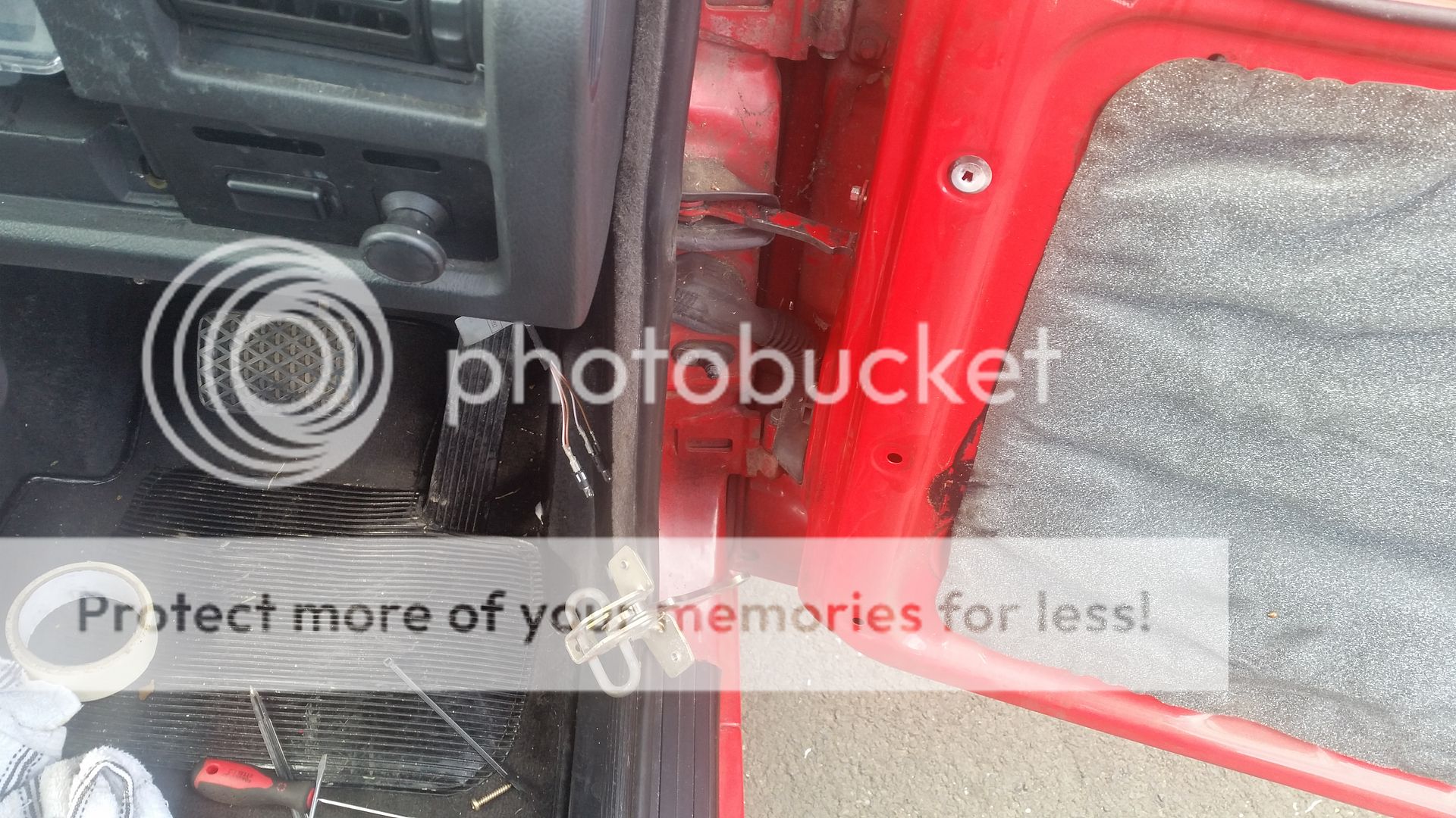

changed this fooked door break for a new one i had lying around :D now the bloody door stays open like it should .
all boxed up with blaupunkt tunes installed lol
even fitted a nice underdash panel from the stockpile .

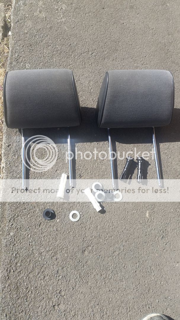

rear headrest action >>>>>>
EXECUTIVE winkeye

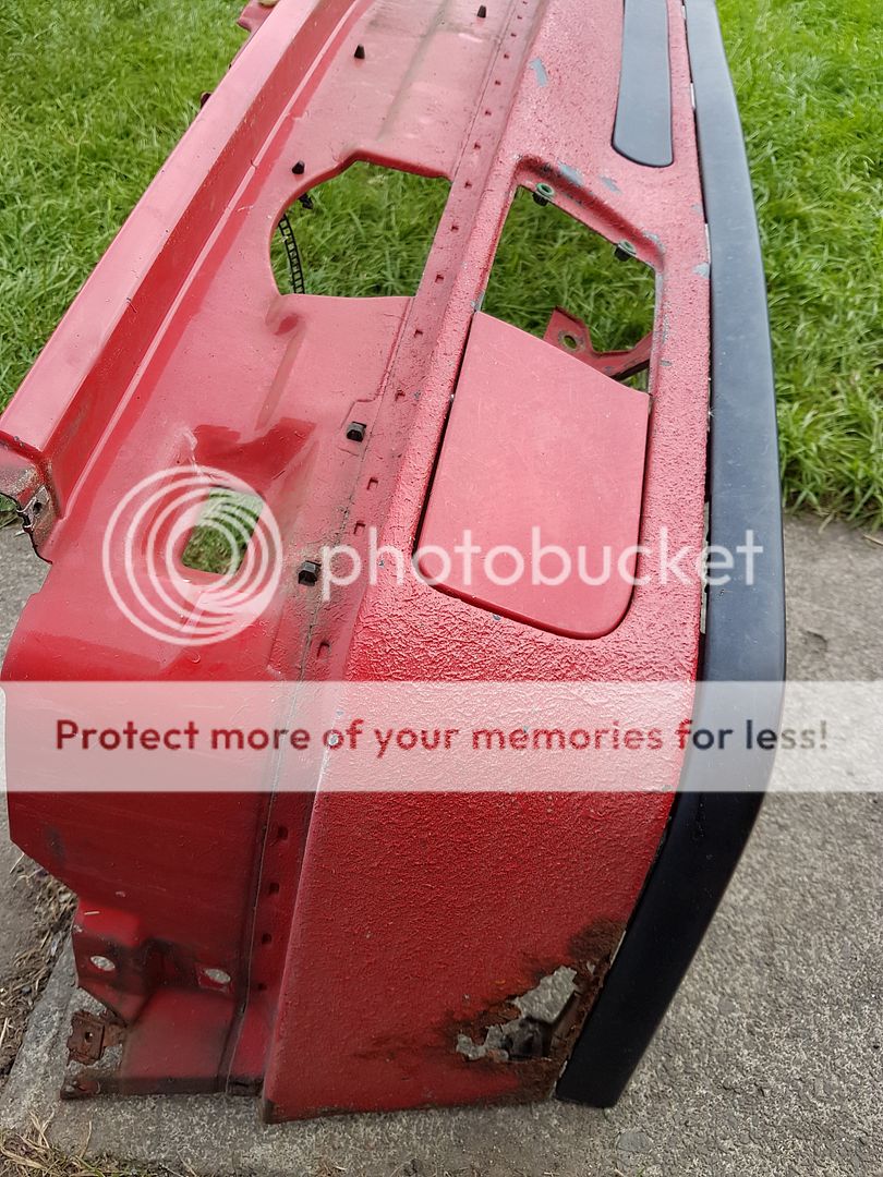

removed the crusty old valance as i have a good one to go on .
black headliner is l@@king sorted !
on to the engine conversion next 8)

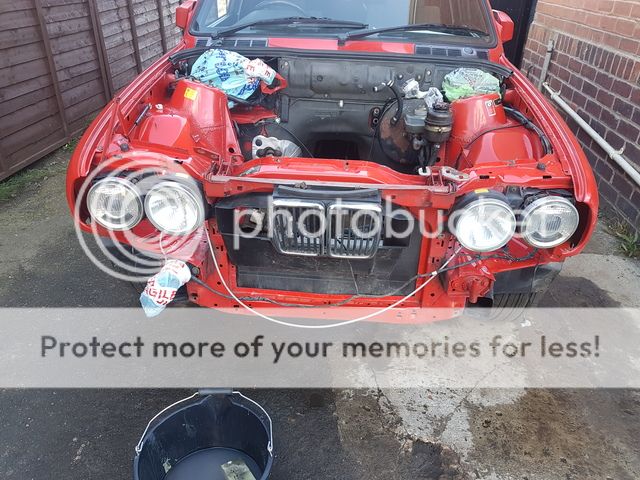

Thu Sep 29, 2016 7:03 pm

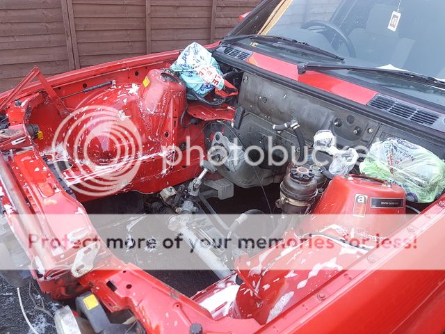

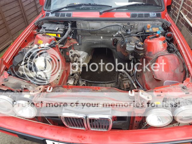

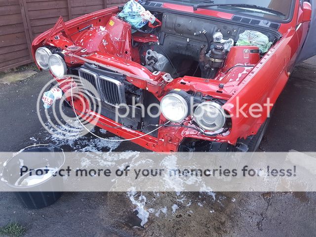

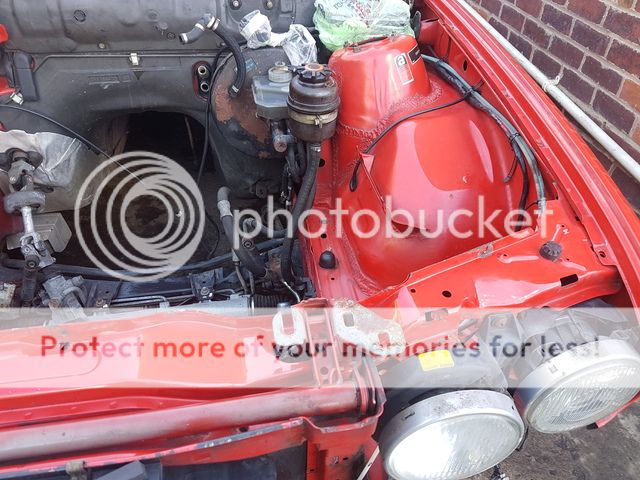

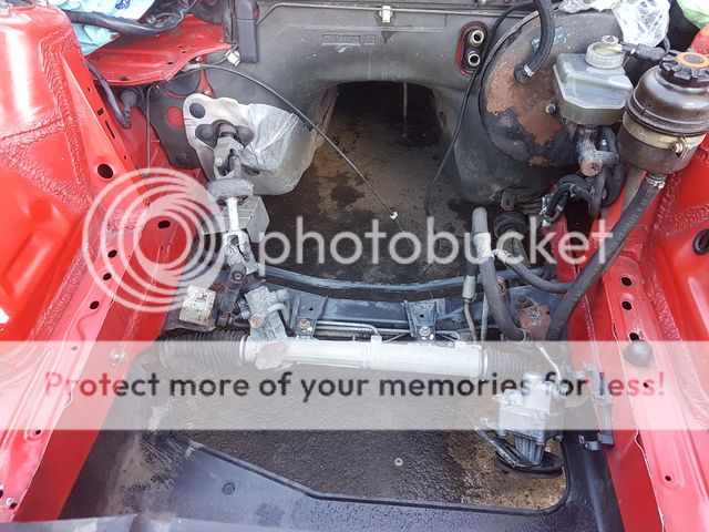

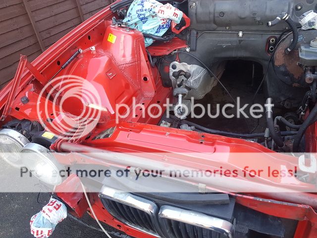

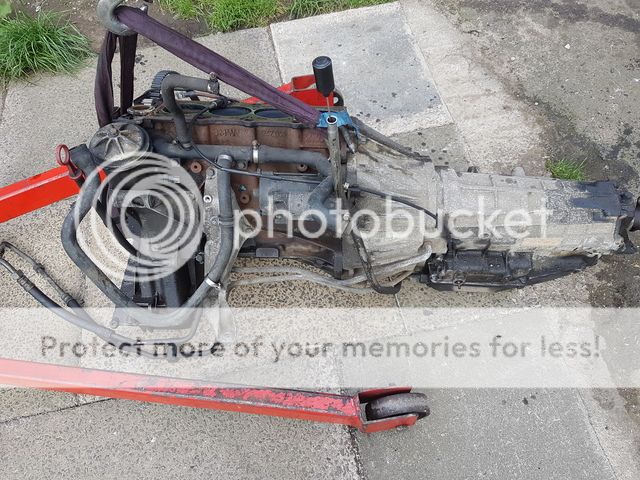

managed to get time to pull the old engine and slushbox , [ just sold the head from it :D ] .

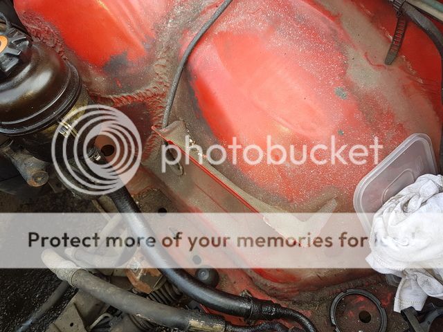

i decided there and then i'm going to need some decent de-greaser so bought some brush on gunk and a new brush :woo:
after 20 mins of letting the de-greaser do it's thing and water proofing the electrics it was hit with the jetwash , then soapy water handwash aaaaand finally t-cut as much of the bay as i could hit>>>>>>>>
>>>>>>>>> :squint: <<<<<<<<<<
ready for manual plumbing and pedals :D
