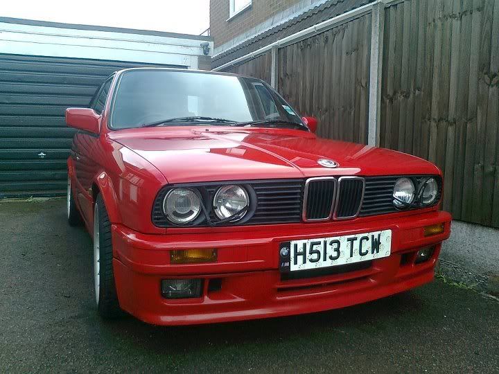

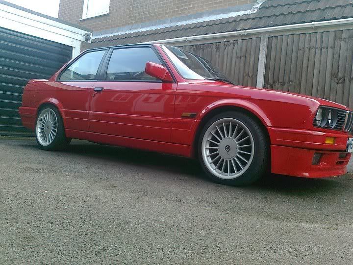

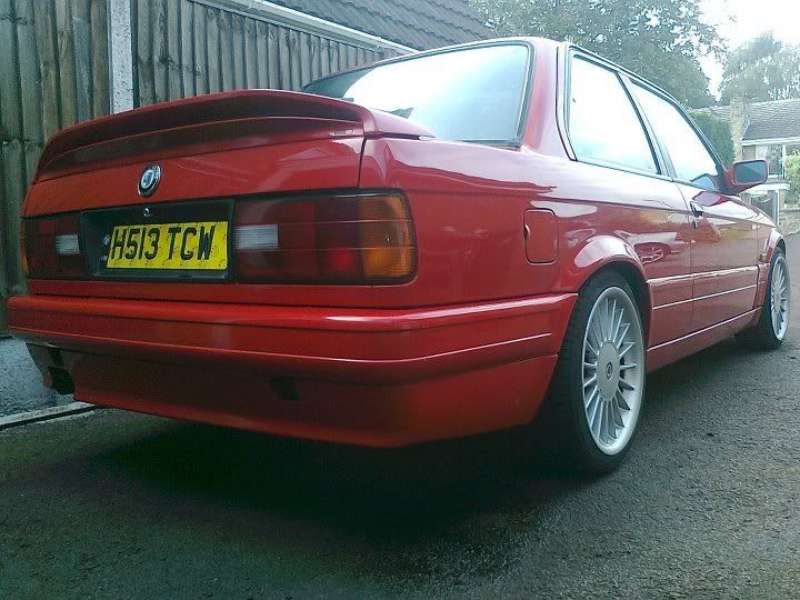

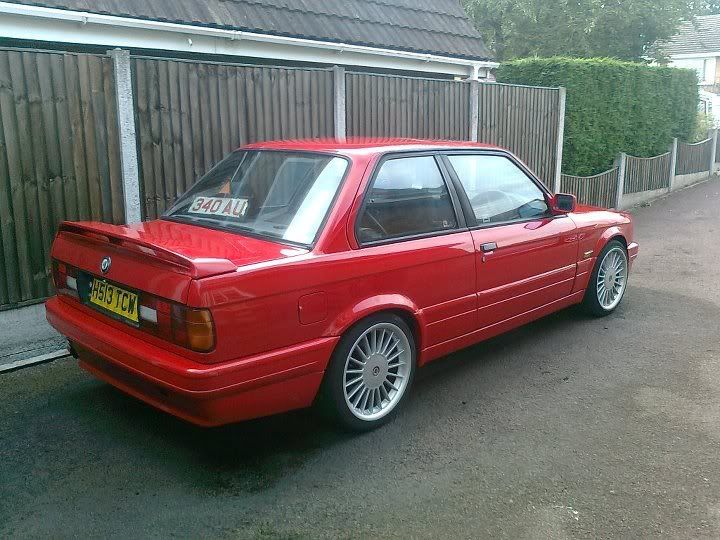

Hi, have been a member on hear for a few months now so thought its time i few up a few pics of my car and told the story,
car is a 325i sport that i bought a year ago but shell was a little bent unfortunately, so i bought a decent low milage 320i and swoped everything over, literally everything, every wire, clip, plug nut and bolt, shortly after that i fancied a challenge so decided on building a 2.7 for it.
i managed to get hold of a complete 70k 525e auto engine for £150, and kept my original 325i sport head, the head had 2.7 stamped on it, not really sure what that means.
then set about with the build, all in all it took me about 2 days to do the conversion, but i did have access to a ramp, engine crane, engine stand and air tools etc.
get a slightly thicker head gasket from bmw, with all valve stem seals, and new sump gasket and spigot bearing etc,
conversion was done for about 2 weeks then woke up to find it had been stolen from outside the house one, from the cctv footage they pulled the rear light out disconected the battery, then used some sort of bar down the side of the window to get in and rolled the car down the street, from there we dont no if it was started, towed or loaded onto a trailer,
