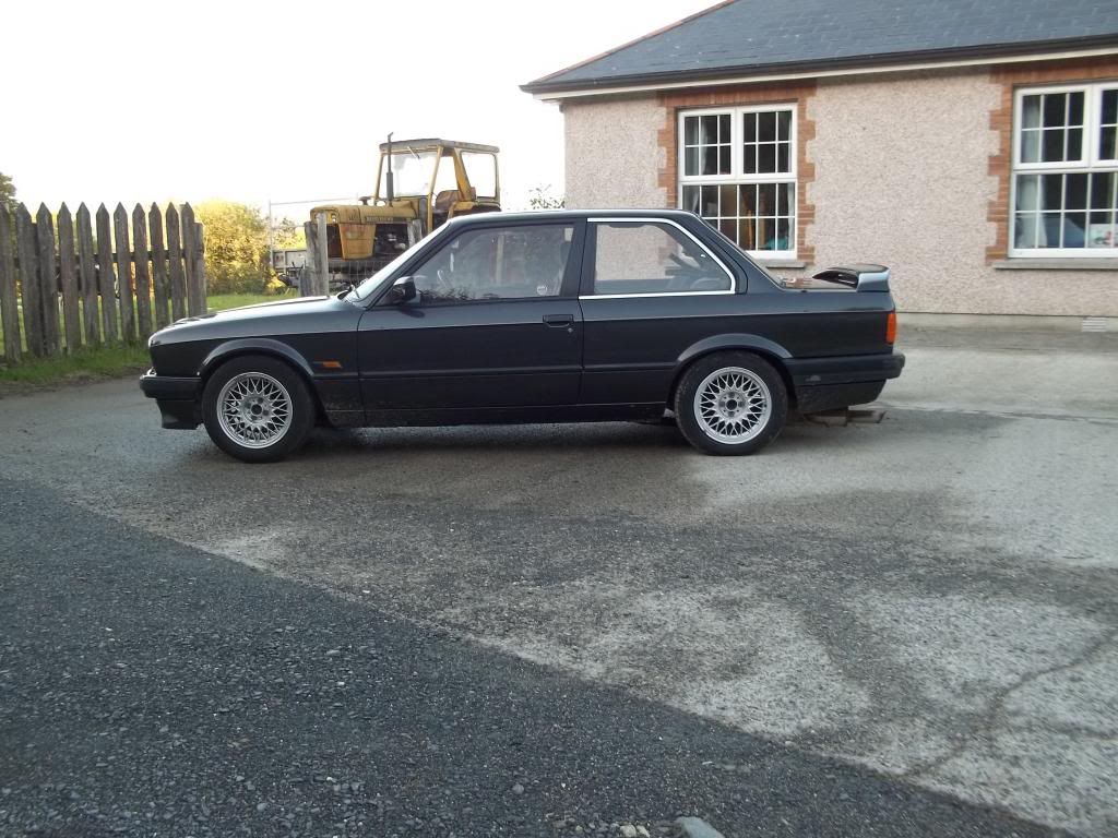

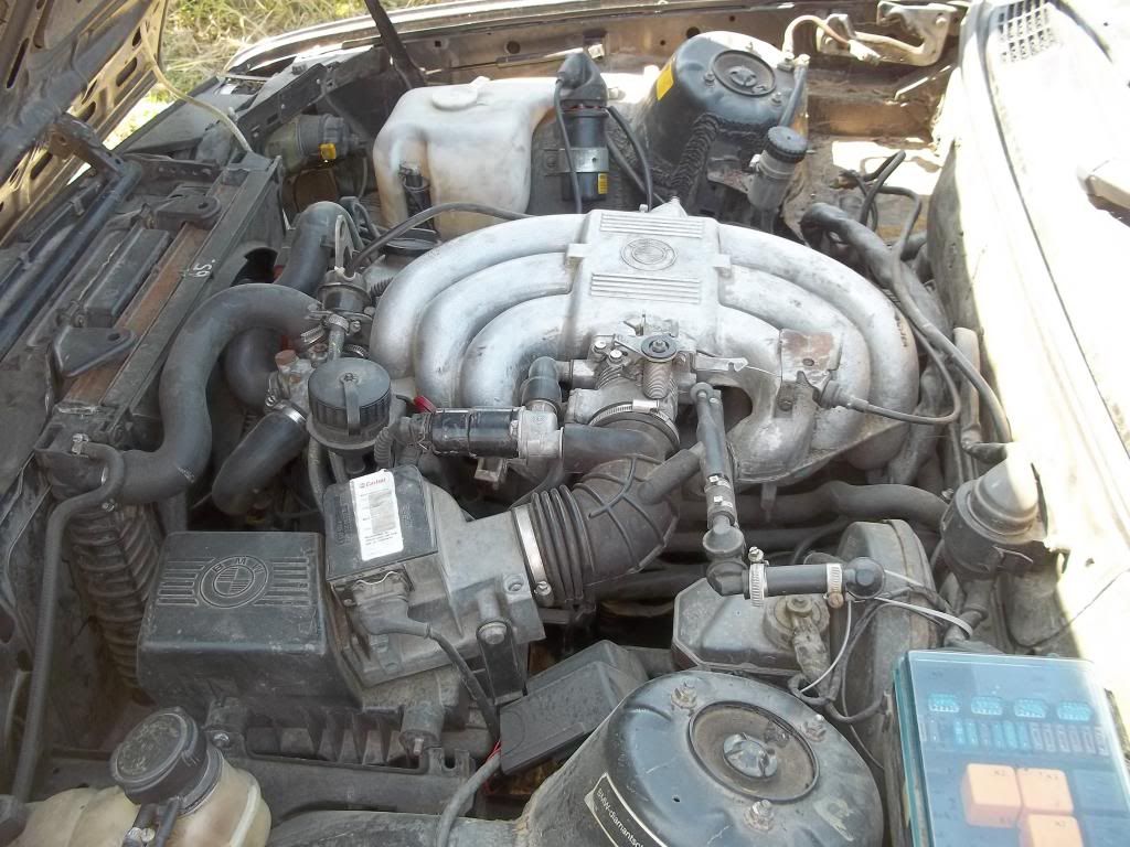

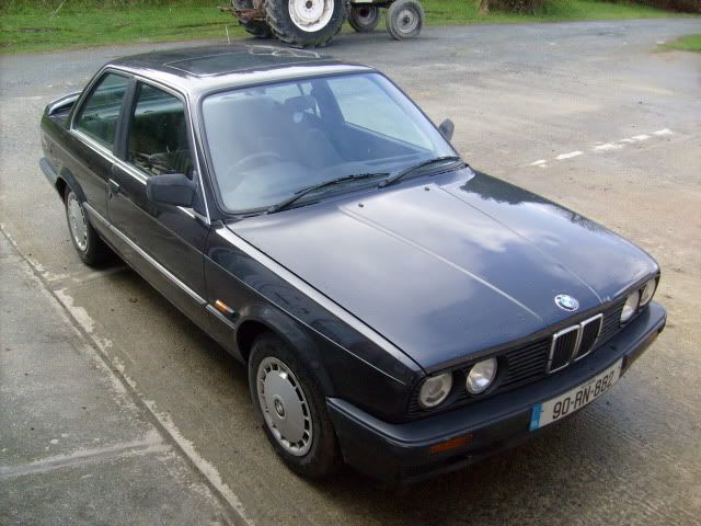

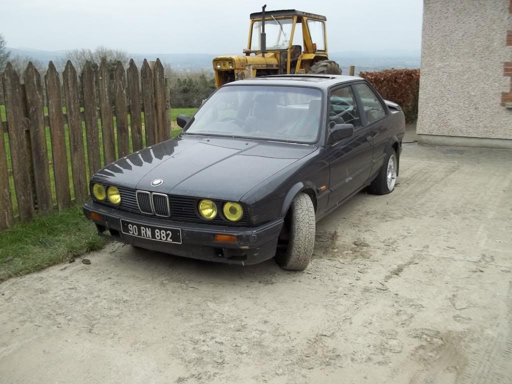

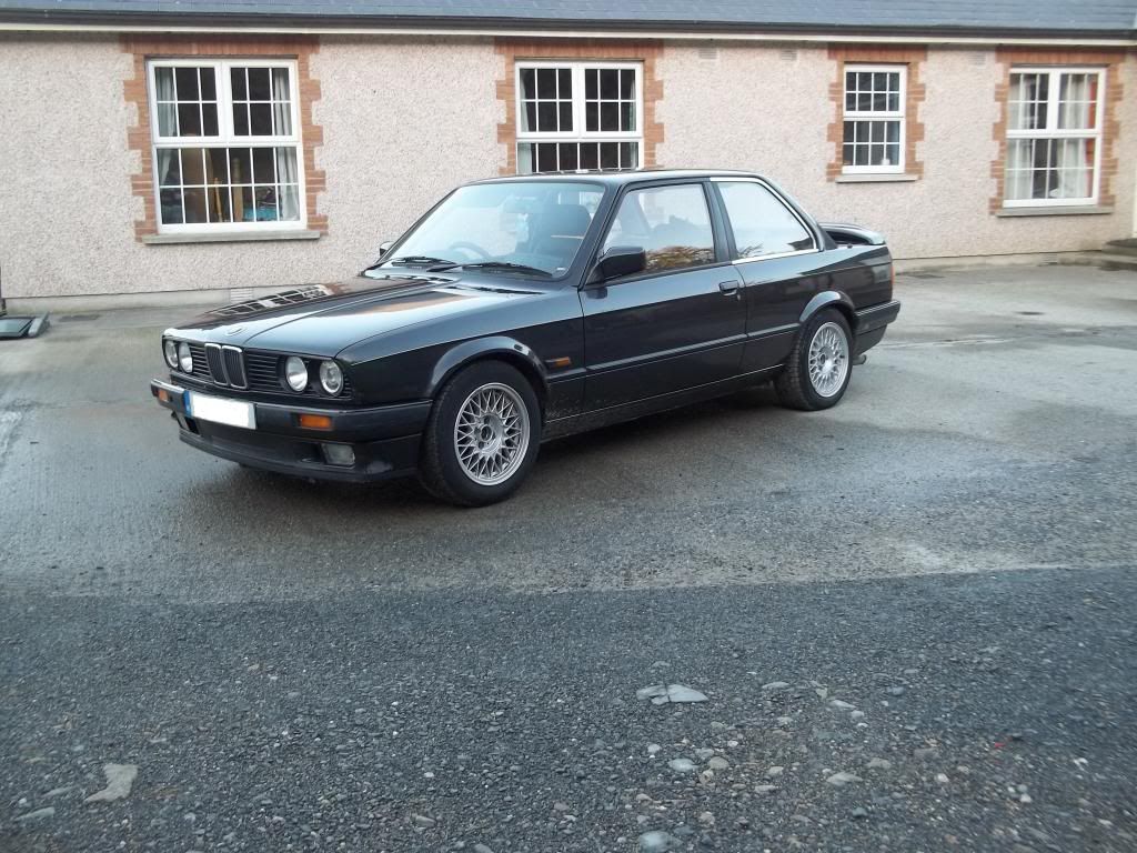

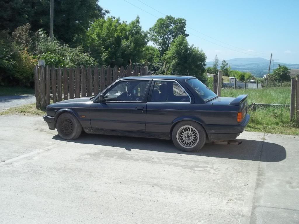

well ive been on here a while so i suppose i may as well stick up some picks of my baby!
its a 316i lux with a 325i engine fitted to it! its a low spec model but i hope to change that in time!

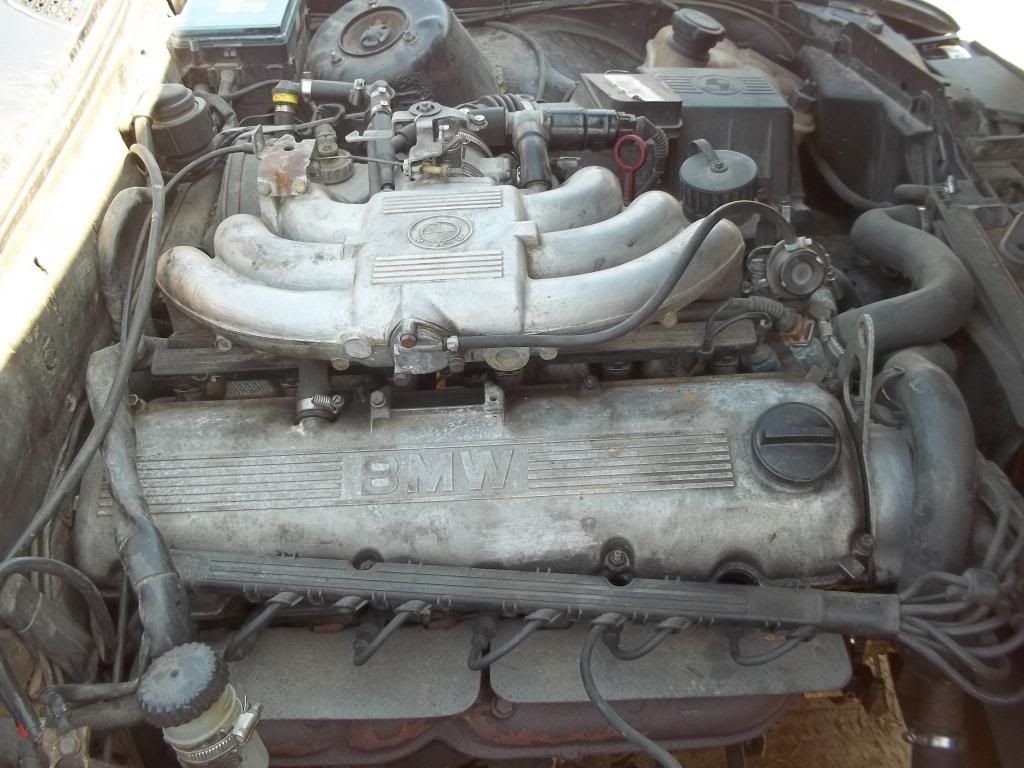

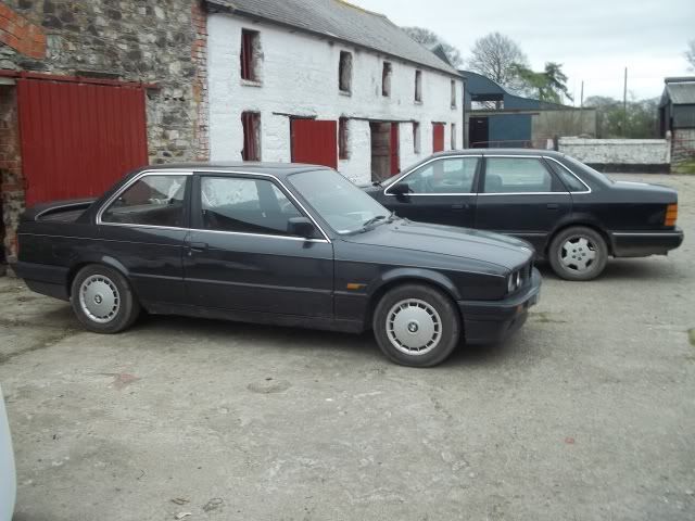

Post Tue Sep 06, 2011 12:42 am

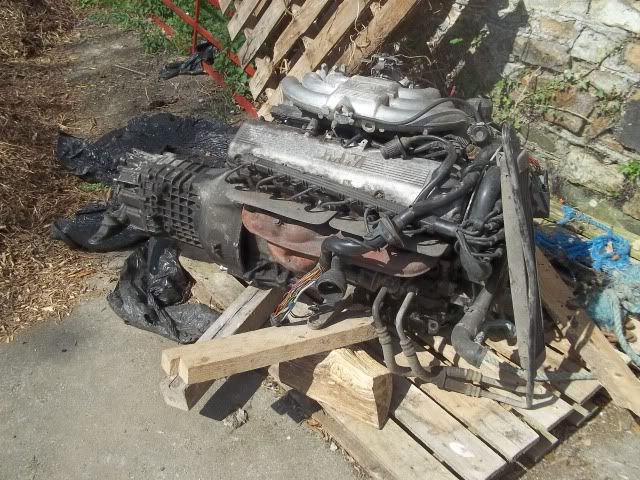

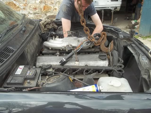

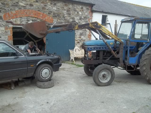

the engine conversion
the engine is a sport engine and gearbox is an ordinary 325 box so im told is there any way to tell its a sport box from the outside? this is the third e30 this engine has been in as the last car was a 320i 2 dr it was fitted to which died from rust!
Posts: 9678
Location: South Staffordshire
Post Tue Sep 06, 2011 8:44 am

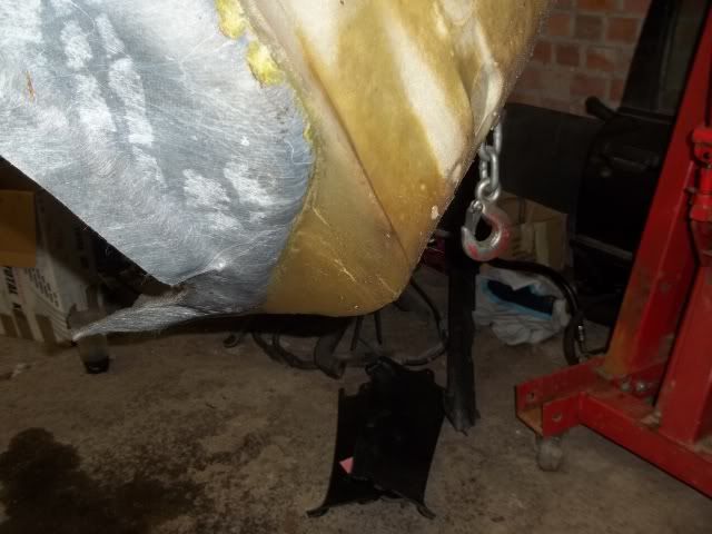

Nice work - love the engine crane :D

capri_rob wrote:Nice work - love the engine crane :D
thanks man! notting but the best equipment used around here lol!

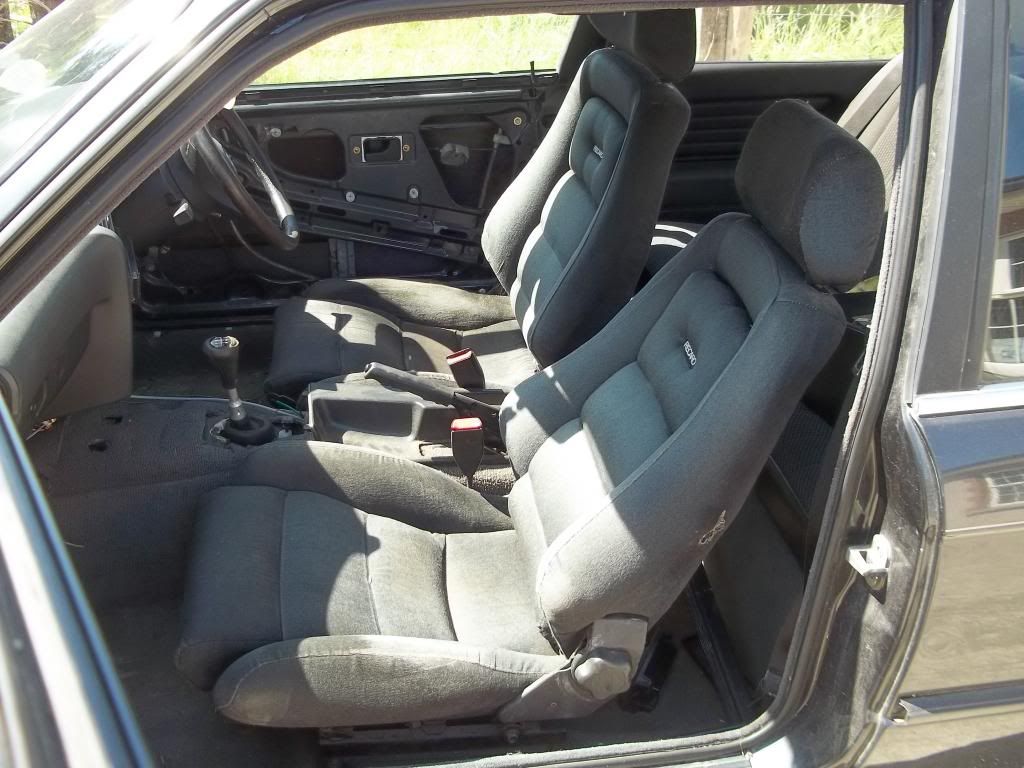

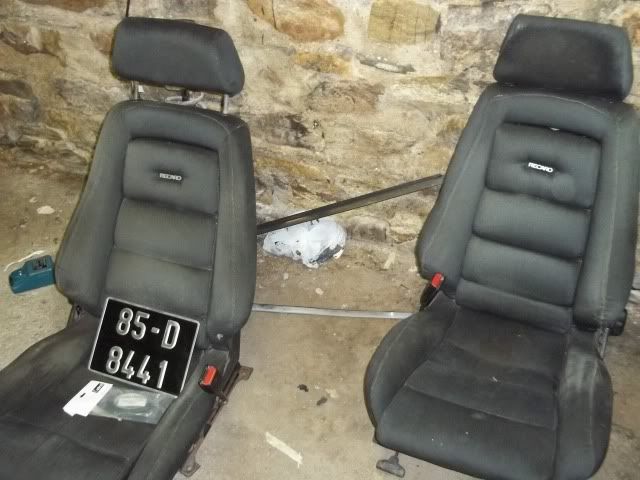

i picked up a set of these uber retro recaro's today they should look good in the 30! mine are tatty around the bolsters unlike the one in the picture
Jim320i
E30 Zone News / COTM Team
Posts: 10627
Post Thu Sep 15, 2011 8:41 pm
They look different :cool: Should be cool once fitted.
+1 (Theres benefits to a farmyard I guess!)
I'll check with the manager

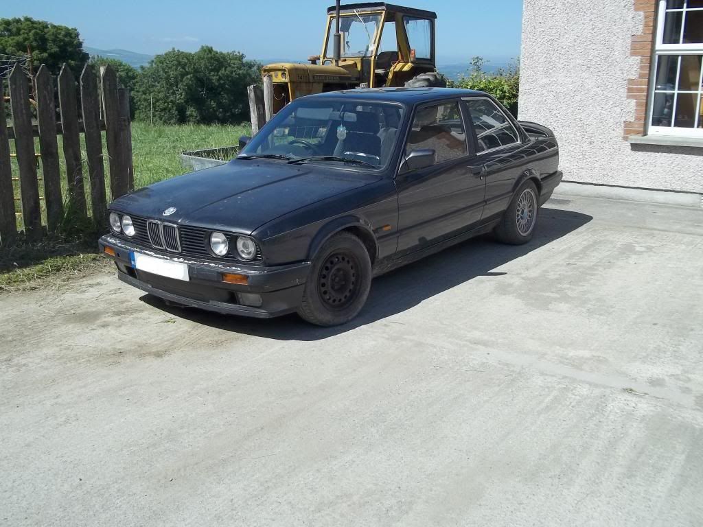

well i started back working on this machine the week before last as its time to get her back into action! i started of by cleaning up and painting the front light grills
then i fitted the passanger bronze tint window no pics of this in progress unfortunatly!

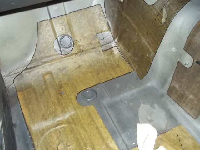

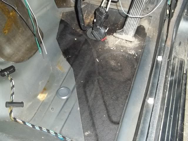

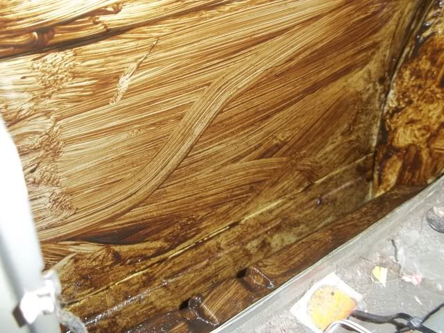

so then i siad id remove the carpet to clean it up and dye it black and to also look for rust in the floor! well its all good news so far despite the carpet been very damp on the passanger side!
thats all the rust there is :D

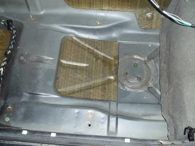

some more pics of the carpet

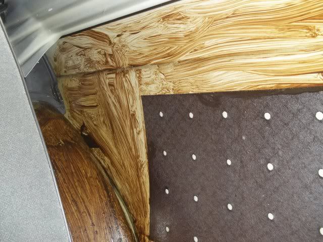

very damp! so then it was on to waxoiling her!
second coat here.

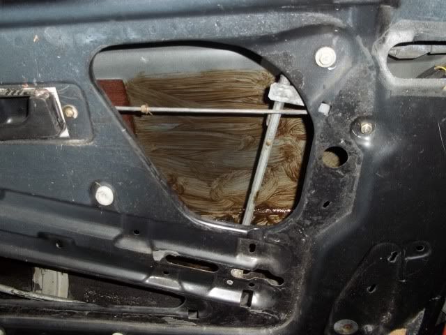

doing inside the replacement drivers door

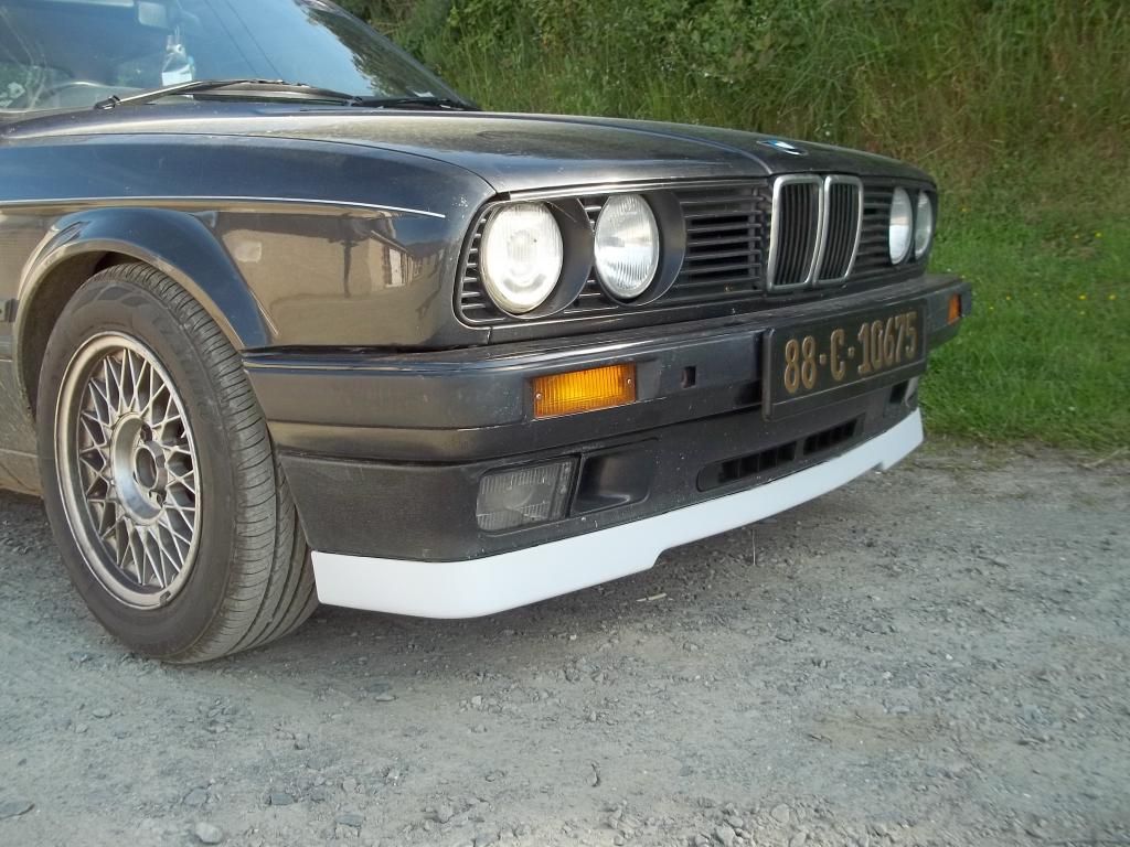

yeah i read somewere that some e21's are fitted with dogleg box's but it may be just alpina one's?

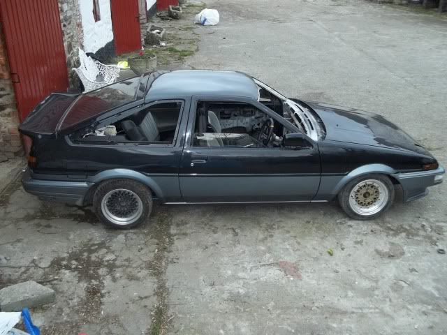

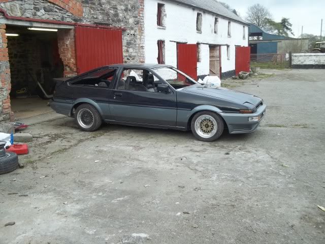

here is some more pics of the car along with a couple of the other project im working on at the moment.

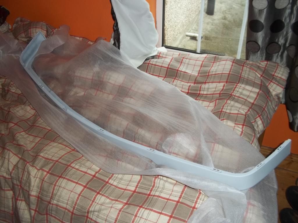

finaly got a front lip for her!
and a few better ones of the ae86

them recaro's are out of an opel manta gte if you want to get a set your self! they also came with the same check pattern but with tan bolsters which also looks great but are quiet a bit rarer!

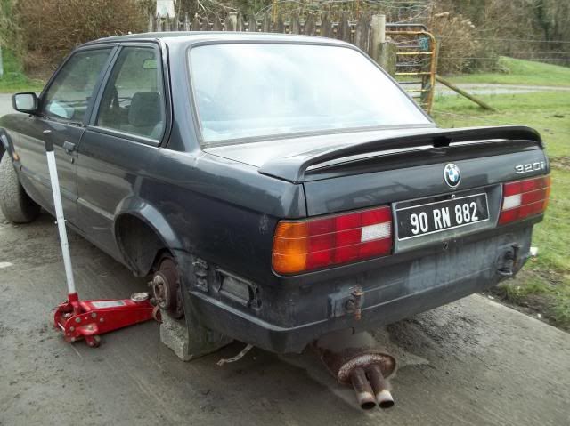

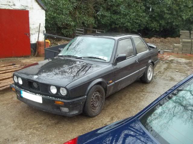

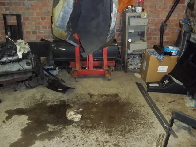

so time for a long over due update! so basicly i keep buying projects 7 and counting! and as such ive been working on and off at the car for the last year and half! but now at last the end is in sight!
so to save on buying high spec parts ect.. i bought a donor car for the build which is a 2 door 1988 320i which had the following parts fitted
m sport suspention
shadowline trim
rear disc brake axle with 4.10 open diff
electric sunroof
rear popouts

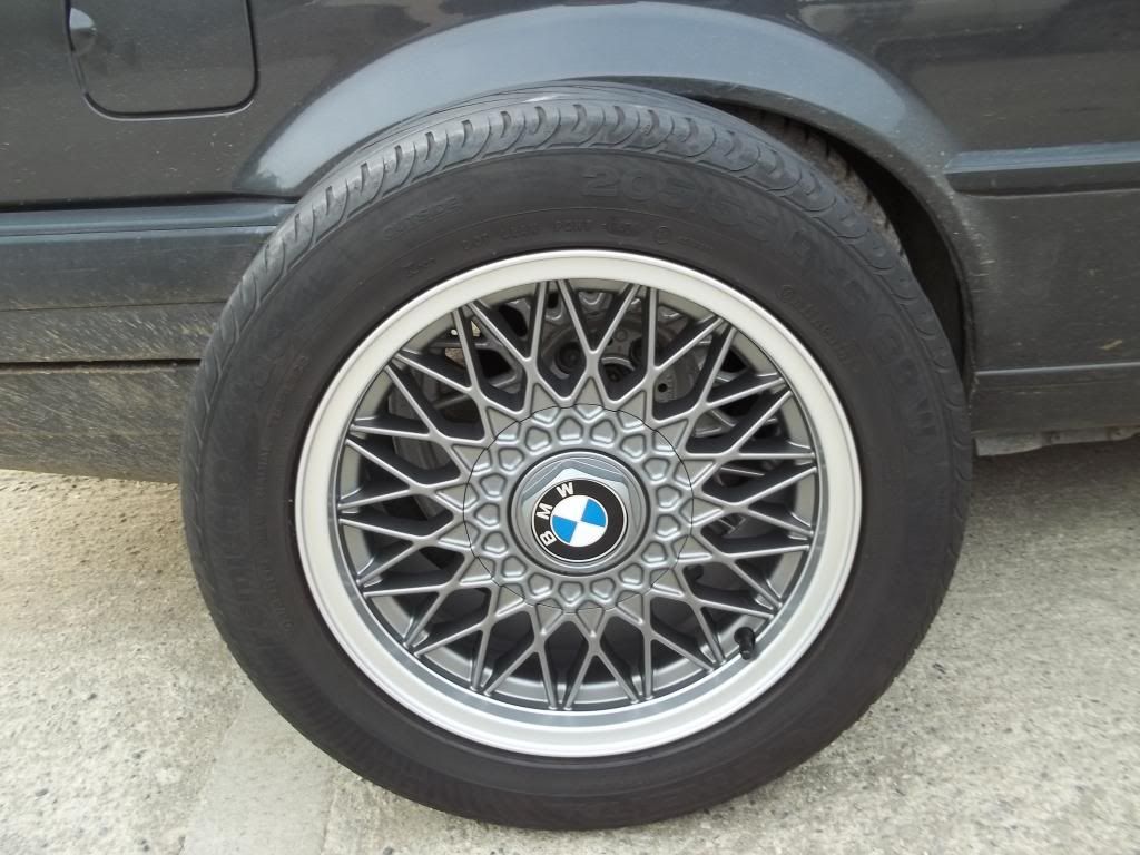

4x15 bbs oem alloys
tech 2 rear spoiler
sport steering wheel
oem gearbox shield
it had but unfortunatly the previous owner removed it! a premium sound system with tweeter pods!
so whats happening with the car at the moment! Its going to get a new battery tray panel but the tray is been permantly removed also a new scuttle panel soon infact next week most likely when the panels come in!
the new spec of the car when finished with the parts im going to get for it/have there plus a respray in the winter will be please god!!
full 325i running gear
shadow line bronze tints
tropical radiator (i have this but i didnt realise what i had and almost sold it!)
tropical/aircon vallance
oem yellow tint hella headlights and foglamps
dye carpet/parcel shelf black
z3 short shift upgrade
13 button obc
maplight mirror
custom recaro's
e46 steering rack upgrade
battery in boot retro fit
oh and an lsd to at some point so ive still got a way to go! but at least ill have her on the road again in the mean time!
the donor as purchased
jurring its strip down/experamental stage
and now for the main machine!

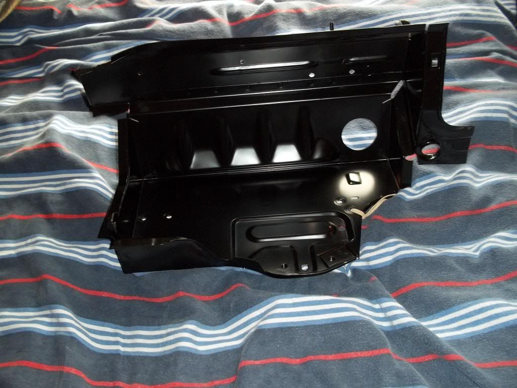

got 2 new panels today for this

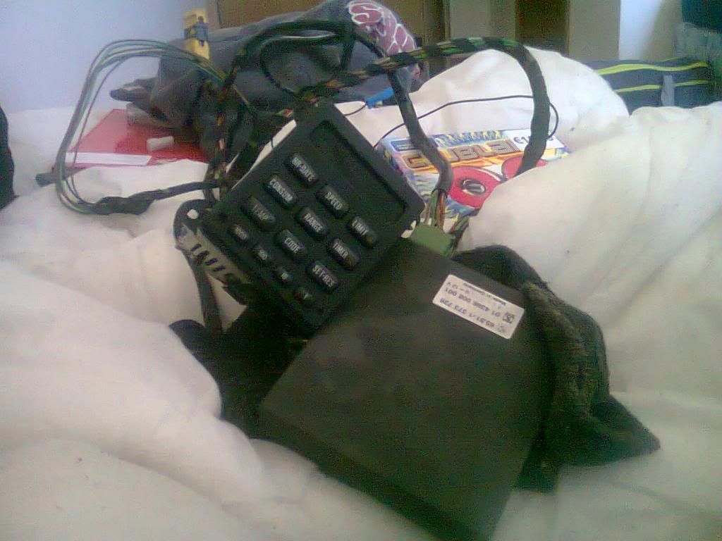

well a little update on my machine! i had a bit of work done on it been the new battery tray and scuttle panel were fitted i also had the front bumper painted! i changed the bonnet and rear boot door also!
the car was compounded also before i got it back! i also managed to pick up a 13 button obc in new zealand but it isnt complete unfortunatly!

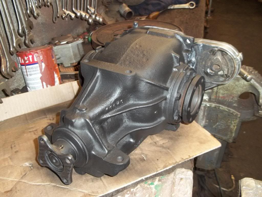

i decided to swap out the tired 260 getrag for a nice tight 240 which seems so far to be a good swap! and works well with the 3.64 diff!

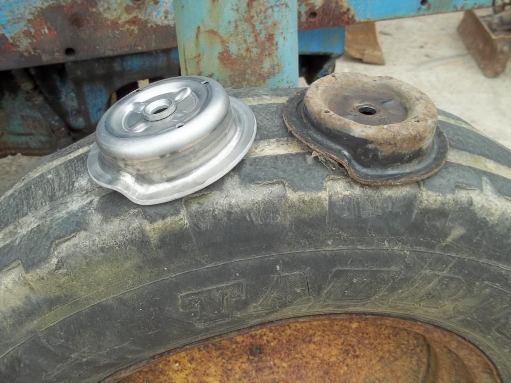

here is some pics of the parts i got along with mods/upgrades!

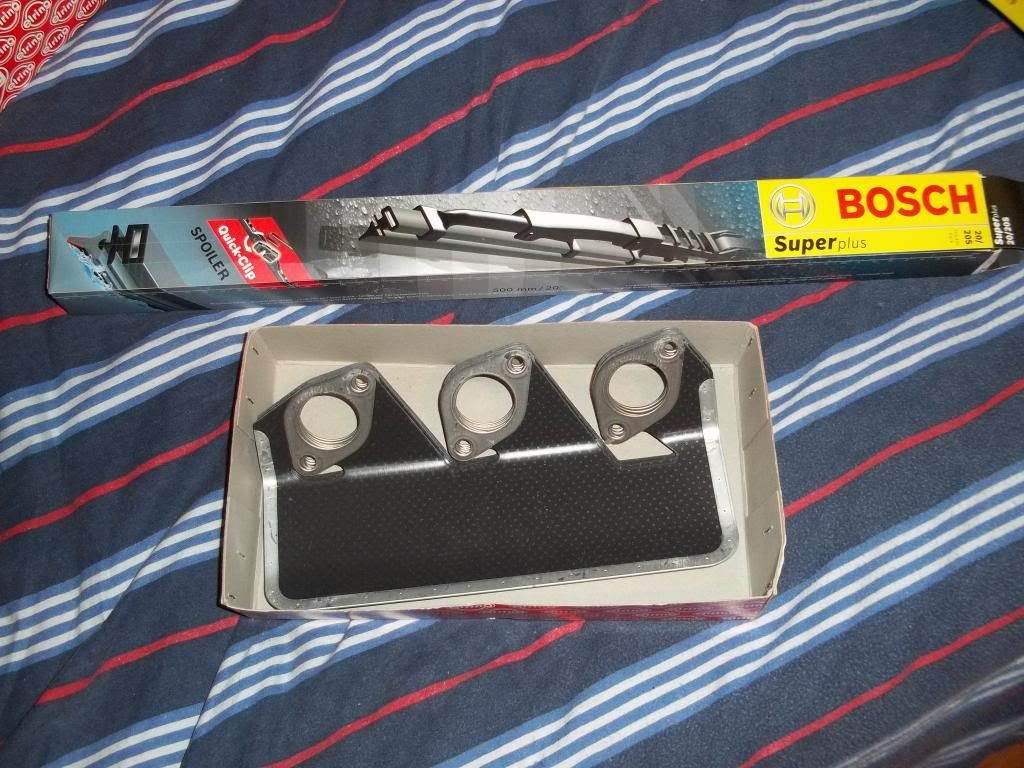

Image first up was replacing the exhaust gaskets and some fancy bosch wipers!

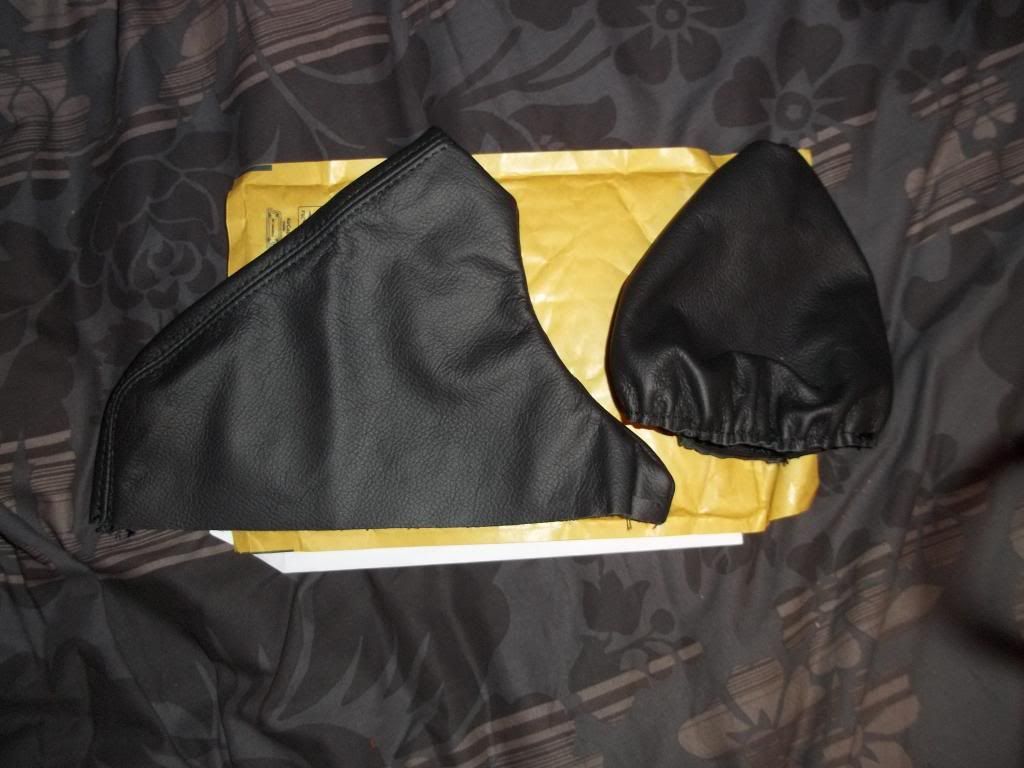

then i got some new real leather gaitors for the handbrake and gear surround!

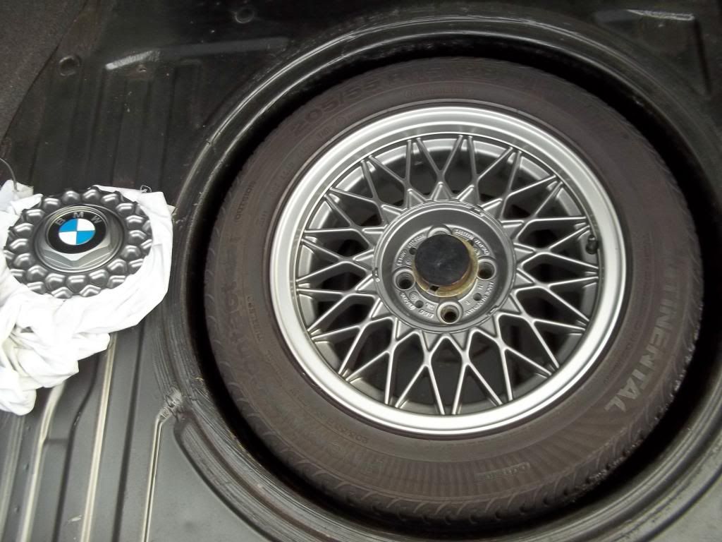

then i picked up a new evo style bbs 15 for a spare wheel!
so i was getting fed up with the small case 4.10 diff which was great accelerating but gave poor motorway mpg so i got an open 3.64 which needed a little tidy up!

Post Fri Jan 23, 2015 1:05 am

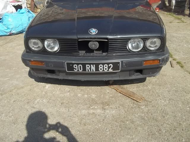

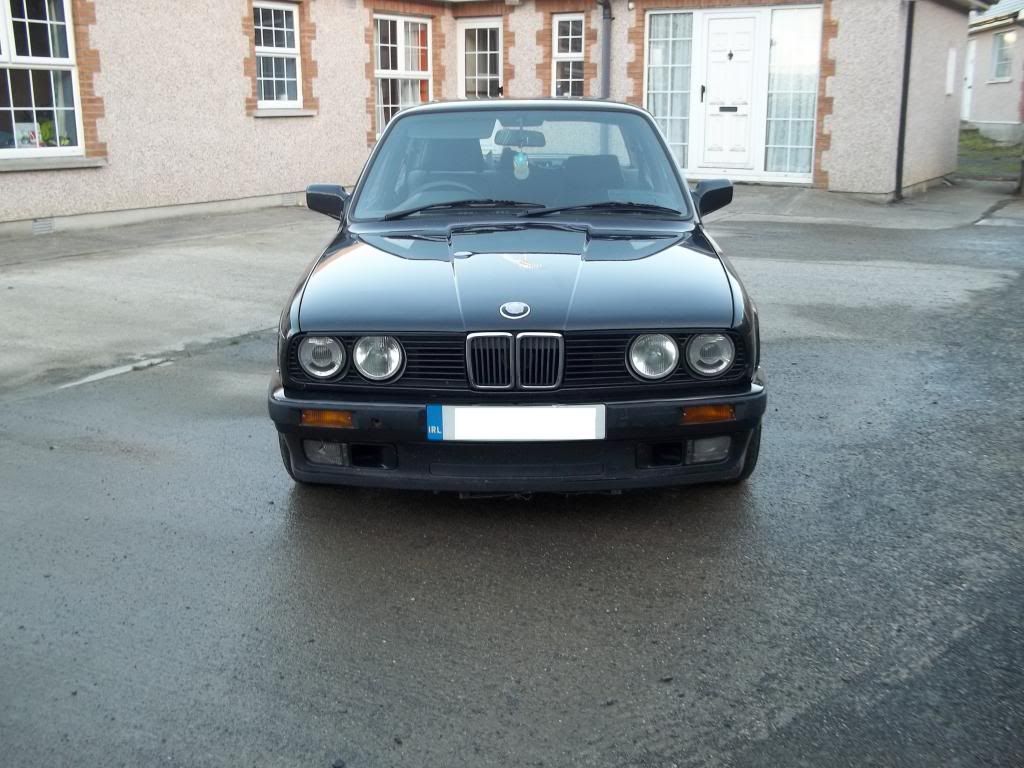

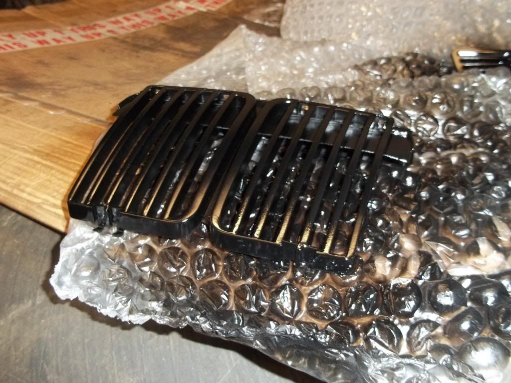

so i refurbed the light grills a few years ago but i never did the kidney grill so i went about painting it along with the scuttle panel covers!
i then went and got a 318is splitter from my dealer he told me it was the second last one left in germany thats not including dealers who may still have one or 2
and fitted for a few pics

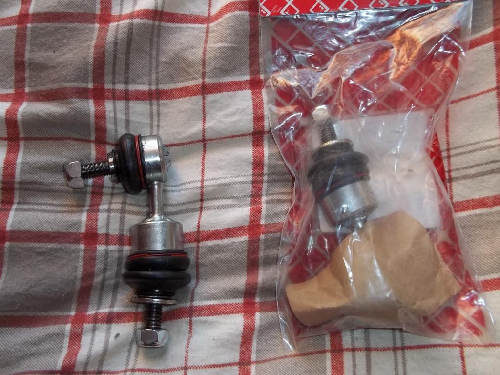

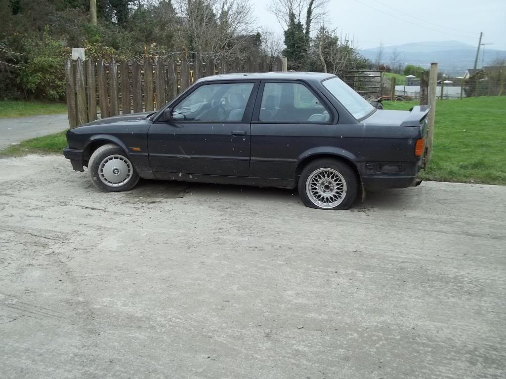

so then came along nct time it failed on tie rod wear and front drop links! so another e30 owner recomended these as an upgrade so i ordered some there ford mondeo mk3 estate rear drop links and seem to be a better and stronger design than the original e30 ones!

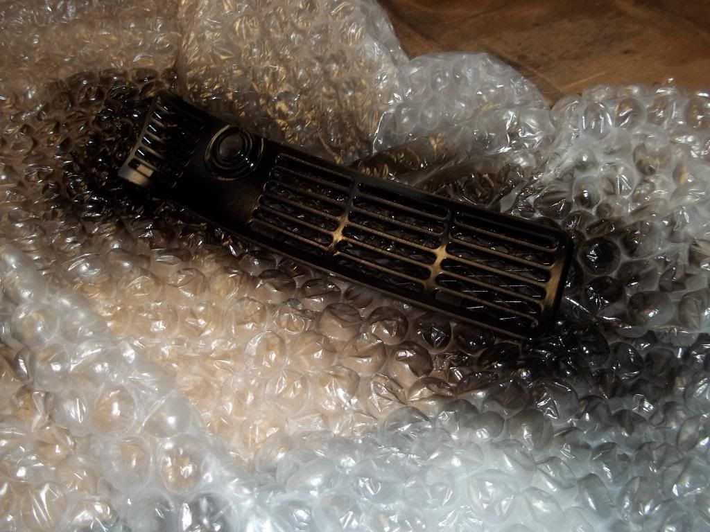

so then as i have the larger tropical rad i went and ordered a new vent for the valence to increase cooling in the engine bay!
i was doing some research on the net on upgrades using oem parts and i came across these there e90 strut top hats which lower your car an extra 10mm a nice cheap mod!
and fitted! its not really obvious but when your driving there was definatly a difference as the nose of the car was down more and the suspention felt tighter!

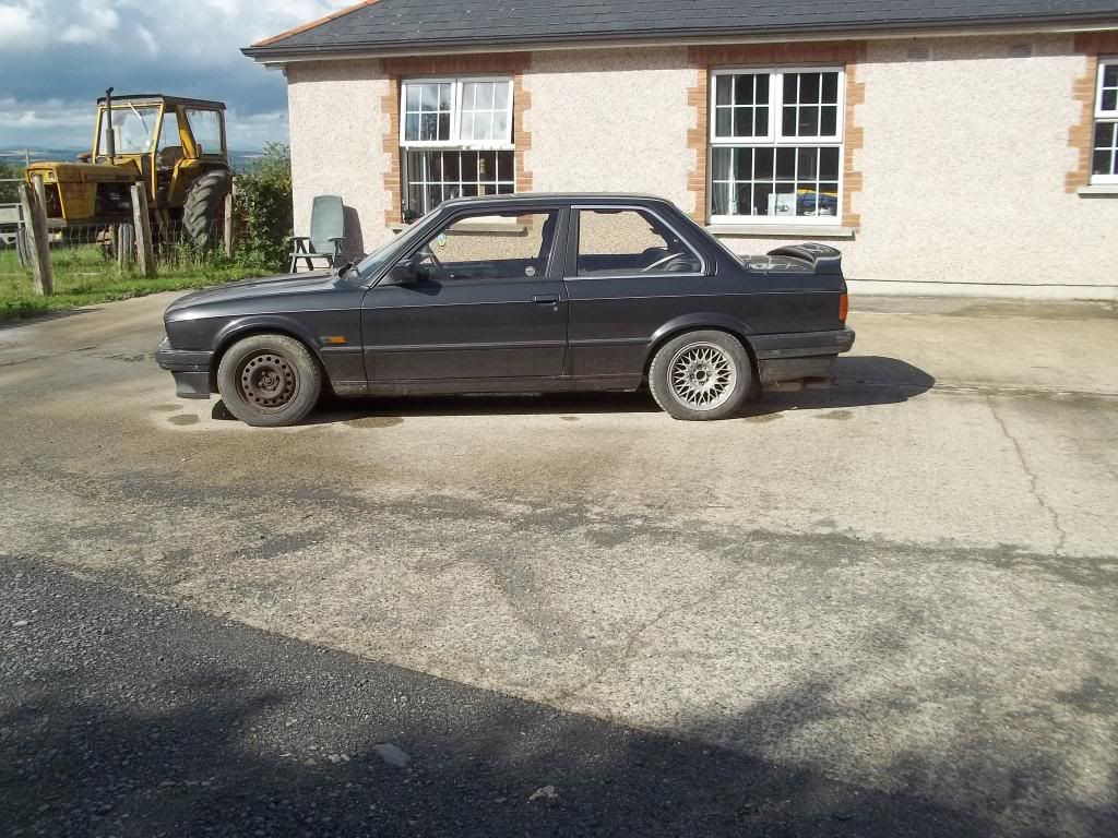

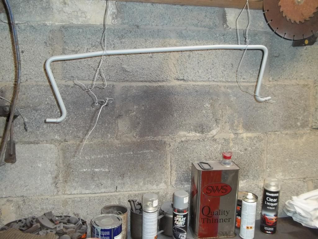

this one might upset the purest's the donor car had the rare m technic suspention option which used a 20mm front anti roll bar along with a 14.5mm rear one these were flaking so i decided to repaint them!
the color i decided to paint them is a tractor color david brown power red this is hard wearing paint so should hold up well and spruce up the appearance under neath her!

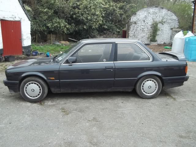

and here's a few pics of her out and about!
