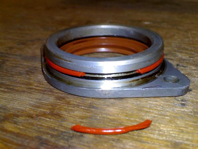

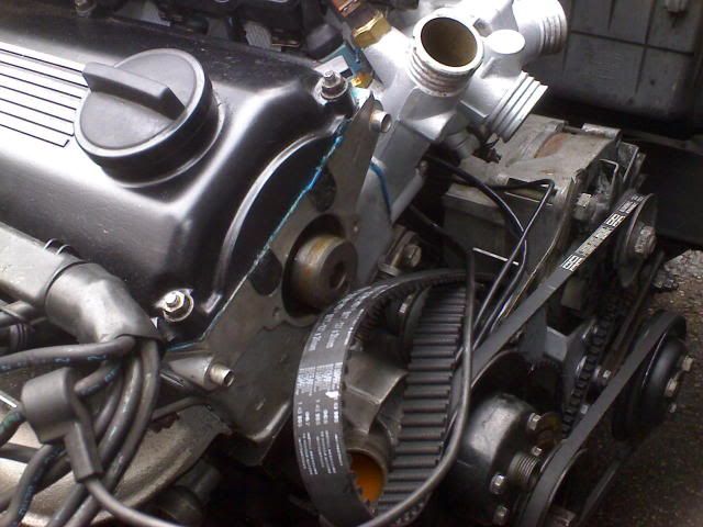

front of block stripped, revealed the cam seal letting oil out
de-greased (cam seal has now been removed, awaiting new seal when rebuilt tomorrow, half moon seals have been re-sealed with hylomar)
rear of head also seems to be leaking, i've re-sealed the half moons
