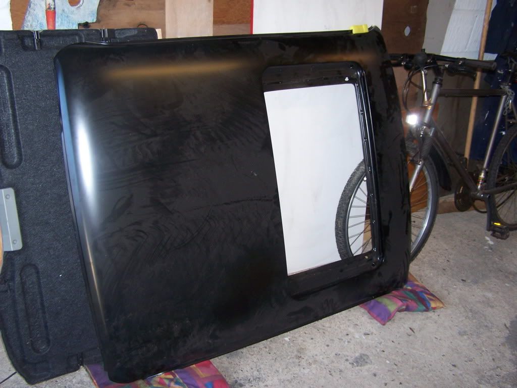

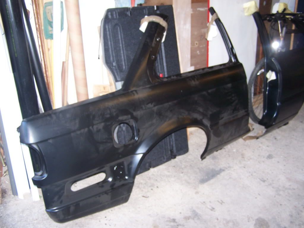

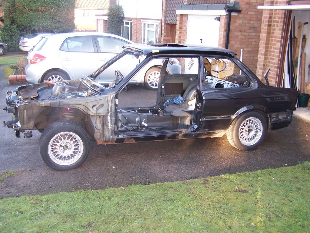

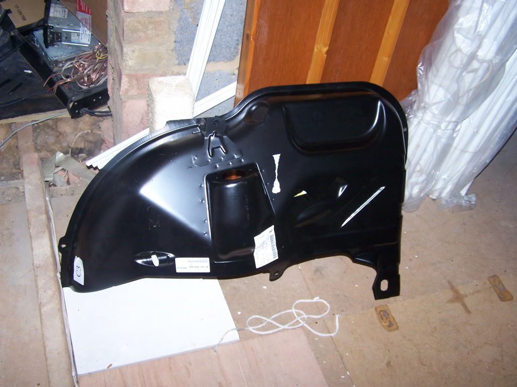

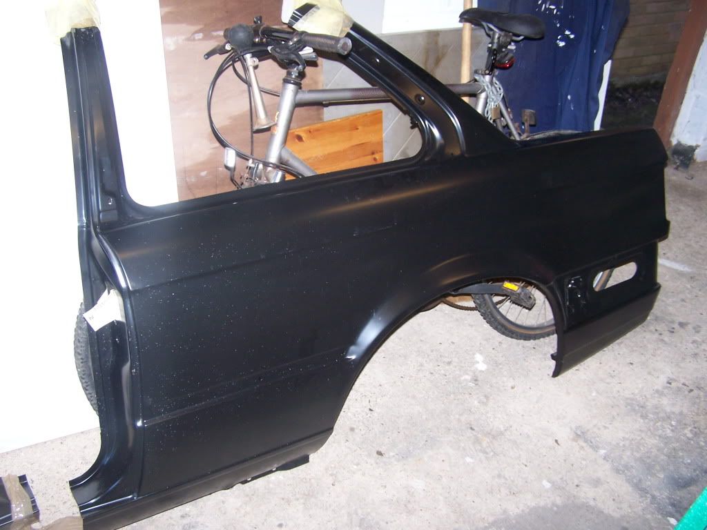

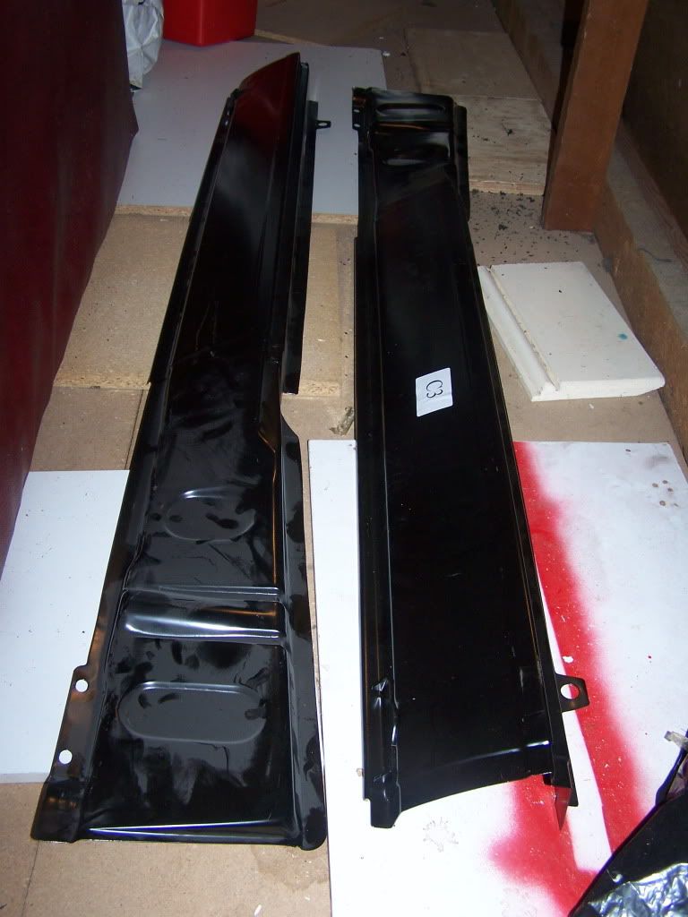

Right guys, some updating of my resto thread is in order. winkeye
After several months of doing nothing with the sport (except thinking about it), I managed to save some funds to channel into some new and replacment parts. I spent the autumn and winter months searching and colating bits that I need and I now have a huge stash of bits.
As for the car, well the engine came out during the summer....
I'm pretty much 100% clear in my head with where I want to go with this. This will be a full blown restoration and I WILL be saving this shell. I've spoken to various people about this and decided that this the way to go. What a want to gain out of this project is the satisfaction of saving my beloved E30, a car which I am very attached to I must admit. :roll:
I want a specced up, ultra clean sport that I can use on nice days and take to shows.
Anyway, this how she looks now. Still the odd loom to remove and brake assembly etc...
As you can see she is now sitting on 15' BBS. These will receive a refurb and new tyres towards the end of the project. And what is that sitting on the roof you ask?... Thats right, a brand new BMW roofskin complete with new sunroof tray bonded in. I've also acquired new BMW rear quarter panels.
More pics of parts on the way later...

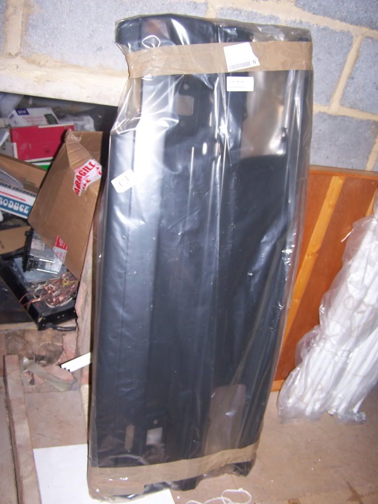

Some more new part pics. :)
New BMW sills.
New rear panel, still wrapped.
New rear turrets. I also have new rear inner arches, but these aren't pictured

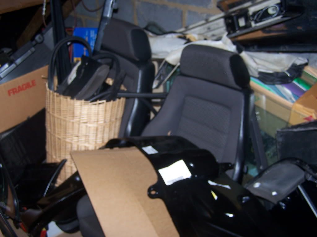

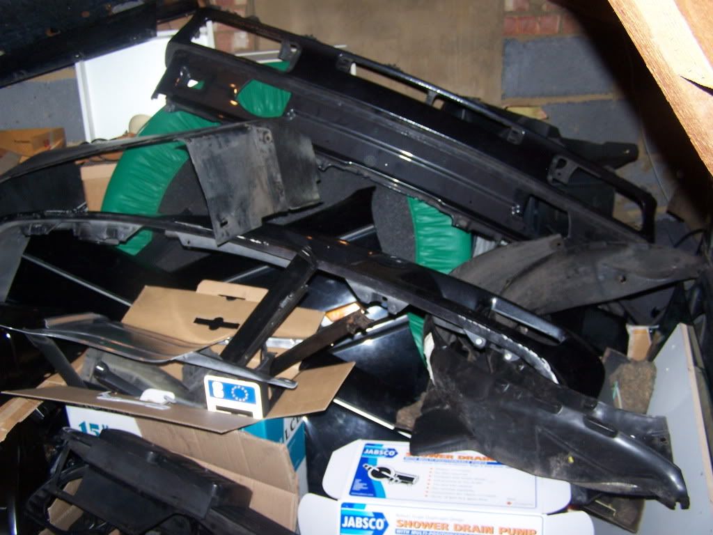

And of course my mountain of other parts, bits and pieces. I wouldn't usually store parts in this manner, but space is limited unfortunately. Note the highback recaros.

All the body panels came courtesy of C3 BMW in Crystal Palace. Good blokes and a bit cheaper than the stealers too.
