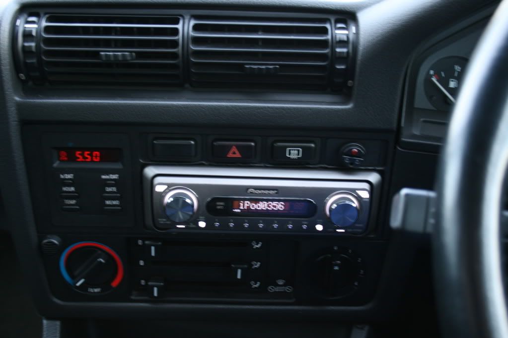

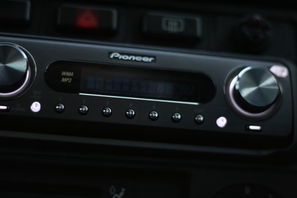

The only thing about that headunit is - I have not worked out how to turn down the brightness yet and at night the car lights up inside !!!. I just push the button for the face to flip down until I can be bothered to download a user manual and have a proper look ! LAZZZZZZZY.

This one - http://www.e30zone.net/modules.php?name ... c&t=183477
There is an option which dims the lights on the stereo when you turn your car lights on. if i remember correctly you have the ignition / engine on, turn the stereo off and press and hold function (i think!) then go through the options until you find dimmer and turn it on :thumb:
Why not come along anyway even if the car isnt ready? It should be quite a good day :D

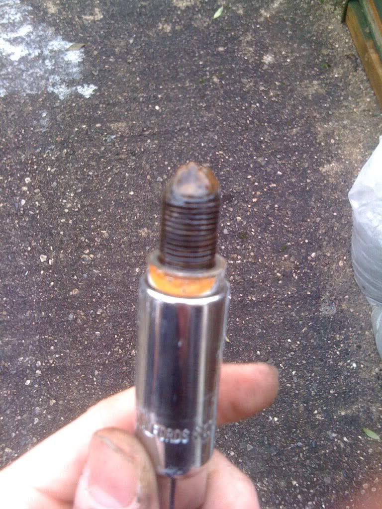

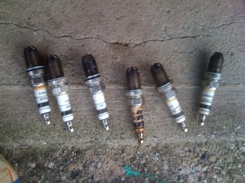

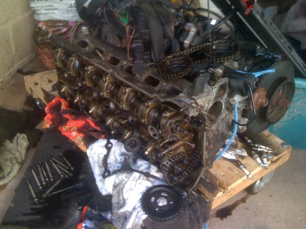

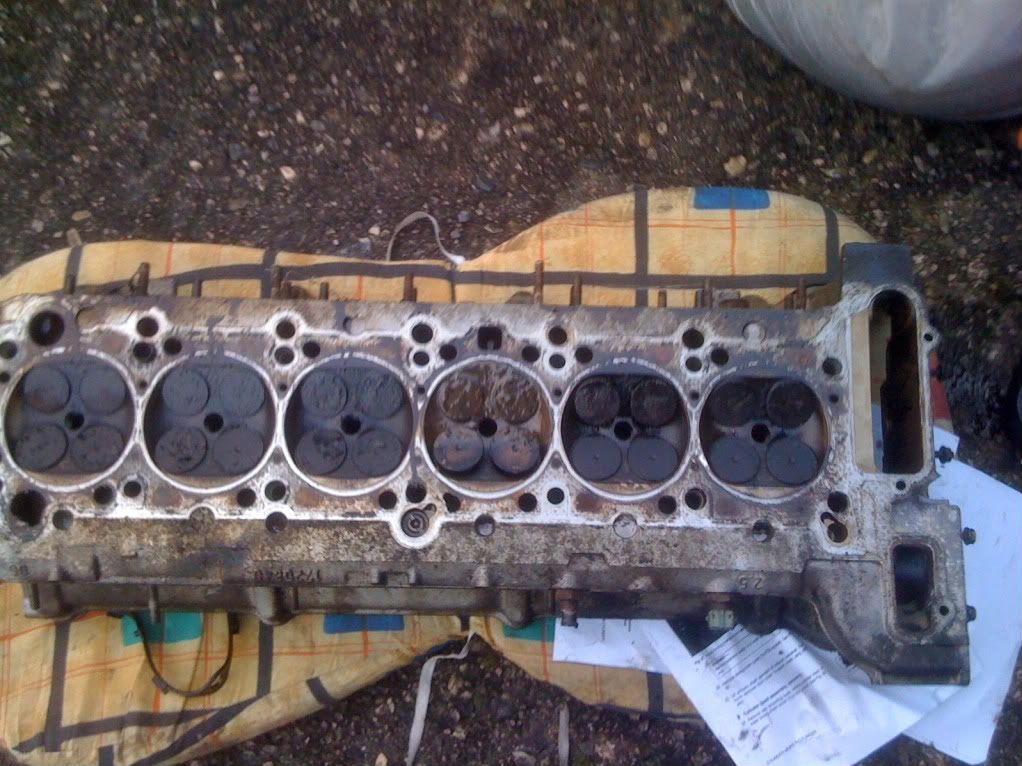

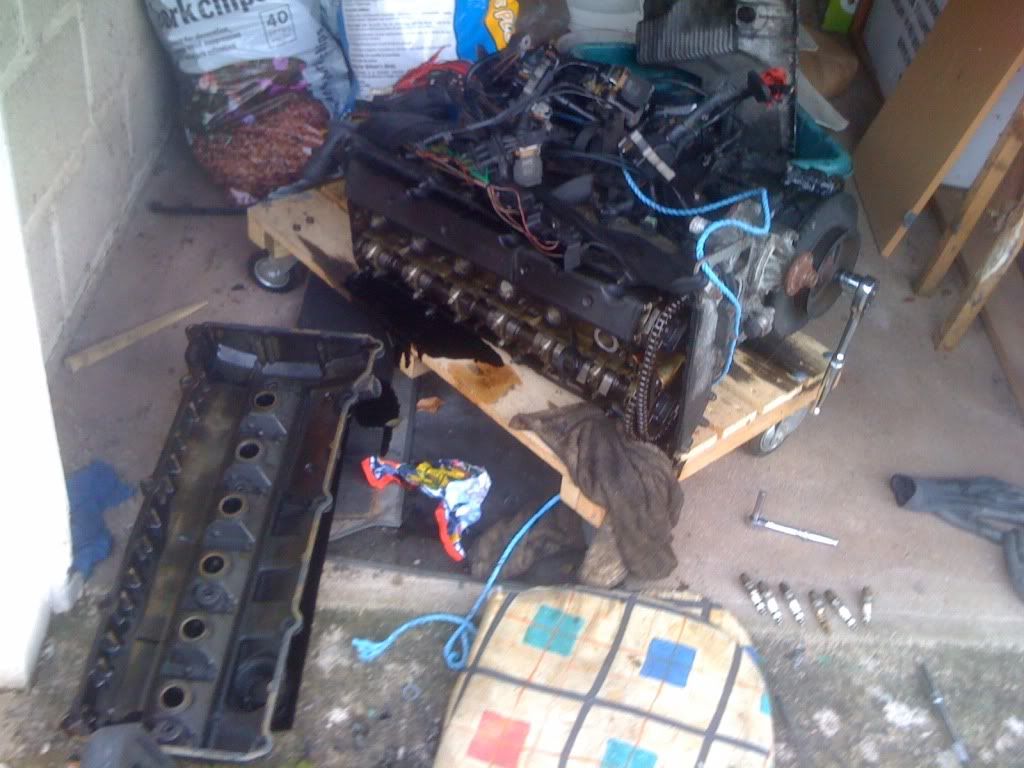

So today i've began stripping down the old m50b25. I've always wanted to strip and rebuild and engine so i may aswell make the most of it and build a 3.0/3.2 engine :D. So this is what i started with - my old m50, on its side, no sump, no oil filter housing, no alternator, no power steering pump, no exhaust and alot of the loom missing.
So there i was happily removing the coil packs and the spark plugs when i got to the third cylinder and quite a bit of water came out and i was greeted with this spark plug...
Nice :?
The were all the plugs as they came out (front of the engine on the right)
After a while i was left with this...
After a bit more spannering...
Then voila! One head off a block...

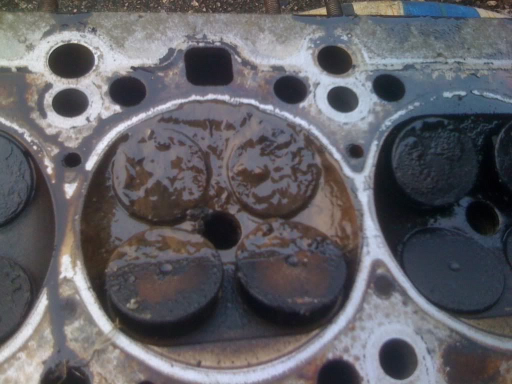

I'll give a guess which cylinder that spark plug belonged to!
I took a quick ganders at the head gasket and it looks fine, and the engine never overheated when it was in my possesion.

thats a sludgy mess in there indeed. what was the cause?
im thinking on the same lines as you with a 3.0 or 3.2 in the future.
Cook318IS
Posts: 4587
Location: Torquay
Tue Dec 21, 2010 5:16 pm
Im not sure of the cause, like i said the head gasket looked ok, but i'll have a proper look when its not so dark! I can't imagine that all of that is from moisture and surely all the other cylinders would be the same if it was from moisture.
Edit: just had a thought, it was stored outside for a while until it was moved to the garage, but it was covered up - still a possibility though i suppose.
