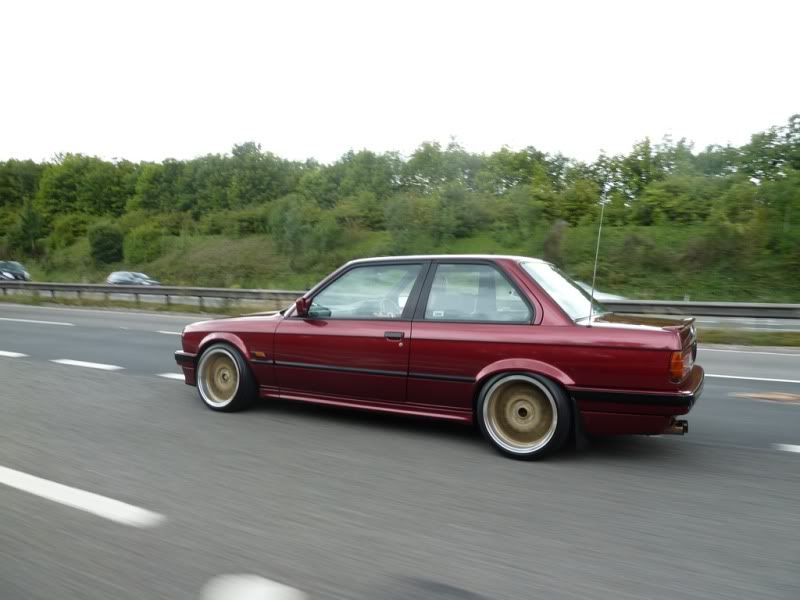

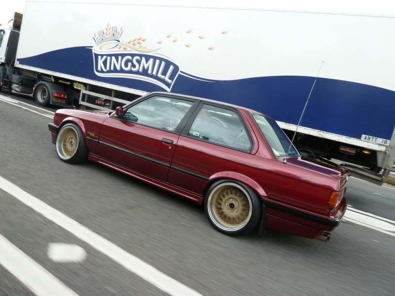

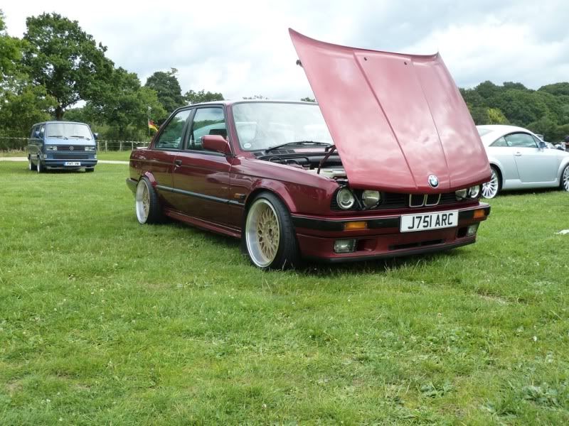

She’s on the road!
Had the E30 on the road for about 2 weeks now. Had a few small teething problems, but nothing major, just things you’d expect with doing a conversion.
Here’s a couple of photos of it looking pretty”¦.
Just needs to be a little lower at the front, which I’ll sort once I have a sump guard fitted, as the sump does sit low.
I’ll get some interior shots once I’ve properly cleaned it and some engine bay shots, once I’ve finished tidying it up and fitted my new cam cover.
I love it though, its so cool being in an E30, but having the power of an E36 M3.
One annoying thing that’s happened though, is that a small hole has appeared in the fuel tank!! Quite annoying losing £40 worth of fuel! So patched it up with some chemical metal, but new tank to be fitted this week or next.

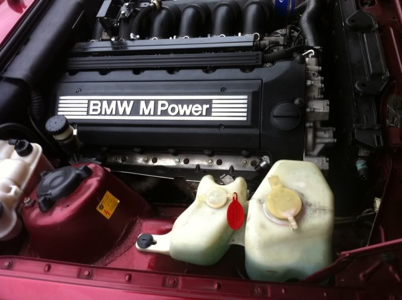

New cam cover and spark plug cover fitted yesterday along with new gaskets etc

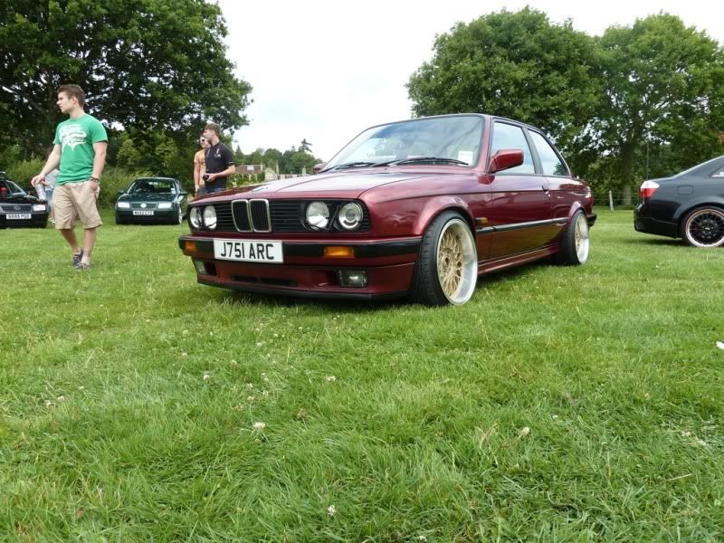

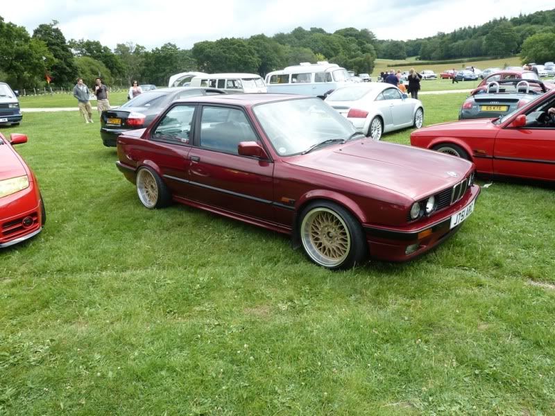

Really enjoyed the German Show, few pics of mine there;

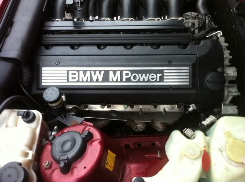

Glad to say the car is still about. Had a bit of love today:
A new bonnet badge is on order too.
