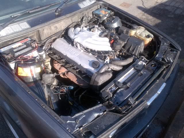

Good stuff there as always Rob, you're right though, that bay needs a damn good clean to match those shiny blasted parts!
Instagram - Kedge85
Tue Jan 31, 2012 6:42 pm
TFR and a 2" paint brush to get in all the gaps and shift the dirt/grime.

Showed the turd some daylight today :D

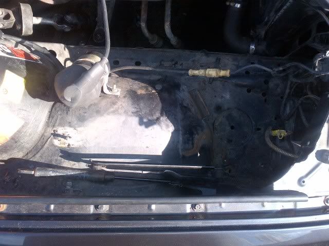

I think I'm destined to have a mucky engine bay forever :(
brushed in a load of TFR, jetwashed it - once it dried it didnt really look any different :x
Its not perfect along the seam under the washer bottle either - the usual spot - will need attending to at some point. Have painted it with waxoyl for now and put it on the list :roll:
Put the bonnet back on

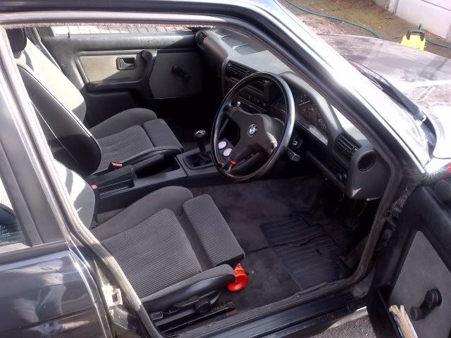

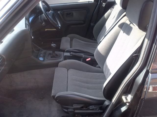

Leather cover for the gauge pod is an excellent match for the console - might tackle the wiring tomorrow - really pleased with how this looks :cool:

Interior looks cracking Rob! :cool:

Much better with some sorted seats and a proper headlining 8)

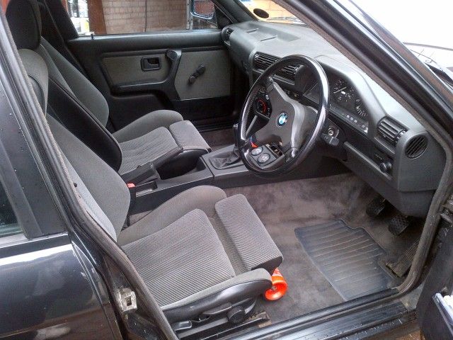

Spent most of this afternoon wiring up the VDO gauges in the console.
Cannibalised the VAG loom to use the plugs & bulb holders - actually very simple to wire up.
Did a proper job with soldered joints and heatshrink - not bad even if I do say so myself - I havent used a soldering iron since Technology at school - over 20 years ago 8O
First couple were a bit messy but cracked it after that 8)
Had to order some new instrument bulbs as 1 was blown so no pics yet until its properly in and it all lights up as it should.
Then just need to test it to see if the temp sender supplied is indeed the right one - pressure gauge seems fine and puts the light out as it should when the engine is started as well as a proper reading.
Only slightly annoying thing was having to cut the carpet under the ashtray hole to allow enough clearance for the gauges with the plugs attached :cry: Still you wont see it when its all in.
Just need to do a bit of tidying with some cable ties for the engine bay wiring and its done.
Am considering taxing it on 1st March rather than waiting til 1st April - I cant wait to drive it - just means I'll have to SORN it on 1st September rather than 1st October for the winter.
Also needs a bloody good clean inside & out :D

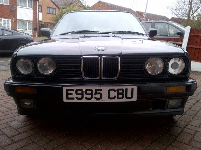

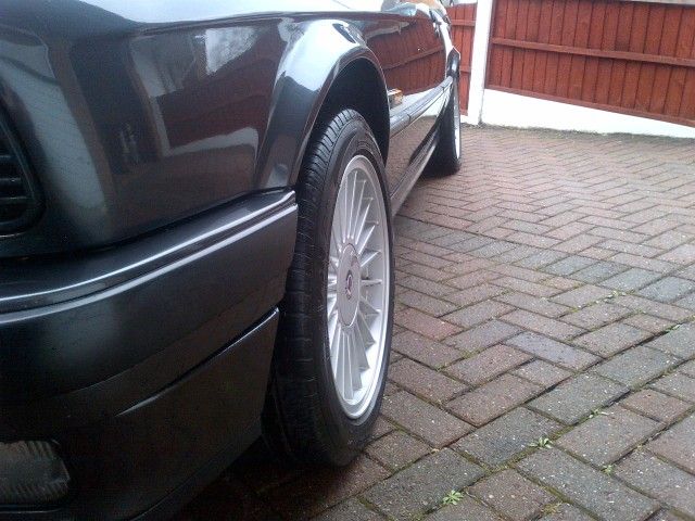

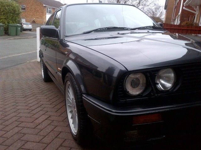

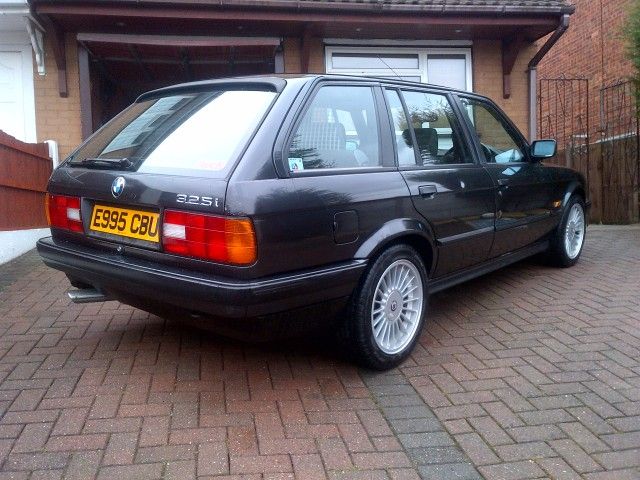

Well as the turd is now pretty much finished for 2012 anyway I've put a sponge over it today for the first time in the best part of a Year - oh and upgraded the rimzz innit :D
Love this pic 8)
Dog-proof :D
Nothing much more planned for this year - theres a few dings in the panels which I'm going to get dentmastered, another oil & filter change when I've put a few miles on it and thats about it - then paint hopefully next Year.
Bit of a change from when I first got it eh ?
Only washed it for now and leathered it off and put it away - might try and get one coat of polish on it this afternoon and take it out to get some proper pics :D
