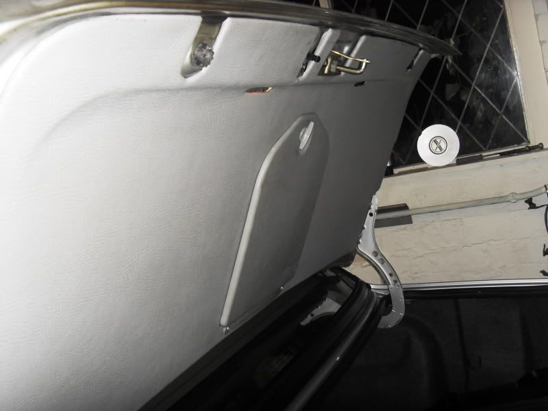

I also fitted this, something else that has been in the utility room for months ,
I think I will wire in an extra boot light in the right hand side too

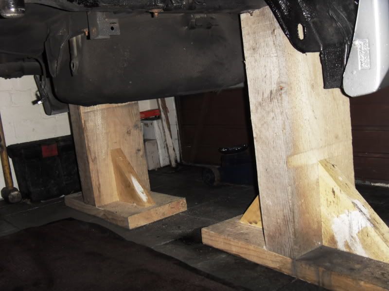

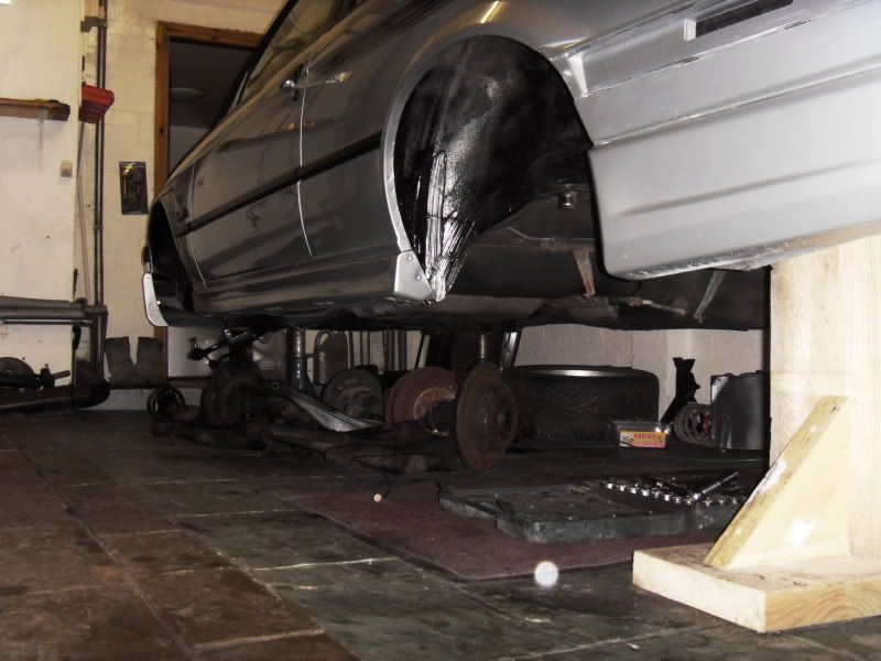

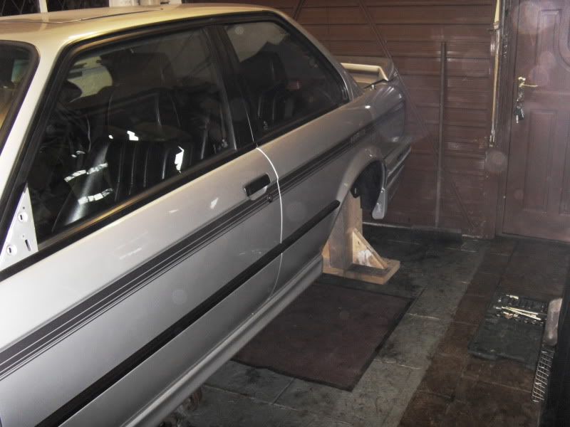

I found a way to get it off the floor without using axle stands under the sills, :D
a fellow zoner knocked these beauties up in his dinner break ! they do the job perfectly !

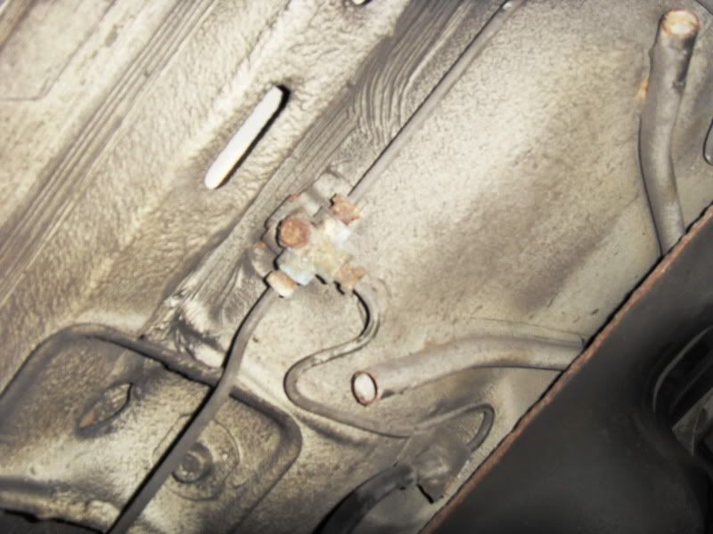

underside stripped 8O
as i suspected it is solid , no rot rust here :)
looks a bit frilly around the spring mounts,nothing serious
it seems there has been black waxoil applied at some point, :(
can't decide if i should strip it all back and apply a new coat of clear or leave it as it is , :?

Can you go over the top of it?

Royalratch wrote:Can you go over the top of it?
You wouuldnt want to go over the top of the original BMW factory applied underseal.
On mine for example there were plenty of signs of the original stuff either peeling or cracking, water gets in you can guess the rest.
Even the smallest 5mm cracks, really they are barely noticable, when cleaned back with the wire wheel in the drill revealed some impressive surface rust spread underneath the factory sealer, sometimes a much larger area had to be stripped back to get to clean metal/factory undercoat.
You can see from my pictures posted earlier how much i had to clean back, luckily Steves doent look anywhere near as bad.
Posts: 13595
Post Sat Dec 26, 2009 12:23 am
as Paul stated I really don't want to go over the top of old underseal,
but since the surface is 99% unbroken then why fix something that's not broke ? :? maybe just touch it up ?
the black underseal is dissapointing, and the history shows a bill for 'new' undersealing done in 1994 by the dealers, they obviously used black/grey instead of clear, w a nkers...
should i scrape it back to bare metal ? maybe i should have had the entire shell media blasted/dipped at the start, 8O
I don't want it concours that was never the plan,
I just want a good clean car with no nasty suprises that looks good, and drives better, I can't wait for that day .... :D

I meant new Waxoil over old waxoil / underseal.

Arrrr i see, mind the old waxoyl could be hiding some surprises then a good poke/look about underneath is a wise time investment now you can get access to see most areas.

I've had quite a strong poke about underneath and it looks solid.
I haven't gone to the same length as you guys as I wanted the car back in a few months (it's been over 6!) and don't have the time to totally dismantle but one day I would love to do what you guys are doing and to be honest a proper resto is what you guys are doing.
Will make a nice retirement project - when no parts are around anymore!

after a long poke around underneath the decision was made to leave it alone,
the factory underseal/wax oil is unbroken there is no rust present and I firmly believe in not fixing something thats not broke, so a good clean was sufficient :)

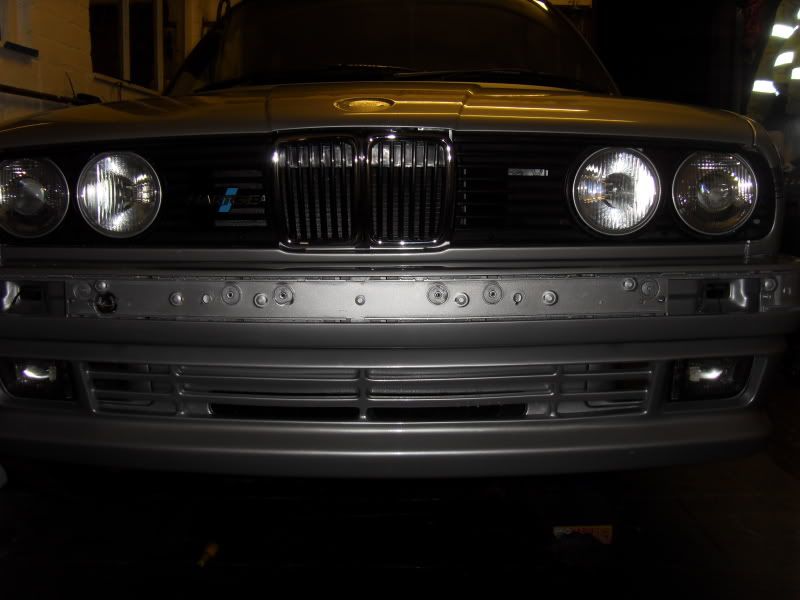

I decided against the 'mesh' on the front Hartge valance, and went with a satin 'background'
it looks sweet I love it 8) ,
oh and the badges I have are now restored that grille badge will be removed to make way for the Original font :)
