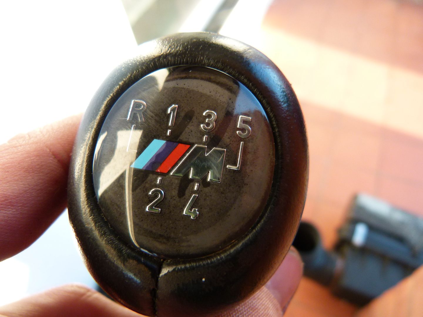

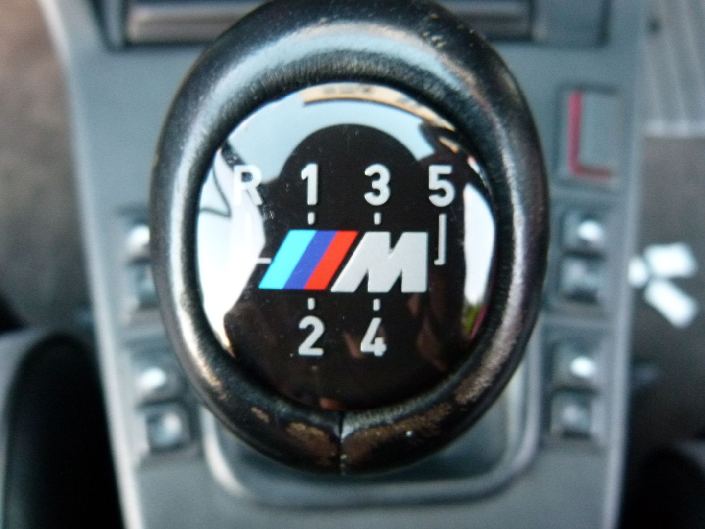

Changed the emblem on the Gearknob as i had it lying around..Planning to get another Storm motorwerks knob from my old boss as i loved the feeling of it!

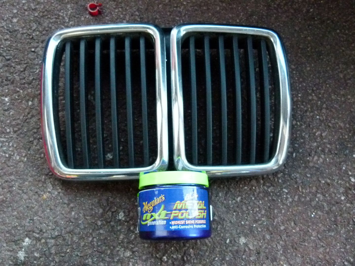

I also took your advise Lee n Rav and got myself some of the good stuff winkeye
I will be sorting the borbets out with it soon aswell :D

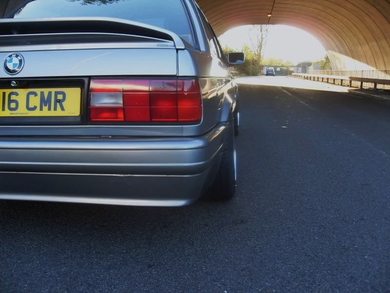

Cypriotgeeza wrote:P.s im thinking of what springs to get for the front what does everyone recommend?
You need some springs off one of these. :)
No seriously, this is M30 on H&R 60/40 springs.
I do have a pic somewhere on Eibach 40mm somewhere, ill try and find it.
