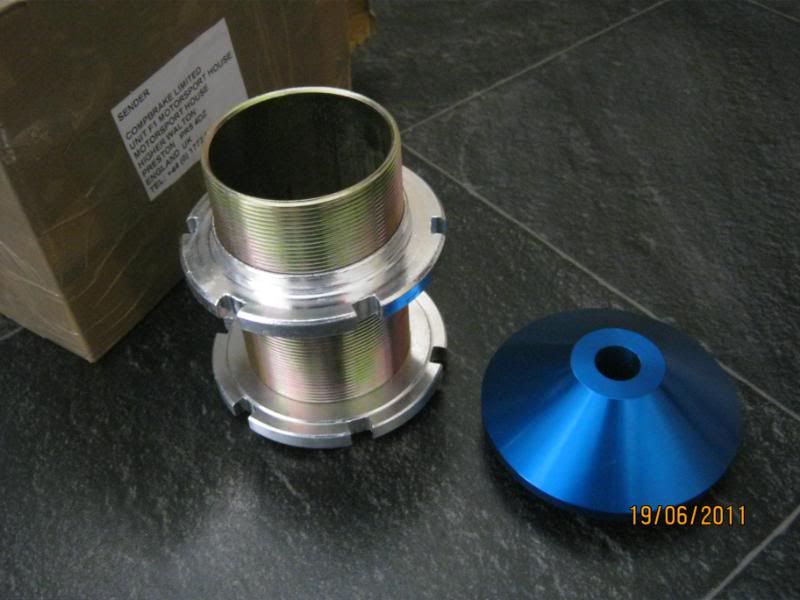

Got a pair of adjusters for the front struts from Compbrake.
Just got to order some springs from Faulkners this week then ill pass the parts onto my mate to weld up for me.

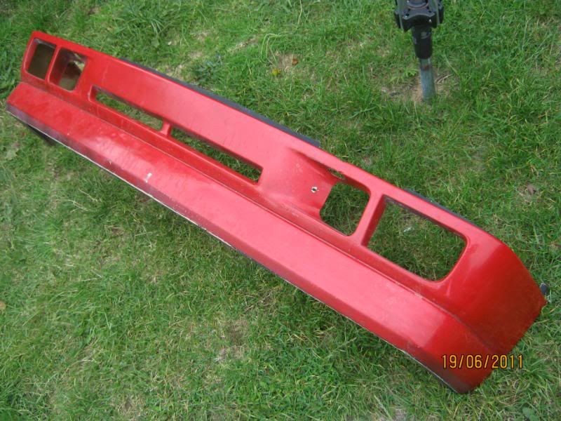

Also got the Breyton front skirt now.
its in good condition but paintwork is horrendous(and wrong colour anyway) so ill get on with rubbing that down so I can get it painted somewhere soon.

Nice one tony, you may need to bore out the centre hole on the top hat. I had to on the one I got from rally design - think 14mm.
What spring rates are you planning?
I'm using 375Ibs on the front and 550Ibs on the rear. The e30 feels pretty good for the road. Saying that, you do really need to avoid crap roads because you,know about it on badly surfaced ones.

Thanks for the tip regarding the tophat hole mate,good to be prepared :D
Are 375lb springs not a bit soft for daily driving?
Been chatting with BadDave and based on his advice id planned on around 500lb front?
Hi Tony,
I'm guessing, that the coilovers are intended for the M5X powered touring?
I currently use "tweaked" GAZ adjustable inserts with 6" long 600Lb/in springs (with some 4Lb helpers for the MOT)on the front of the touring with a good old M20 plonked under the bonnet.
The suspension is rather stiff and not ideally suited to normal daily driving.
I have previously tried 450LB and 550Lb fronts as well.
IMO 450LB are best left to those with an M40 or M42 as they are too soft for the 6 pot lumps.
If you're planning on using the car for normal day to day driving, then you'd probably be looking somewhere around the 500LB - 550LB/in rate.Maybe even go 7" long and apply preload as necessary.

To be honest it doesn't feel too soft but I'm sure you could go stiffer. However even on my springs if you get a bad section of road its pretty unpleasant.
My issue is that the car is too low (my fault, I know) and I had the sump guard hit a selection of catseyes the other day and need bigger wheels.

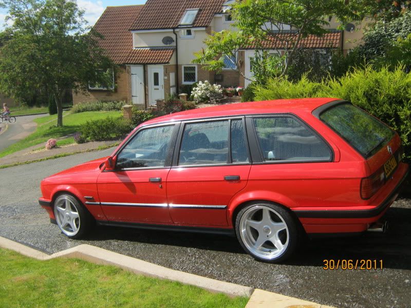

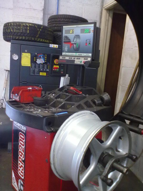

Took the wheel with the flatspot into local tyre place yesterday to see how out of shape it was.
Turns out its not actually that bad and only required a 20g weight(before attempting to remove the flatspot).
The tyre guy seemed confident he could get the flatspot out easilly using some heat and rubber hammer.
Anyway tyre removed and 10 mins later it was done.
Back on the balancer and still 20g weight needed.
Tyre back on and balanced up,job done.
Got the tracking redone while I was there which was spot on.
Ive removed the rear mudflaps too.

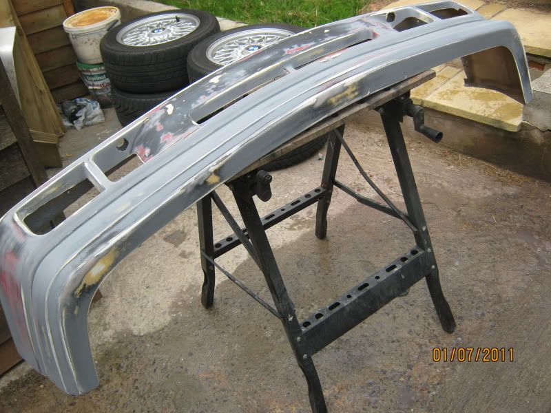

Also started getting the Breyton front spoiler ready to be painted which will hopefully be done in the next week or so.

I wouldn't have thought that a flat spot like that would give much vibration?

Wheel gives no vibration since having the flatspot removed.
Only needed a 20g weight with the flatspot and still the same without it.

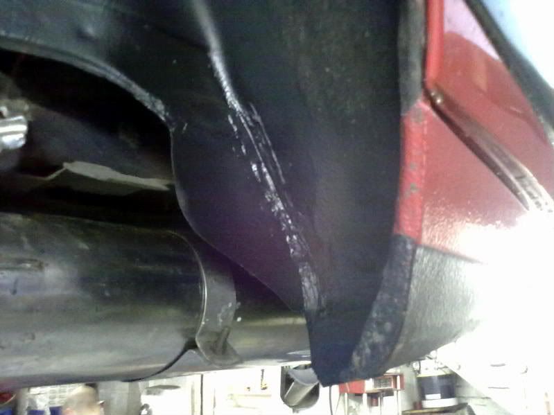

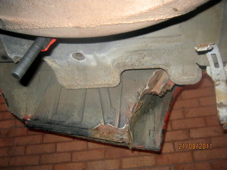

Well after removing the rear mudflaps a few weeks ago I discovered this little mess....
As its been off the road for a couple of weeks I finally got round to fitting the new rear beam....
Will get the alignment done on the way home from Monkeys garage on Saturday.

Post Sat Sep 03, 2011 11:52 pm
Had the welding done last weekend.
Rotten section chopped out and and new patched back in.
Also took it in for 4 wheel alignment during htw week,drives lovely again now.
MOT booked for this Monday so will see how it gets on :D

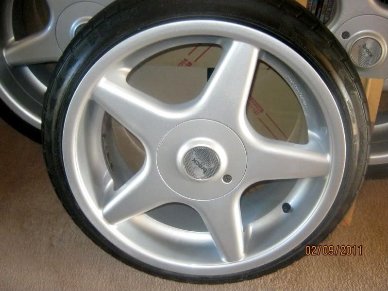

Oh and decided to get a cheap refurb on the Brocks as a couple of them had kerbing and the polished rims were pretty heaavilly scratched.
These will be sold with/after the car is sold so did need doing really.
