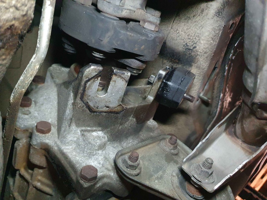

Then onto the transmission mounts - again this is a pretty straightforward job however access to the mounts (especially the top bolts) is super awkward as the exhaust and heat shield get in the way. After a while I undid all the botls to the heat shield and was able to slide it back just enough to get access.
I had to use 3 or 4 different spanners to find one that fit just right, a load of WD-40 to loosen everything up a bit and have bruised my palms trying to get enough force to break the bolts free. However, eventually they came off...
As you can see there is about a 5mm difference between the old and new mounts, not loads but perhaps enough to put my drivetrain out of line and cause a clunk.
I had removed the mounting bracket (as advised) as well so refitted, aligned and torqued everything back up with new hardware. After that I finally took the car of the stands, had one final check and then took it for an easy drive to the shops... and NO CLUNK!

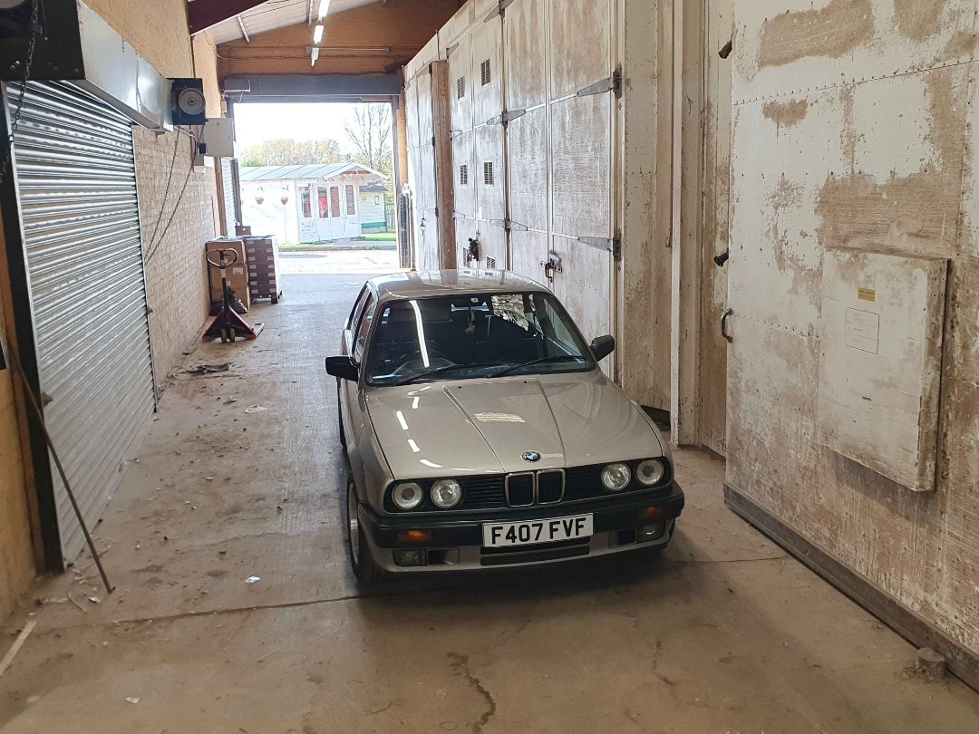

Such a satisfying end to a couple days of hard but enjoyable work. Here she is sitting pretty in the warehouse...
1988 320i Coupe - a newbies experience!
