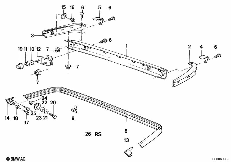

Update with some pics from the rear bumper refit.
Quick and easy job when the bumper is straight.
Firstly, the diagram in Real OEM shows different fixing arrangements for the bumper end caps.
Plus it's not really clear.
Plastic end cap is attached to the bumper by 2x phillips head screws per side (#25).
The diagram shows a hex head.
The bumper end cap shows two options:
A) A hex head screw & short rubber hose as a seal (#17 & #18)
B) A hex net, spacer, rubber washer , flat washer and hex bolt (#24, 23, 22, 21 & 20)
Mine had neither.
Just a simple hex head screw and speed nut clipped into the bumper end cap.
Note the different length screws.
Left = shorter = screwed through the quarter panel from inside the boot.
Right = longer = screwed through the rear section of the wheel arch

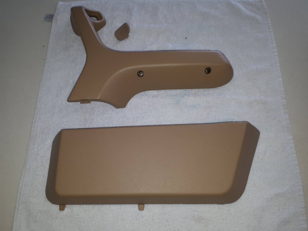

While I waiting for the compressor fittings and hoses to arrive, I gave the door cards and rubbers a refresh.
My existing door cards were pretty tired, warped and the vinyl was torn in a few places.
Plus the handles, door pocket and trim didn't match.
Found a set of door cards that were in great shape - the vinyl was nice.
But the back of the door cards were a different story, cracks and the holes for the door clips were blown-out.
Challenge accepted.
Carefully peeled back the old vinyl and inserted some baking paper between the card and padded vinyl.
Some moisture, steam and let dry with everything clamped straight.
After the card was straight and dry, brushed on some fibreglass resin (sans glass).
That soaked into the cardboard to stiffen things up. Also brushed in some fibreglass matting to help repair the cracked card.
Leave the baking paper in between so resin doesn't soak through the holes in the door card and form sticky / lumps to the padded vinyl.
Once that has hardened, remove the baking paper, applied contact cement, shallow staples and it was good to go.

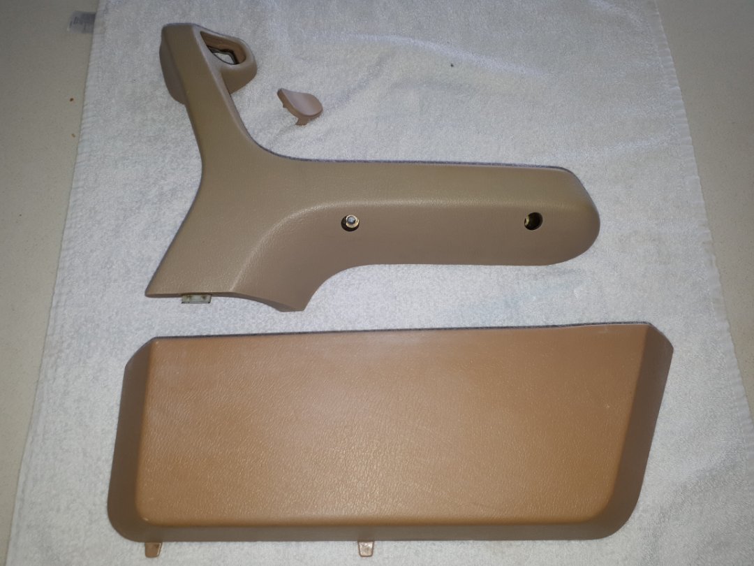

Refinished the vinyl, handle and map pocket with my favourite Duplicolor Medium beige paint.
Mentioned before Duplicolor medium beige is a close match to Natur.
But slightly more 'browny' whereas Natur has that slight 'pinkiness' to it.
Some pics to show the colour difference.
(faded Natur at the front and medium beige refinished card at the back)
Also some new internal window rubbers to set it off and help reduce window rattles.
Now I have to do the other 3 cards to match :)

Some nice weather and annual leave - no better time to refresh the rear door cards.
After refinishing the front door cards, the rear section looked a bit shabby.
Plus the speaker covers had faded and didn't match the surrounding trim.
Out came the back seat, cards and demister trim strip along the back of the seat.
(sorry for the colour balance on the photo)
While everything was out, was also a good time to:
- spray some penetrol into the nooks and crannies to help prevent rust
- re-wrap any wiring looms that were tired
- blow-out the demister (was smelling crusty when I used it a few weeks ago)
- lubricate the window regulators with lithium grease
- clean down the original bitumen sound deadening & give it a quick clearcoat to help repel dirt & dust
The rear cards were squeaking and rattling, so added some felt tape to keep any contact points quiet.
As usual the most labour intensive part was the preparation.
Strip off the rubbers & trim...
Glue down any wayward vinyl...
Scuff with a gentle Scotch Brite pad and diluted cloudy ammonia to clean-off ingrained dirt & grime...
Wipe with wax & grease remover followed by a clean lint-free rag...
Mask-up...
Then finally a few light coats of Duplicolor Medium beige.
You can see the difference in the speaker covers - RH is unpainted & LH is Medium Beige.
Both done!
Some more Tesa self adhesive cloth tape to stop squeaks.
But also to reinforce the vinyl that tucks under the door weather seal.
Part of the vinyl had torn.
In they go...
With a solid 'thunk' as the door cards are seated in the correct position.
Colour will lighten up as the vinyl paint fully cures.
There are a few indentations from a previous repair job - still there but less obvious.
I'll overlook those as I don't really want to re-skin cards ($$$).
Clean, sharp lines again :)
Eventually when the leather seats need a re-trim, I'll get the seat backs re-covered in the same material.
I'll also do the seat backs in medium beige.
Oh yes, and the horse shoe also got a quick re-colour to match.
