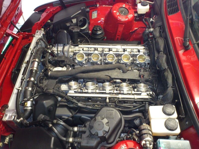

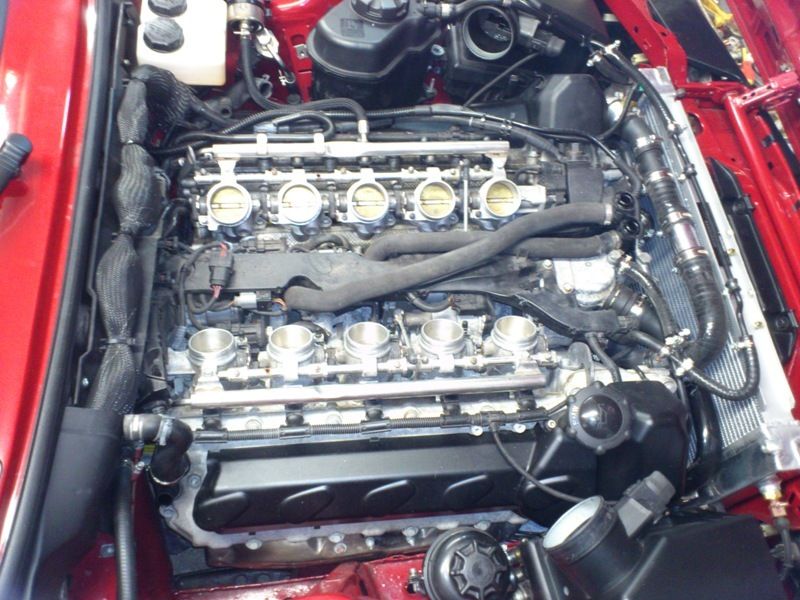

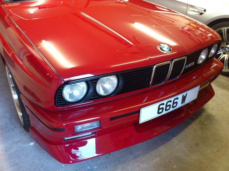

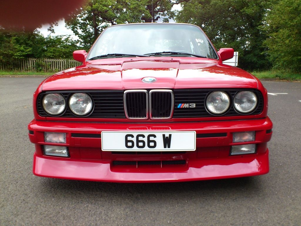

I have brought an evo 2 spoiler off a zoner (thanks Jim ) and painted it myself. I have had a bit of a struggle getting the colour right and ran out of paint tinter and painting skills after 3 repaints, I am going to leave it on for now and get it professionally painted over the winter.
I have also rewrapped the under bonnet wiring and removed the redundant s14 wiring.
The M5 oil cooler was looking a bit vulnerable, I have fitted some mesh inside the vent. it looks like the are clips to fit something here, I cant see anything on realoem, does anybody know if there is a proper mesh for the lower vent ?
A few pics, excuse the thumb on the frontal shot, my photography skills match my painting skills :D

No mesh on the front bumper vent but there is meant to guide which fits the full width of the bottom vent.
glenn
Engine Transplant Services
Posts: 2196
Post Sun Sep 13, 2015 7:14 pm
I've just been out to the garage keith, and found the guide as barry has said. I removed it as it wouldn't fit with the e60 oil cooler. there's no mesh on it, it looks similar to a 325i oil cooler grill. I can pop it in the post to you this week if you like keith ?

Looks much better with the EVO 2 lip
This Car just seems to be getting better and better :D

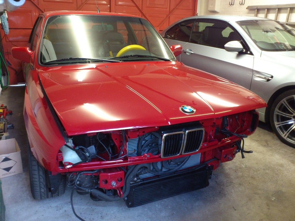

I have been doing a few bits and pieces to the car, first I ordered this from Americaland ;
It is an external temperature sensor for the 13 button obc I have fitted, it cost £20 delivered with a 10 year guarantee. I thought about where to fit it and eventually put it in the grill next to the headlight.
It seems to work fine, I initially thought it might read incorrectly with the air blasting past it.
I have brought a pair of inlet plenums as the ones on it were a bit singed but worked fine. (the original engine come out of a fire damaged car )
Note the temporary fuel filter by the brake fluid reservoirs which I fitted after the blocked injector problem. I believe the crap in the injector came from internal rust on the steel front to back fuel line. I have brought a new fuel line (£42 from BMW ) and plan to fit it over the winter.

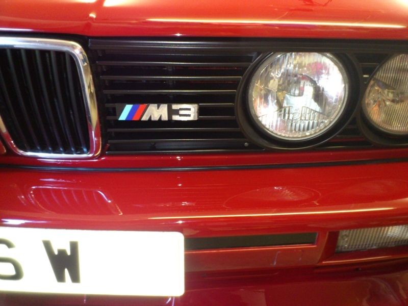

The front badge was looking a bit worse for wear;
I rubbed the aluminium m and 3 down with wet or dry and metal polished them, I brought some vinyl strips in the m colours and cut them to size and lacquered them.
I noticed that the light grills have lots of blanks between the slats, presumably to keep the rain out. I set about it with a dremel as the air boxes are directly behind the headlights. I hope to reduce the intake air temperature by doing this.
You can just see the external temp sensor next to the headlight In between the bottom 2 slats.
I have machine polished the car ready for Santa Pod tomorrow, Just a few shots of it in the garage;

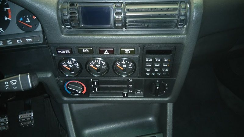

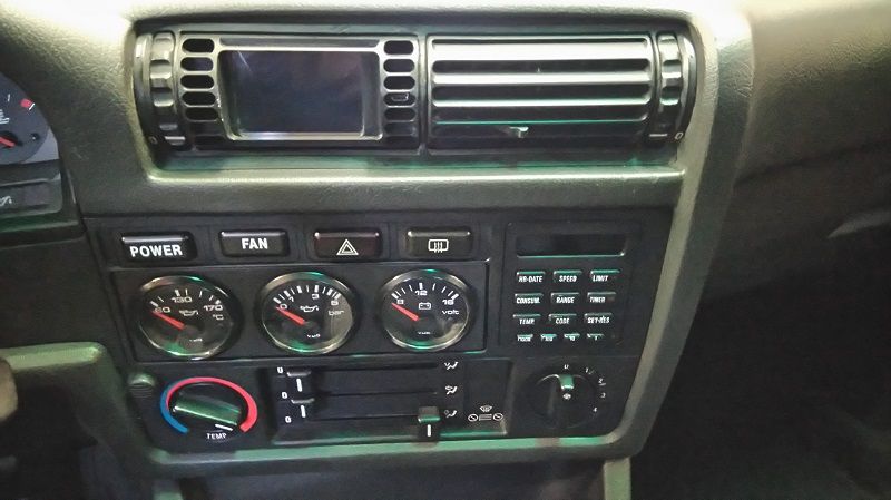

I haven't done much to the car lately apart from changing the steering rack gaiters.
I have been collecting parts for when I strip out and refurb the rear beam over the winter, I plan on powdercoating / painting the rear beam and arms, powerflex bushes and black diamond hoses with new brake and fuel lines.

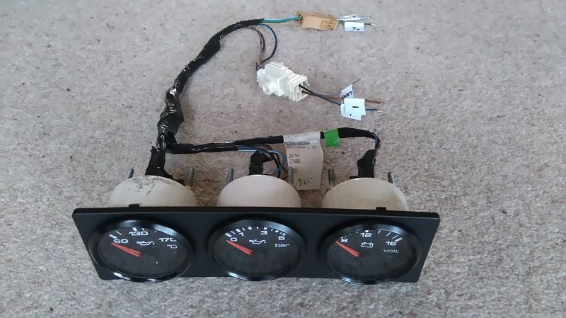

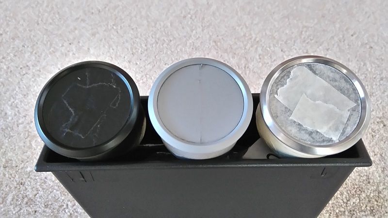

I have fitted a set of gauges from an Audi, I chose these because they have the same font as the e30, light up orange and have red needles like the M3.
When I got them the bezels were a bit scabby;
(photo aspect gone a bit egg shaped ! )
First I polished the plastic 'glass' with rubbing compound to remove scratches and then I stripped off the paint with a scuff pad (came off easy as the paint was thin) followed by satin black paint.
I picked the Audi loom apart, removed the relay and separated the lamp earths so I could connect them via the e30 dimmer system.
I chose to fit them in the stereo position as I haven't got a stereo because the car is too loud to hear one !
The fascia plate I used was an old genuine BMW one which I found in my garage, probably out of one of my old e30's from a few decades ago.
I discovered the gauge write up in the wiki after I had finished, one discrepancy I found was the vdo pressure gauge sender, it quotes the American part number (360-007 ) not the u.k. one which is; 360-081-030-006c. the spec for the v10 is m12 x 1.5 thread 0-5 bar, 10 to 180 ohms, two post sender with warning contact.
The temperature sender was correct in the wiki, I brought a Meyle one for £6 part no. MEY1008100004
My car used a positive to feed the low oil pressure warning light, because I used sender with a built in negative switch for low oil pressure I had to convert my dash oil warning light to suit.
As my vent gauge already reads engine oil temp I plan to install a sender in the rear diff. I have the M3 tachometer oil temp gauge connected to my gearbox, this normally runs at about 50 degrees c.
As the oil temp gauge does not start till 60 degrees c I may fit a sensor which over reads so I can establish a 'normal' but false reading for the diff temp.

For cross reference purposes the genuine Audi part number for the oil temp sensor is;
AUDI 049 919 563 B (049919563B)
I think it is about £20 from an Audi dealer.
The one I brought;
http://www.ebay.co.uk/itm/191313234782? ... EBIDX%3AIT
I tested the Meyle one by connecting it to the gauge and dropping the sensor end in boiling water, it read exactly 100 degrees c
VDO's agent in the u.k. are based in Birmingham, they have a technical helpline on 0121 326 1271.
